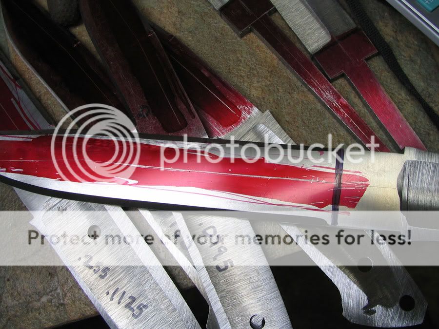

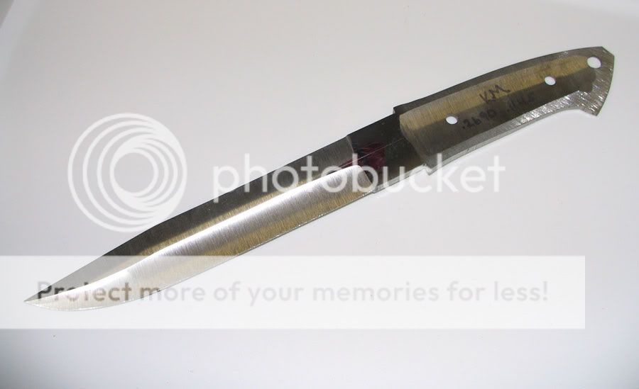

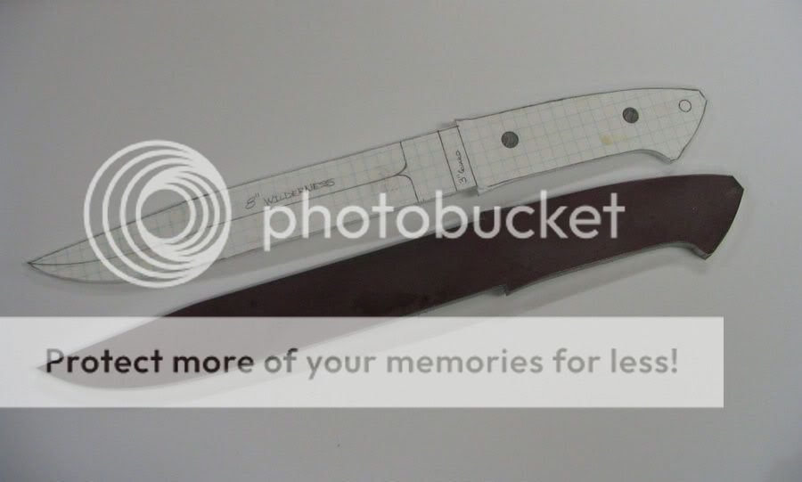

Here is the pattern we agreed on, and the blade blank. 8" blade a little over 1 1/4" wide at the guard and 13 1/2" OAL, blade steel is 1/4" CPM-154

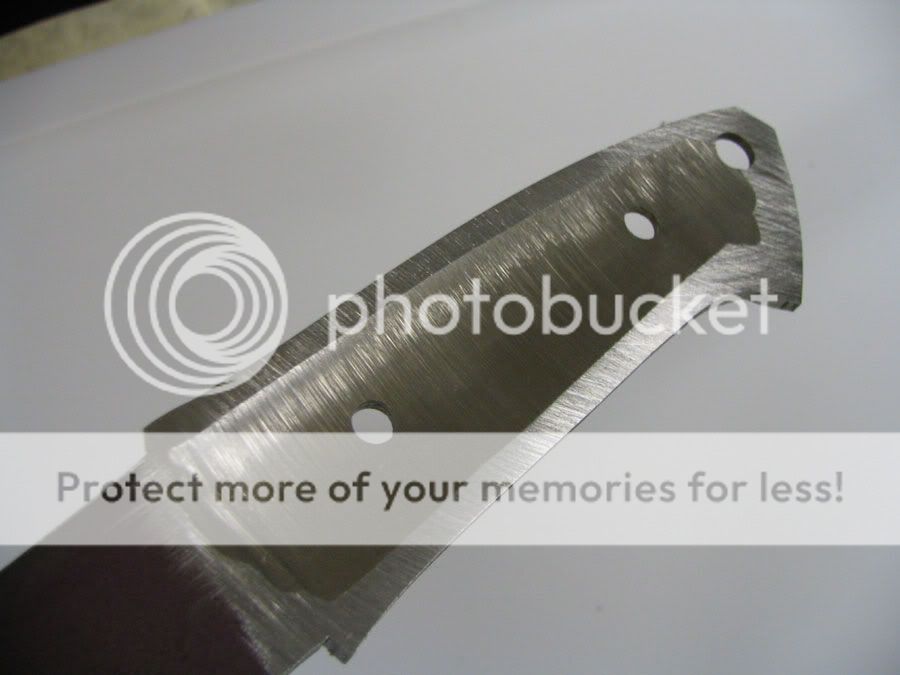

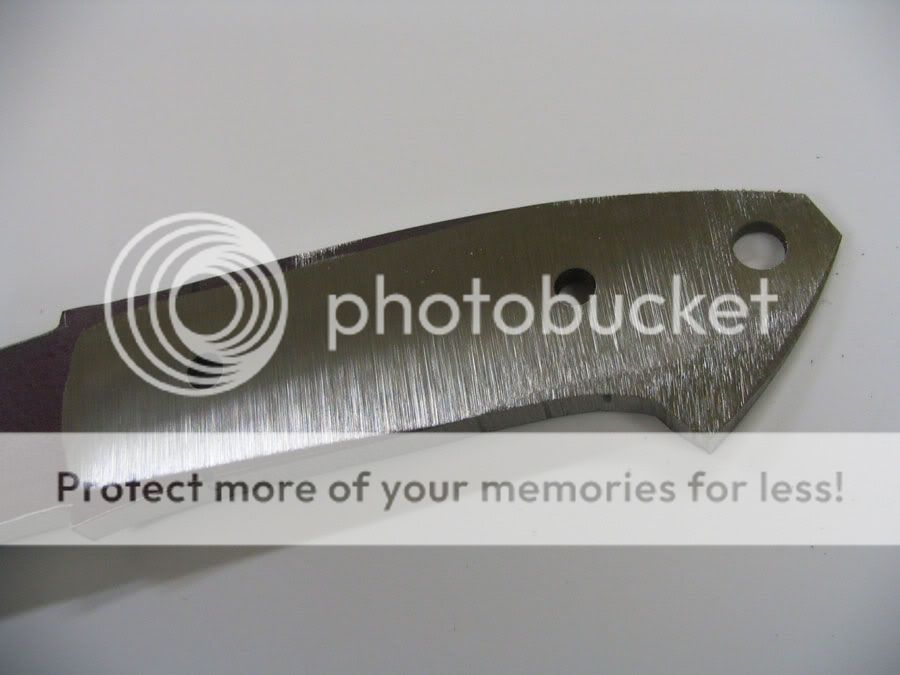

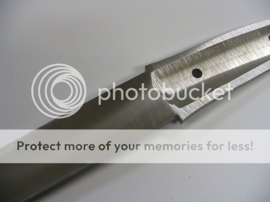

Holes drilled in tang for bolts and we decided to use a 5/16" thong tube.
Using a 8" wheel to take some meat off the tang to make tapering a little easier.
Tapering the tang.

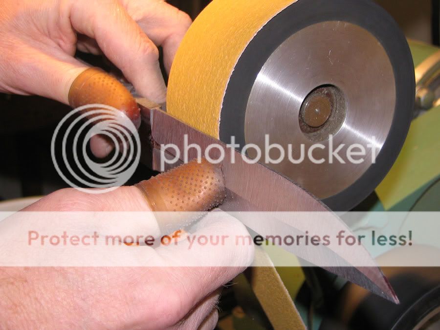

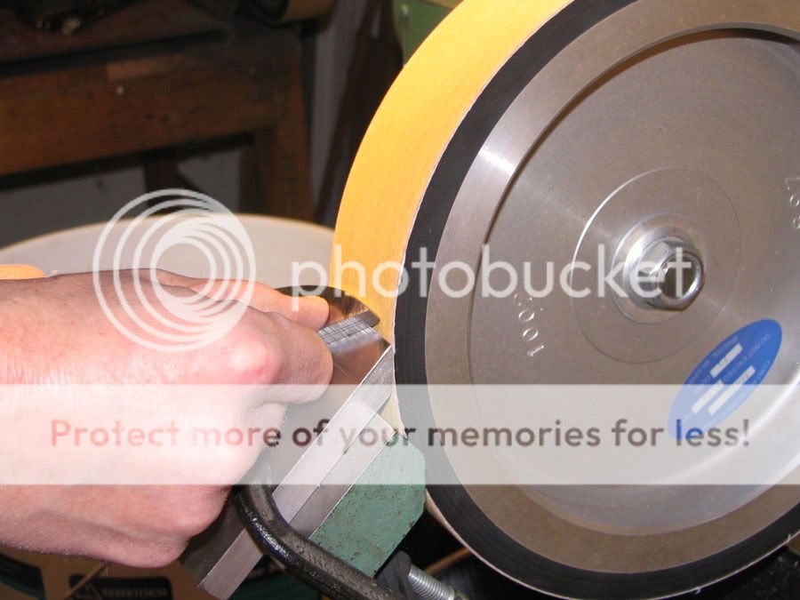

Using a 4 1/2" wheel I take some more material from the center of the tang.

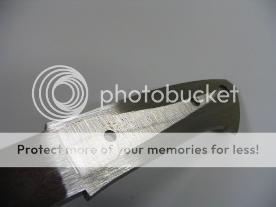

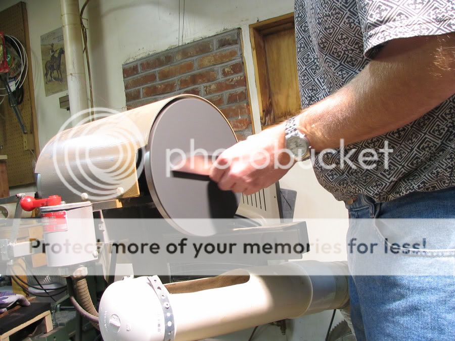

Using the disk to true up the taper.
Tapering the tang.
