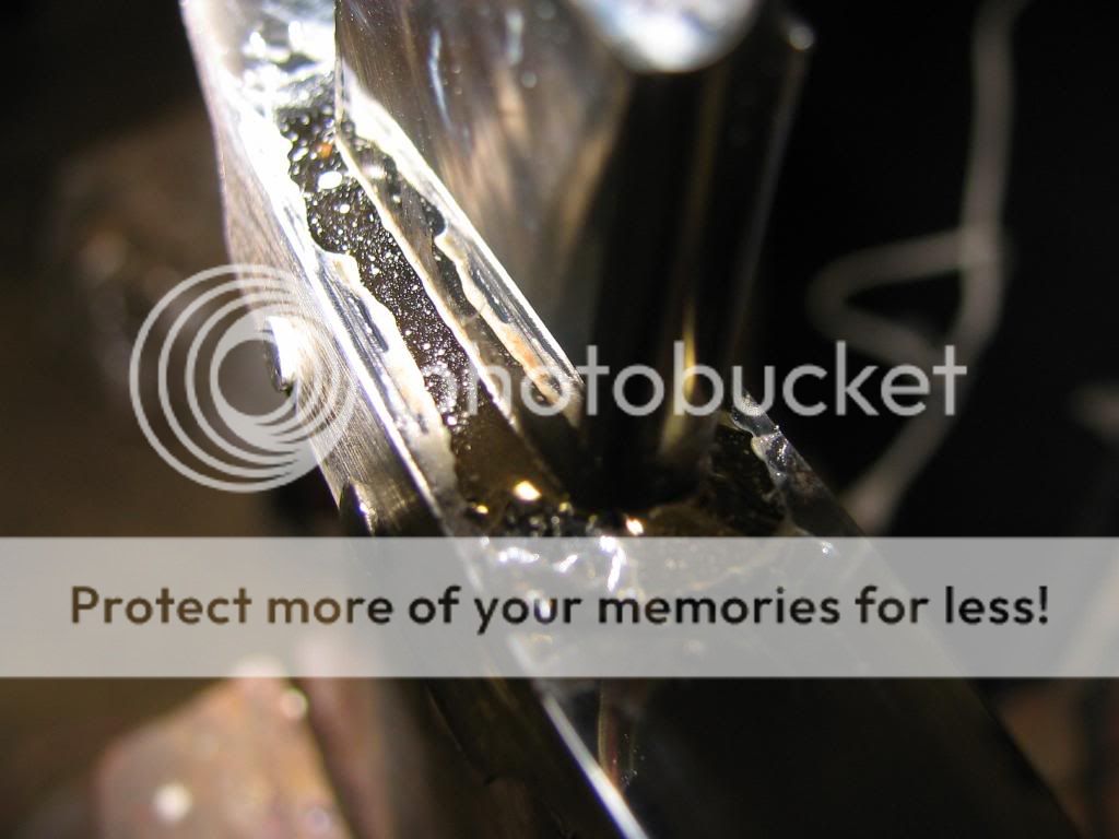

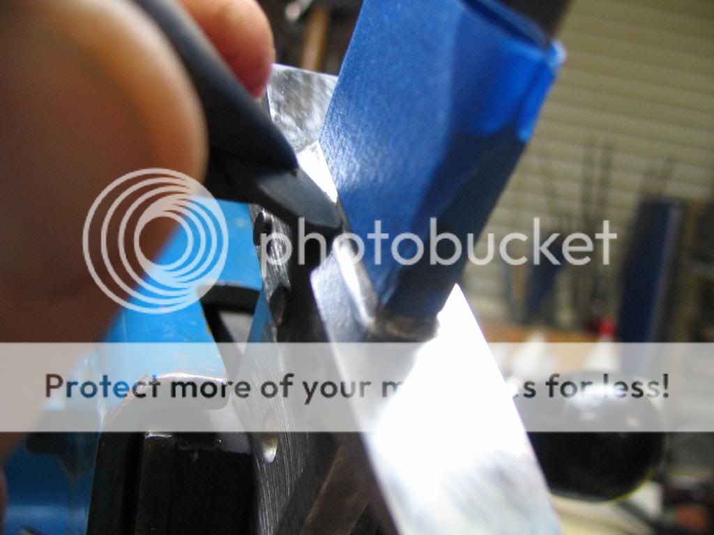

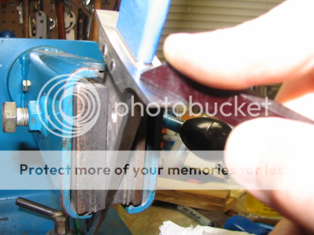

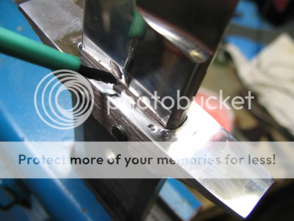

Now it's time to solder the guard.

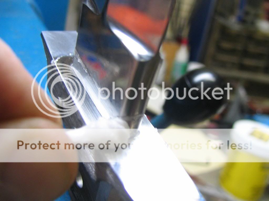

For best results it is important to clean the guard blade juncture well.
I use acetone and Fast Orange Hand Cleaner.
Brushing on the flux.
Heating up the joint with a heatgun.

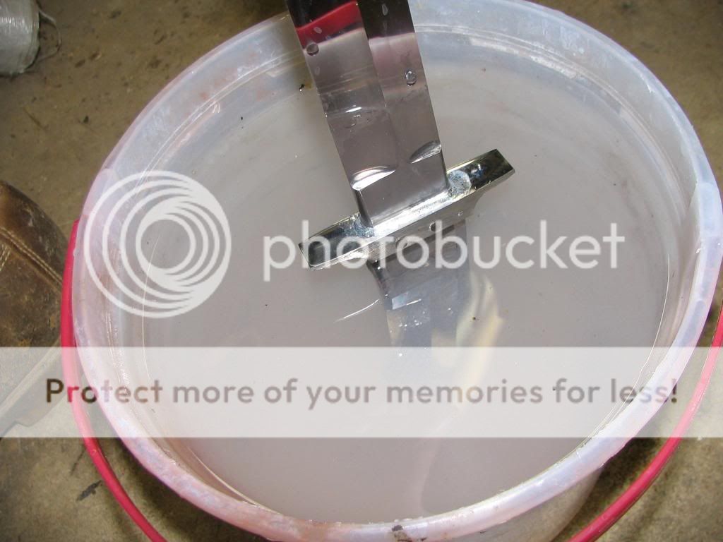

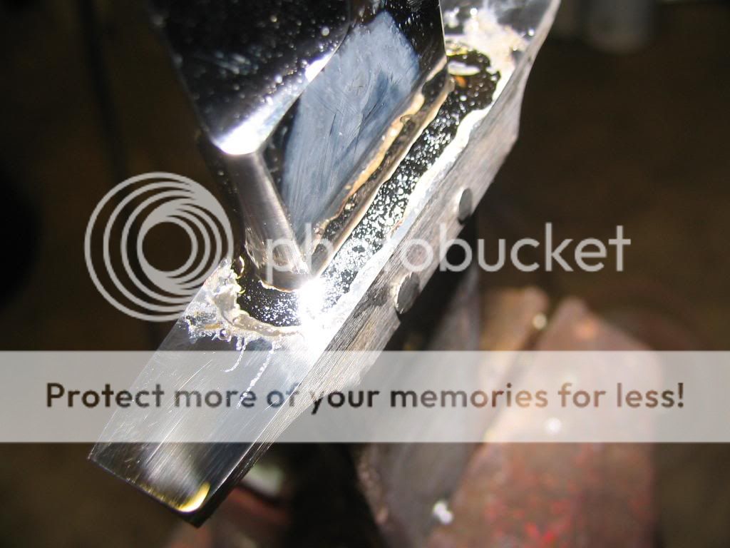

After a little work we have a good flow of solder around the tang.

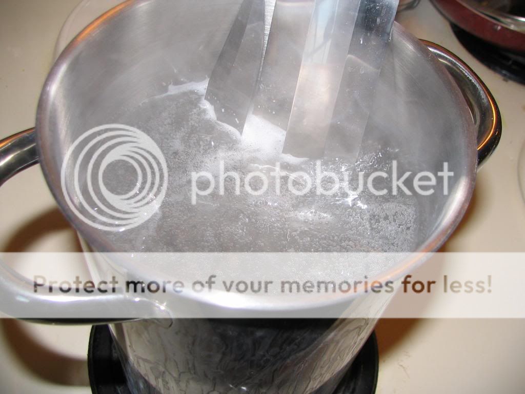

Cooling the knife in water with TSP added, to start neutralizing the flux.
Boiling the knife in water, baking soda and dishwashing liquid. This step will also help neutralize the flux.
The last step in flux neutralization knives are placed in an ultrasonic cleaner with the water from the boiling step.

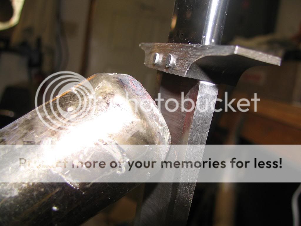

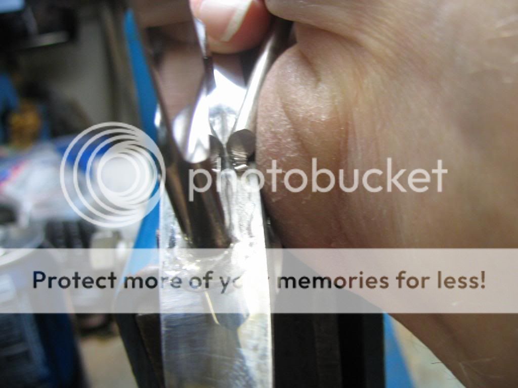

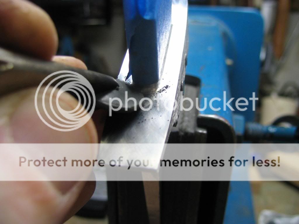

First step in cleaning up the solder joint is to use a graver made from a 1/4" nickel silver rod.
Cleaning up the front of the guard with 1000 grit paper.
Using a Cratex wheel held in a small pair of Vise-Grips to smooth up the solder joint.

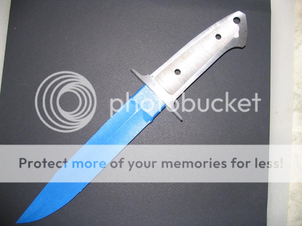

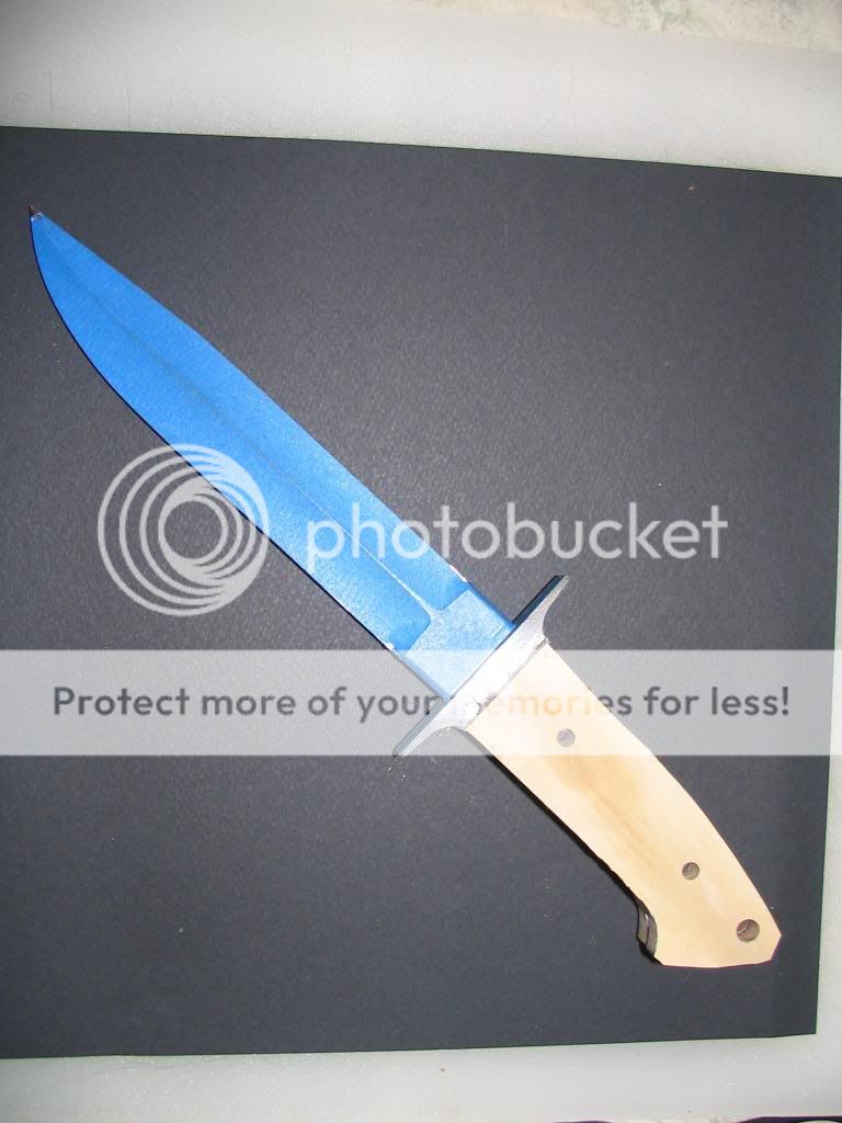

Blade taped up and ready for the handle scales.

What's the average total time for completing a good solder joint?

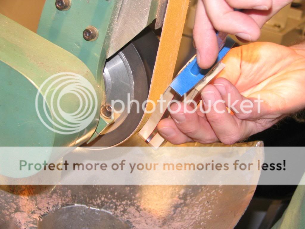

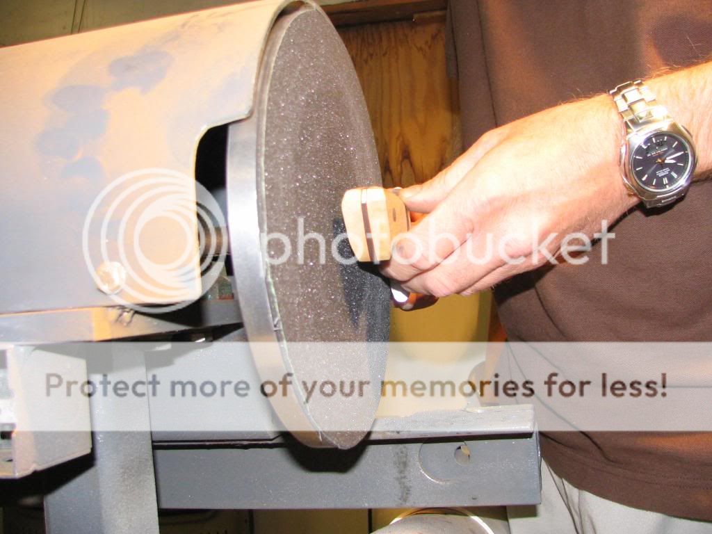

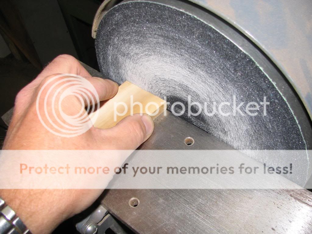

First step is to make sure the side that goes against the tang is flat.
A 60 grit disk work well for this step.

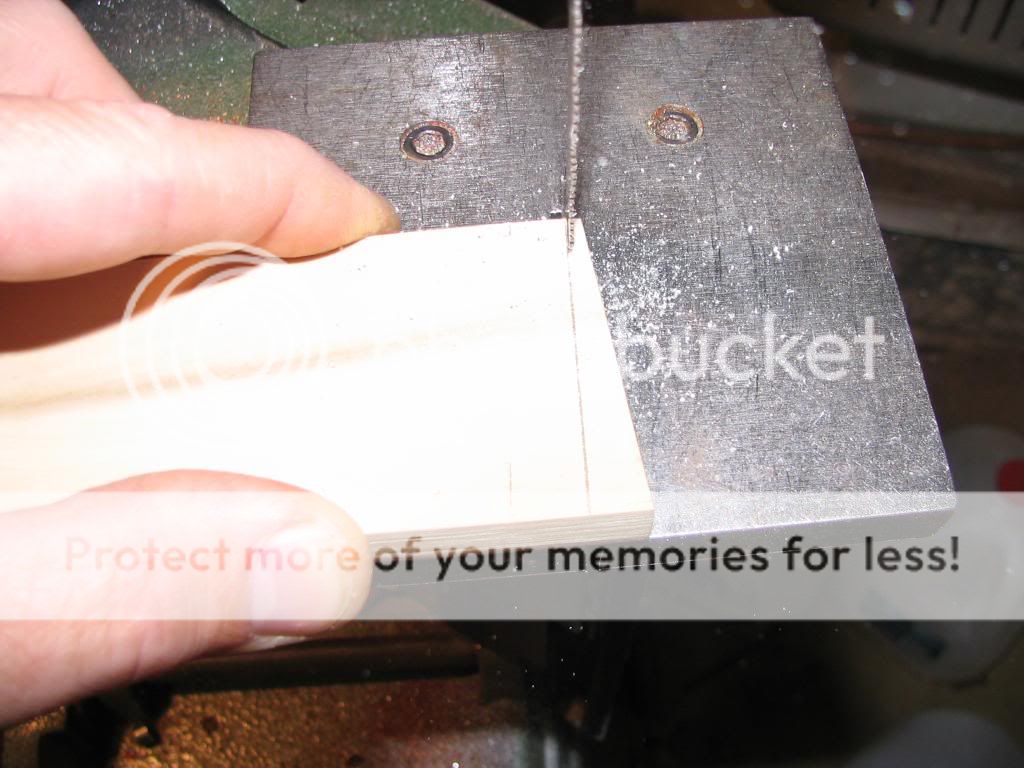

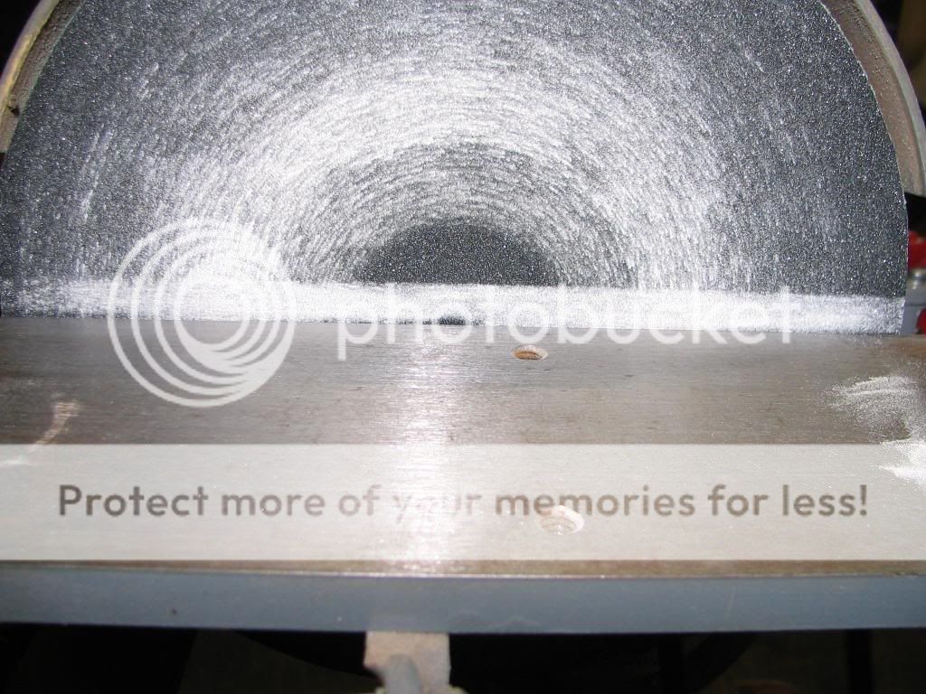

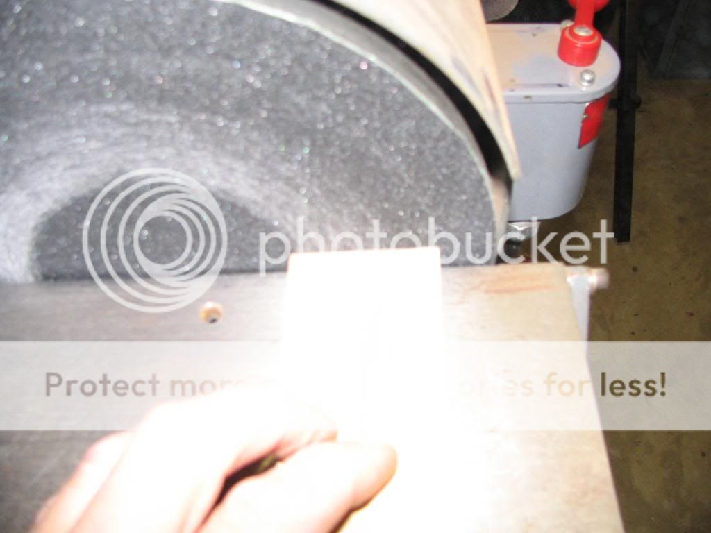

Cutting an angle on the guard end of the scale.
Sanding the cut end of the scale. The table of the sander is set to about 92degrees so the scale will fit on the tapered tang.
With the sander off, I place the end of the scale against the disk and drag it across the table left to right. This gives a nice flat end.
This photo shows where I drug the scale across the disk.

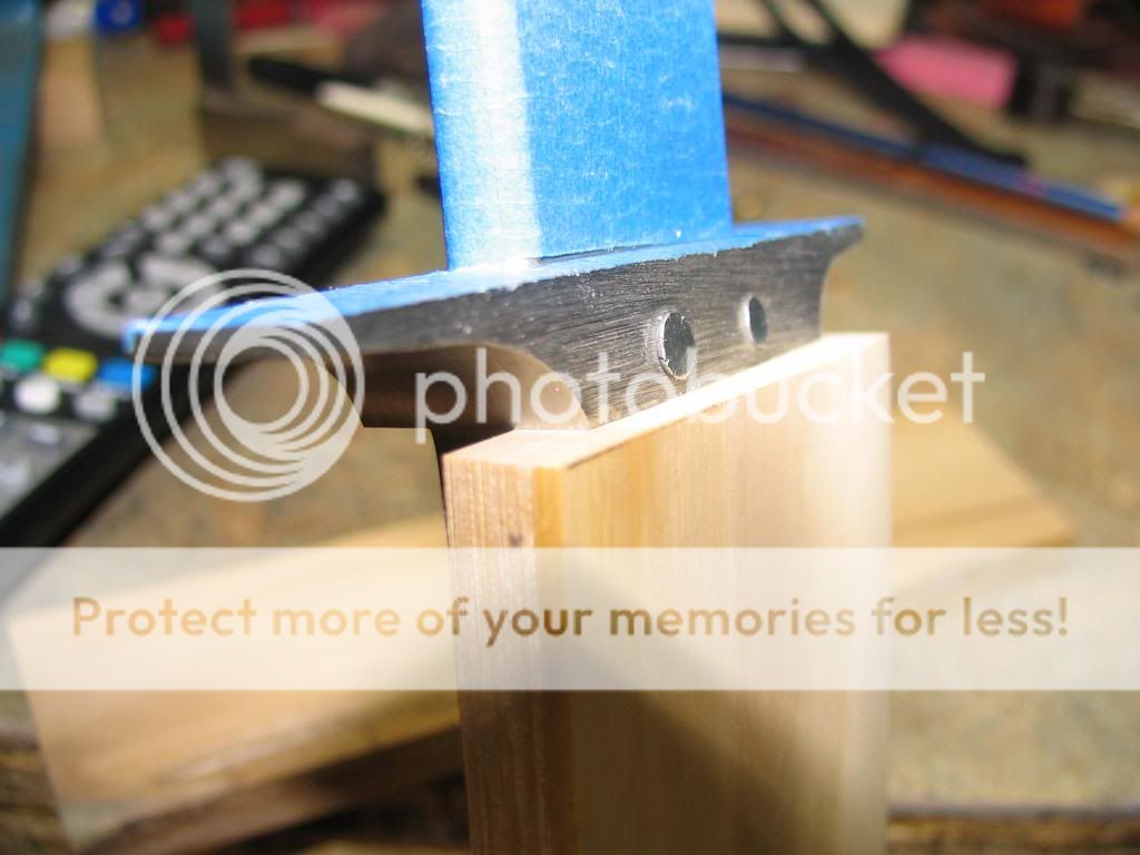

The fit against the guard.

I would say from soldering to end of clean up averages 2 hours.
I left a little to much solder on this guard, but when it sticks all the way around I try not to bother it.

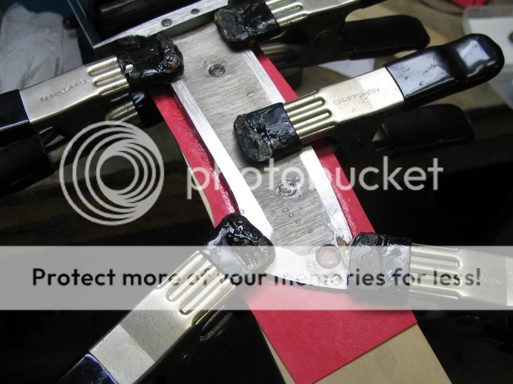

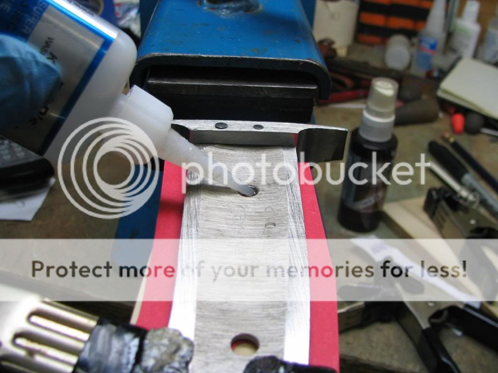

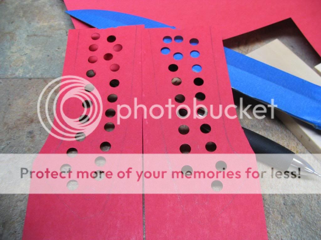

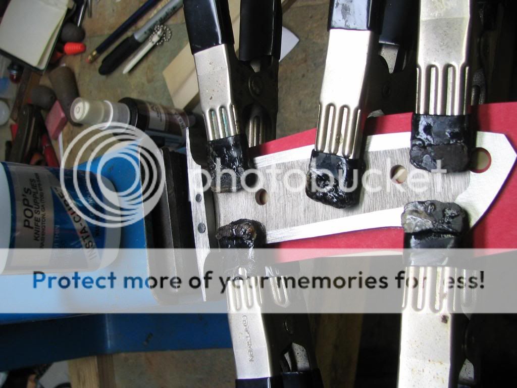

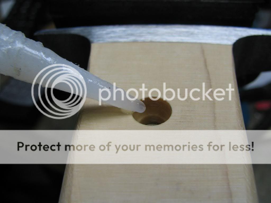

Liners cut and holes punched, the holes will let the glue flow around and fill all areas.
I would like to thank Steve Johnson for showing this method of attaching scales in his Making a Subhilt video. This method allows for precise fit of the liners and scales.
Everything lined up and ready.
Take off the front three clamp and apply thin super glue through the front handle bolt hole. Then replace the front clamps and remove the rear clamps and apply glue through the rear bolt hole and thong tube hole and then replace clamps.
After all the clamps are replaced fill the holes with super glue.

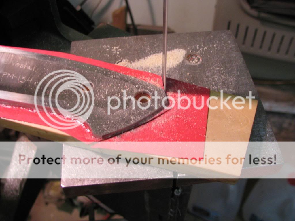

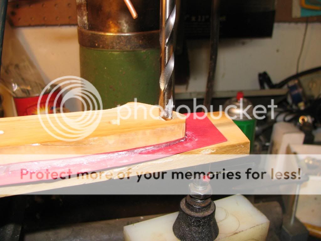

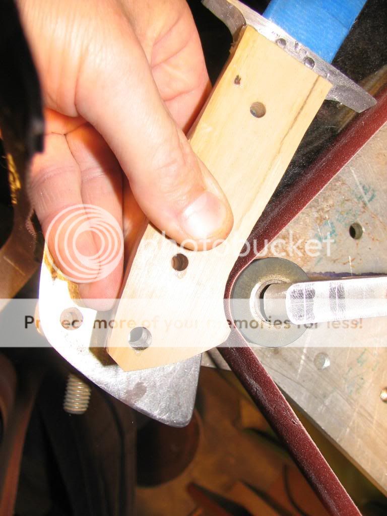

Clamp and drill holes for the handle bolts and thong tube.
Trim the handle material close to the tang.
Now we glue the other handle the same way as the first.
Drill through the holes in the first scale and into the second.
Scales installed and ready for shaping.

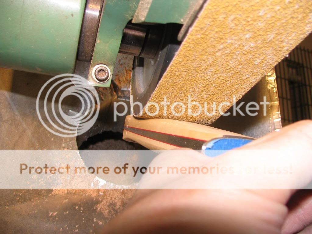

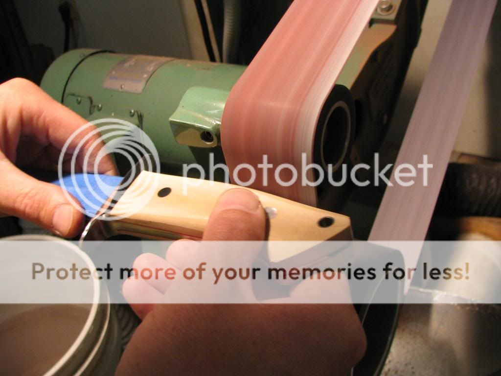

Grinding the scales down to the tang with a 120 grit belt.
Rough shaping the handle.

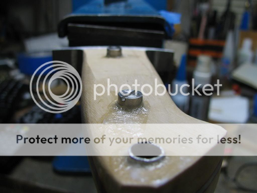

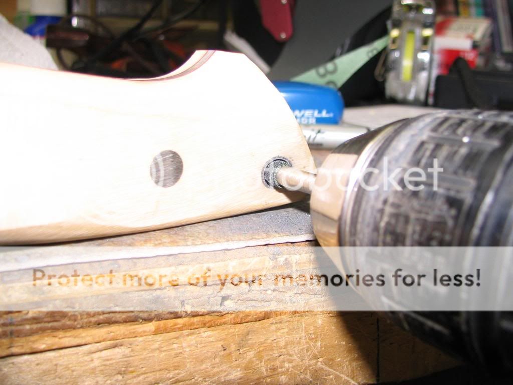

Using a step drill to countersink for the 5/16" Corby bolts.
A little glue in the bolt hole, the other side of the handle already has one part of the bolt installed. then you insert the second piece and screw them together.
After the bolts and thong tube are trimmed with a hacksaw they are ground down with a new 60 grit belt.

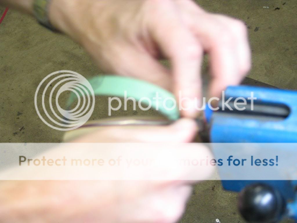

Cleaning up the inside of the thong tube with sandpaper wraped around a 1/4" pin and chucked in a cordless drill. I progress from 120-800 grit paper. Then the 800 grit is loaded with buffing compound to polish.
Forgive my ignorance, Mr. Vestal, but I am curious as to how the super glue holds up under use. I am an architecture grad student and use the exact same glue for constructing far too many tiny models than I would ever care to. The glue is strong, of that there is no doubt, but at least in my experience has a tendancy to get brittle when fully cured (models breaking makes me sad :().
How does it hold up when applied to a knife handle that may very well be subjected to repeated shock-impacts/vibrations? Have you found it better suited than a more flexible adhesive?
I am in no way questioning the quality, durability, or skill associated with building this gorgeous knife, I am just very admittedly under-informed in the construction of custom knives and my curiosity has gotten the best of me. I appreciate the thread very much it is most fascinating. :thumbup:
I had the same questions as you ask when I first watched Steve Johnson's video. I talked to Steve about how the super glue would hold up and he said that he has had to replace the handles on some of his knives , the cusomer wanted them changed, and they were very hard to get off.
So i tested the super glue method by gluing a set of scales with liners on a knife. After the glue cured I beat the handles with a hammer and the liners split and the glue held.
Since then I have had to replace a few sets of handle material because of flaws in the material and every time the glue has not failed. Usually pieces the handle material will stay on the liner or the liner will split.
With the addition of the Corby bolts which are doing most of the holding, I have found this to be a very durable method of attaching scales.

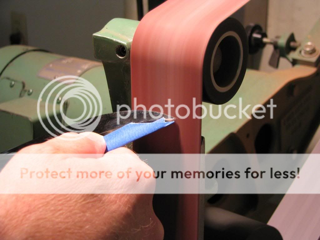

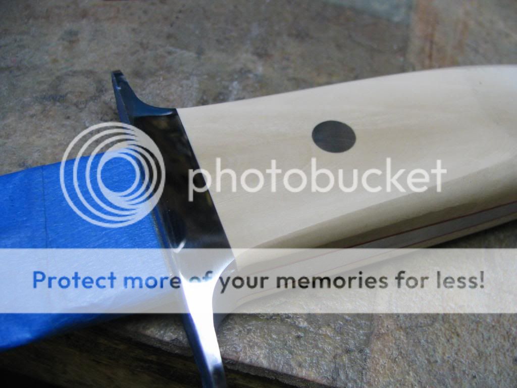

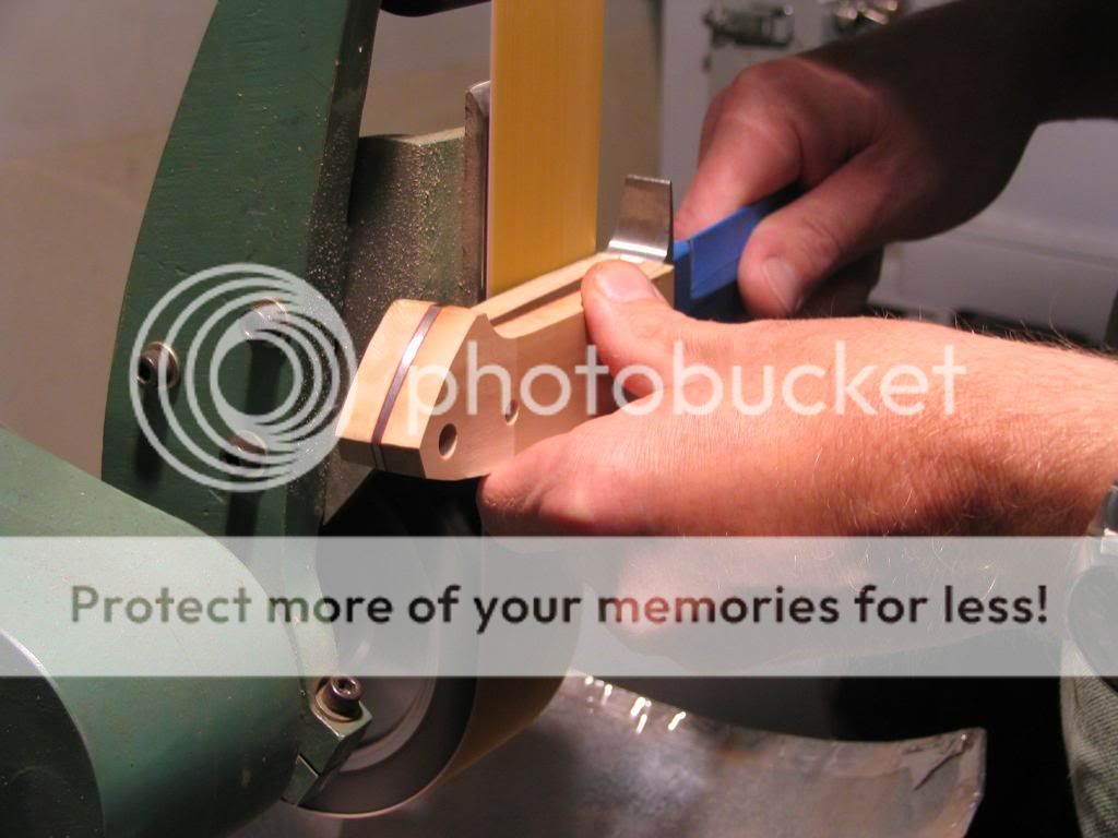

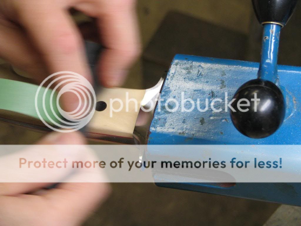

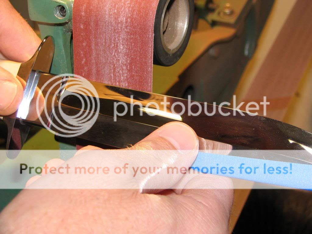

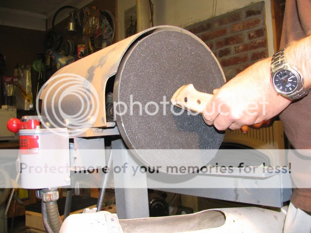

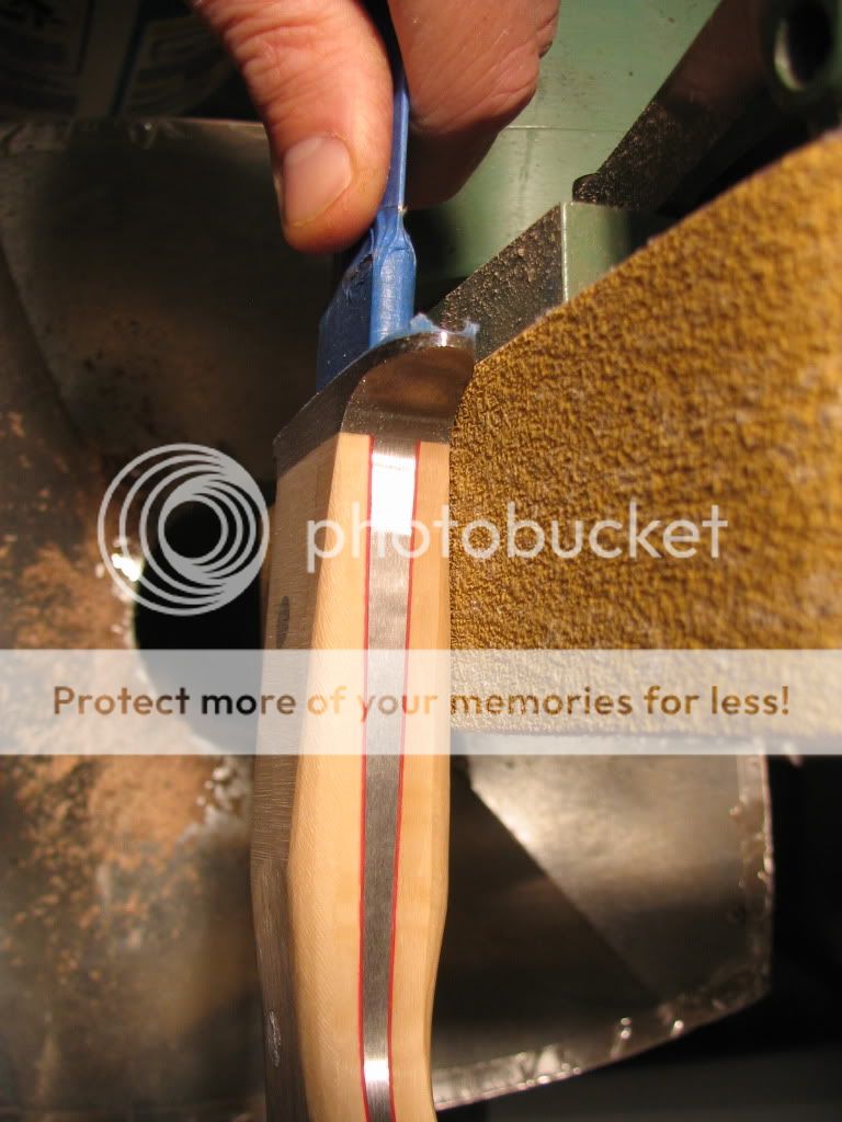

Using the disk sander to clean up the guard and front part of the handles

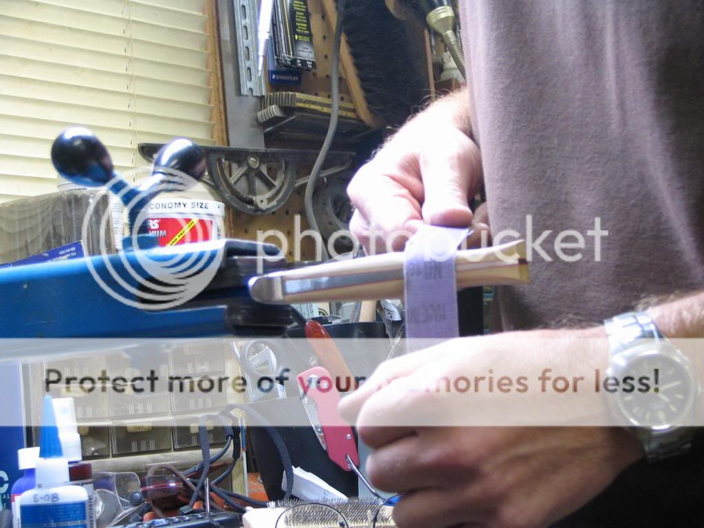

Start with 120 grit and work through to 800 grit.

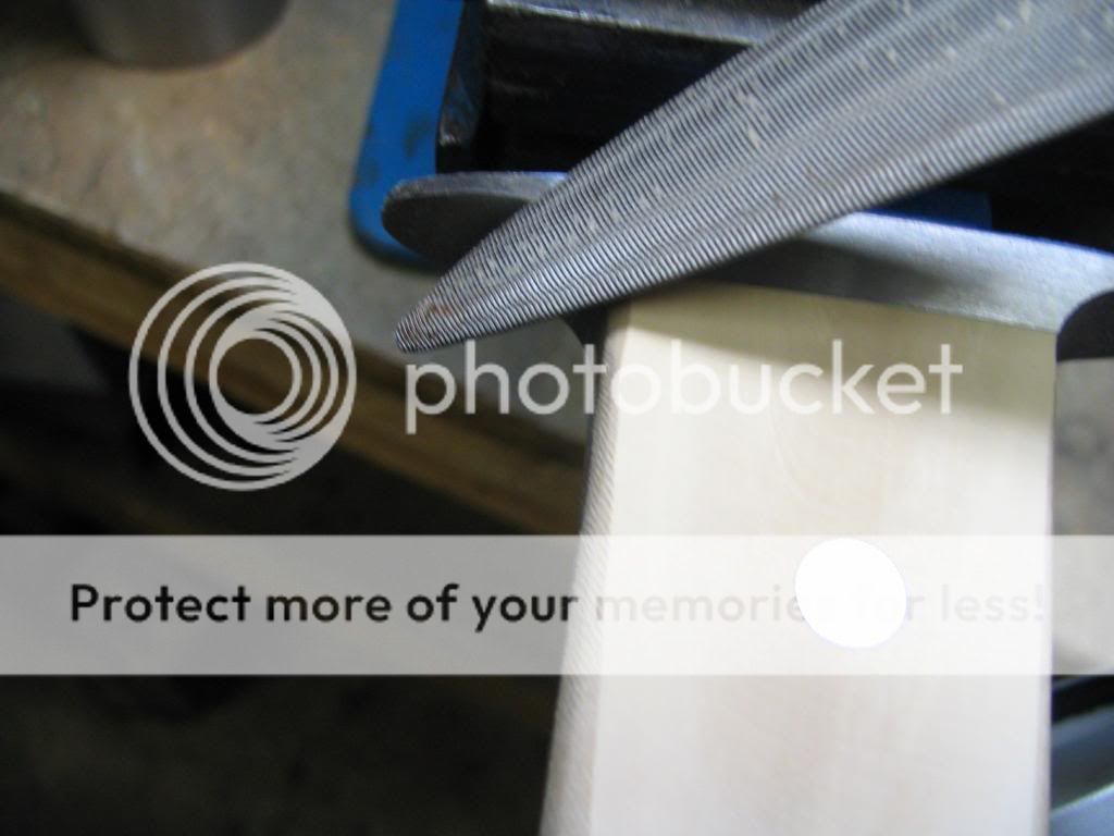

Rounding the inside of the guard.
Alot of hand sanding.
A little belt grease on used 800 grit paper.
one more time on the disk.
Cleaning up the tang.
More hand sanding

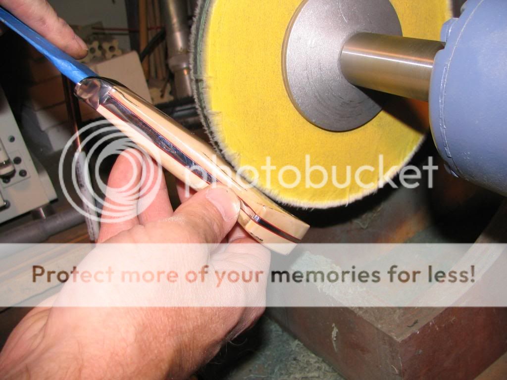

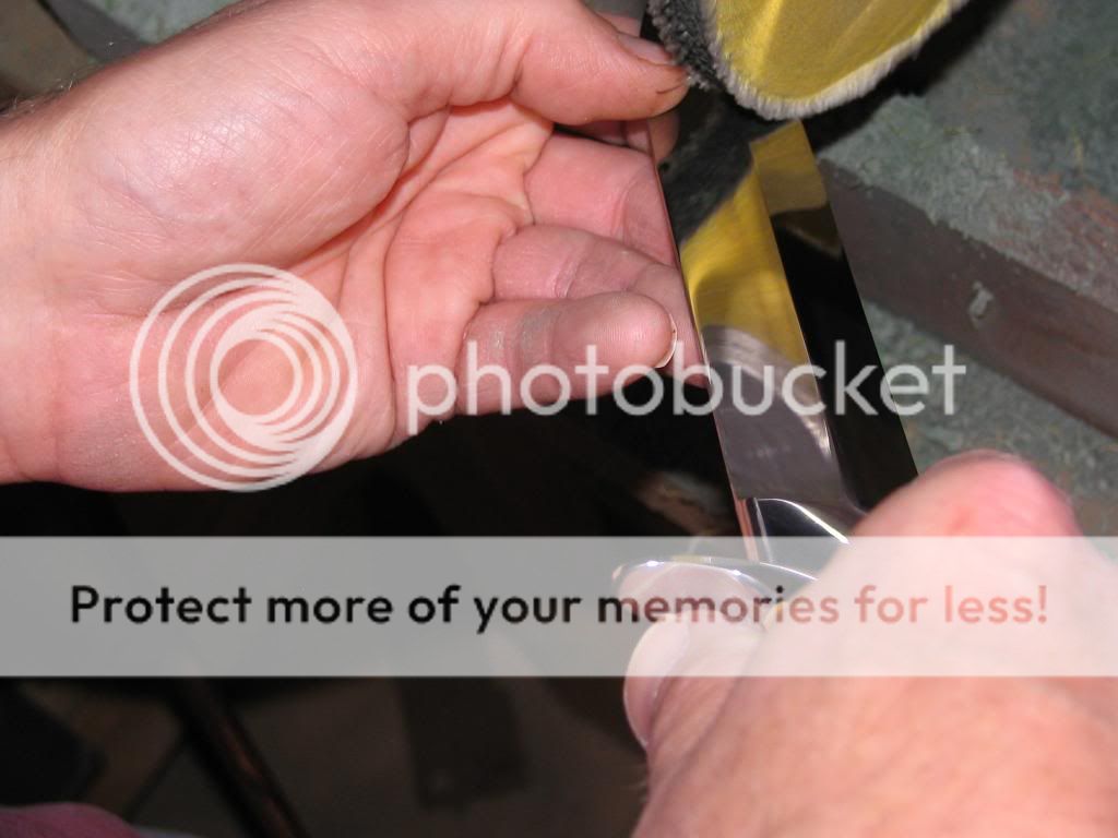

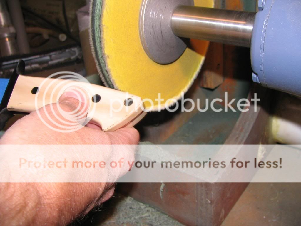

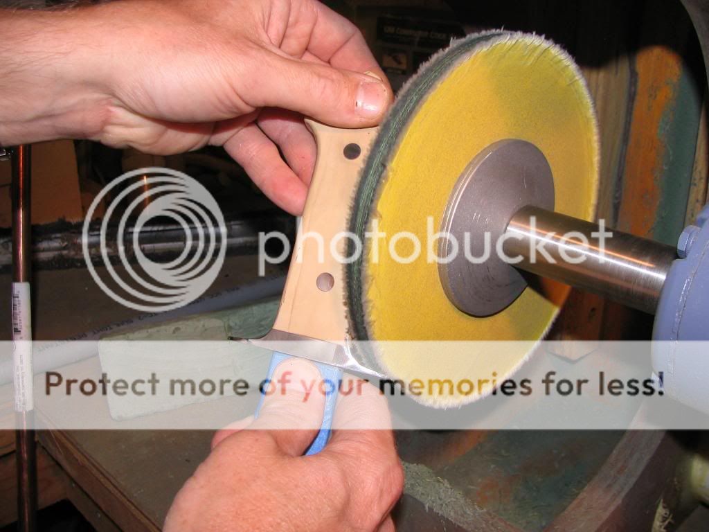

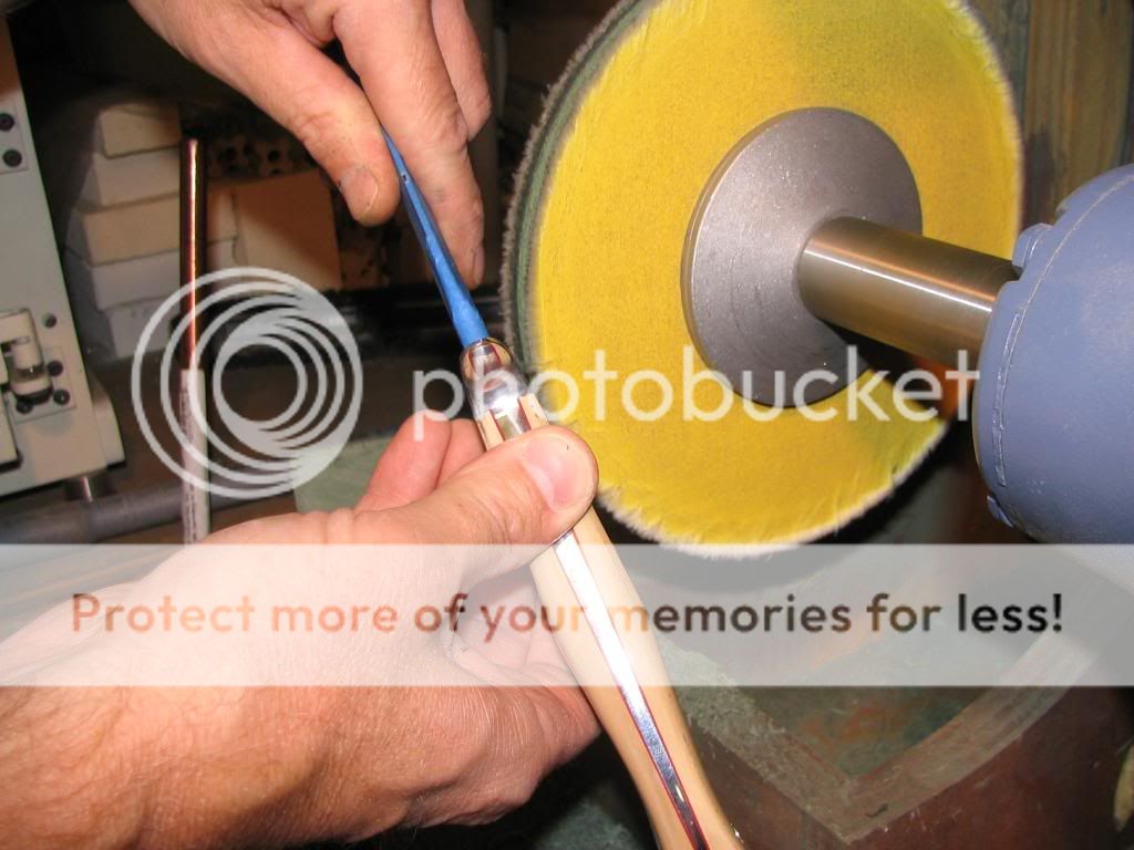

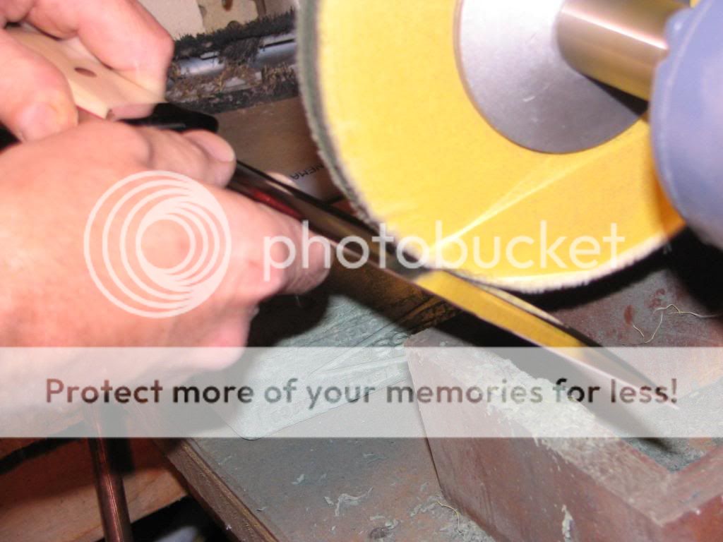

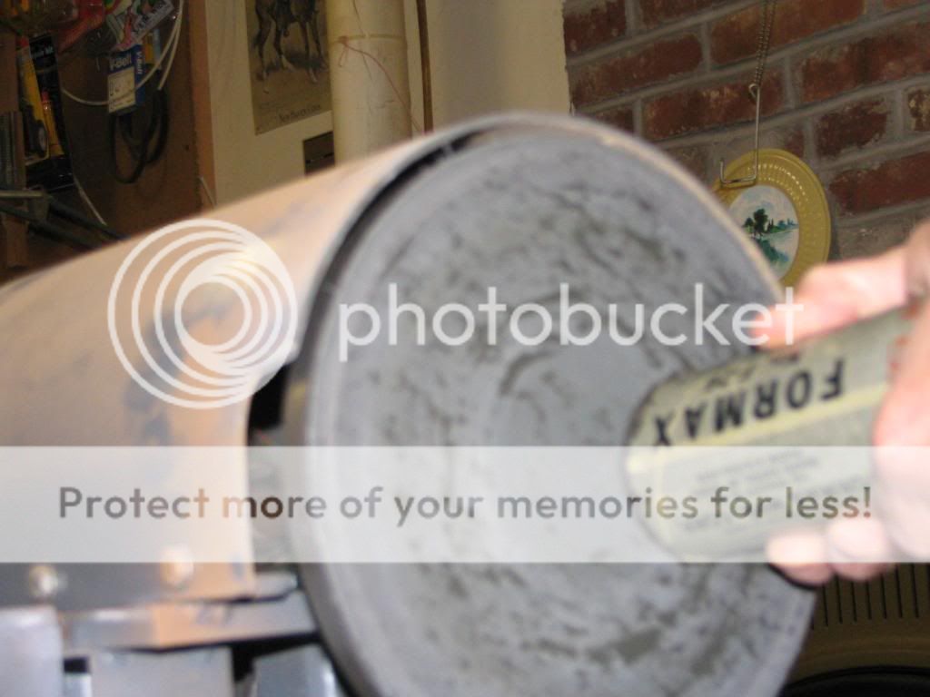

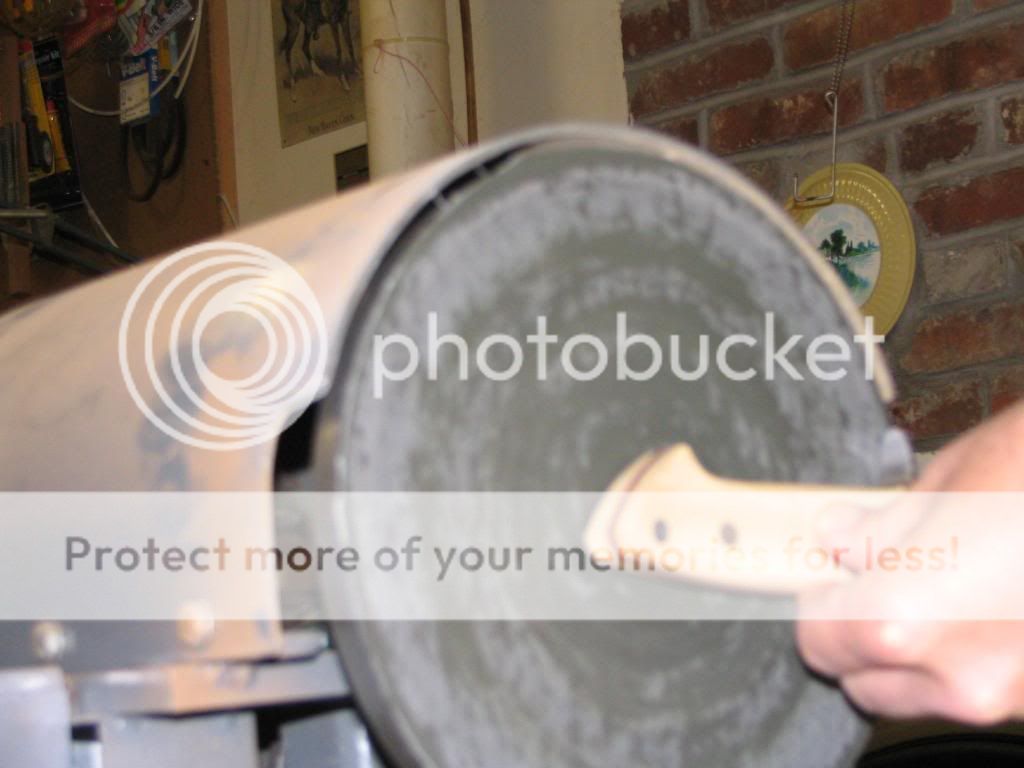

Now its time to buff. I start with Green chrome compound and the switch to White compound, all on the 3500 RPM buffer.

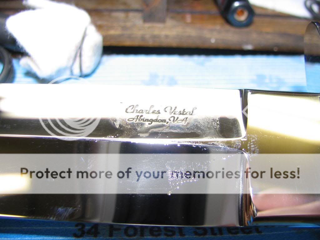

Time to put the logo on
Putting on the edge.

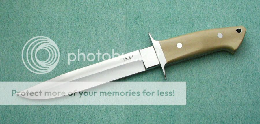

Here is what we end up with.
The knife has been to Paul Long for a very nice sheath and should be at Coops place for a photo shoot.
