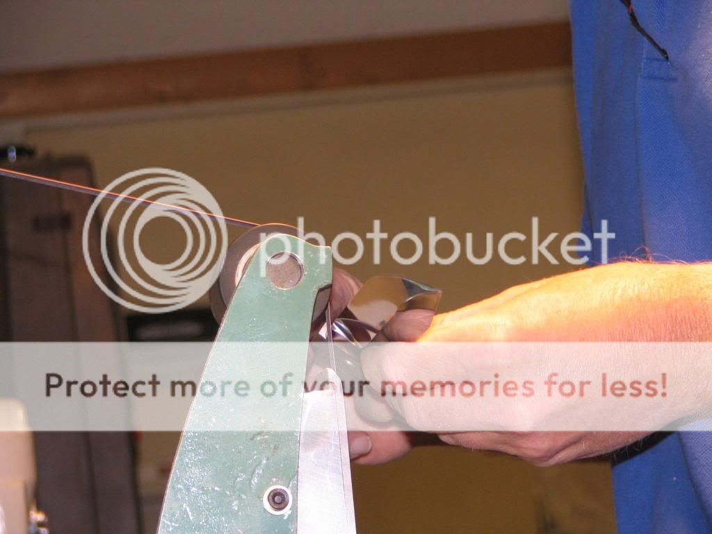

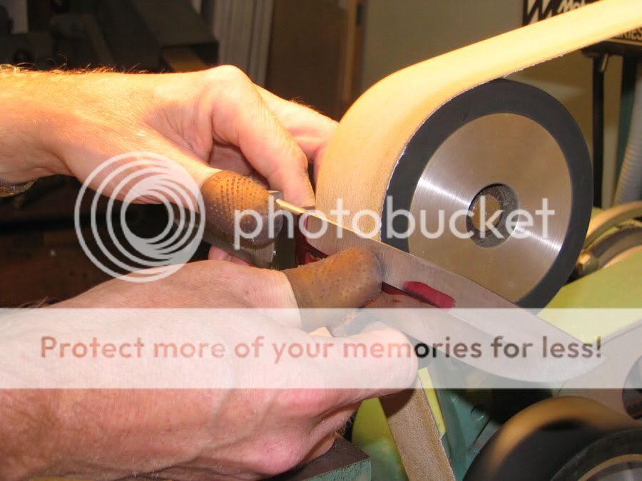

Rounding the choil

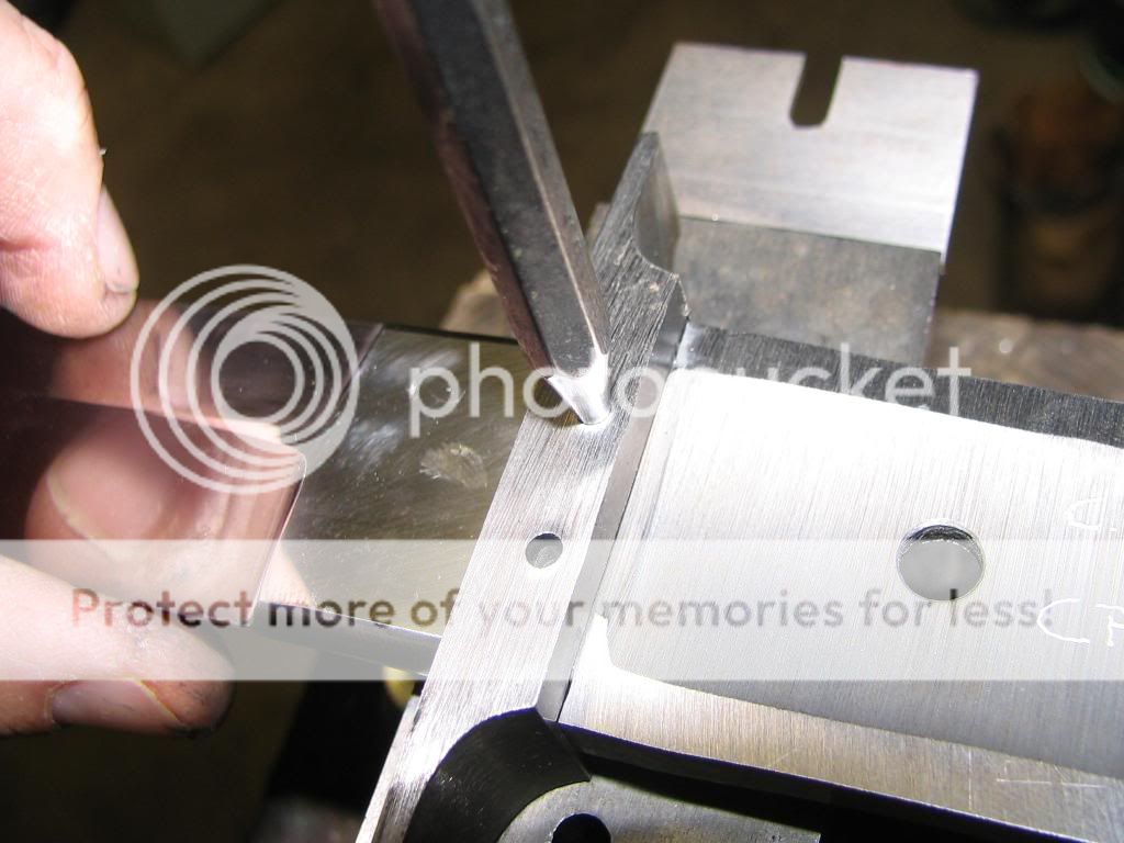

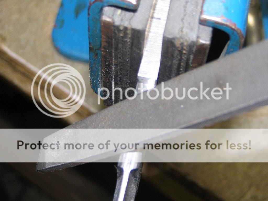

Using the file guide to square up the guard notches.

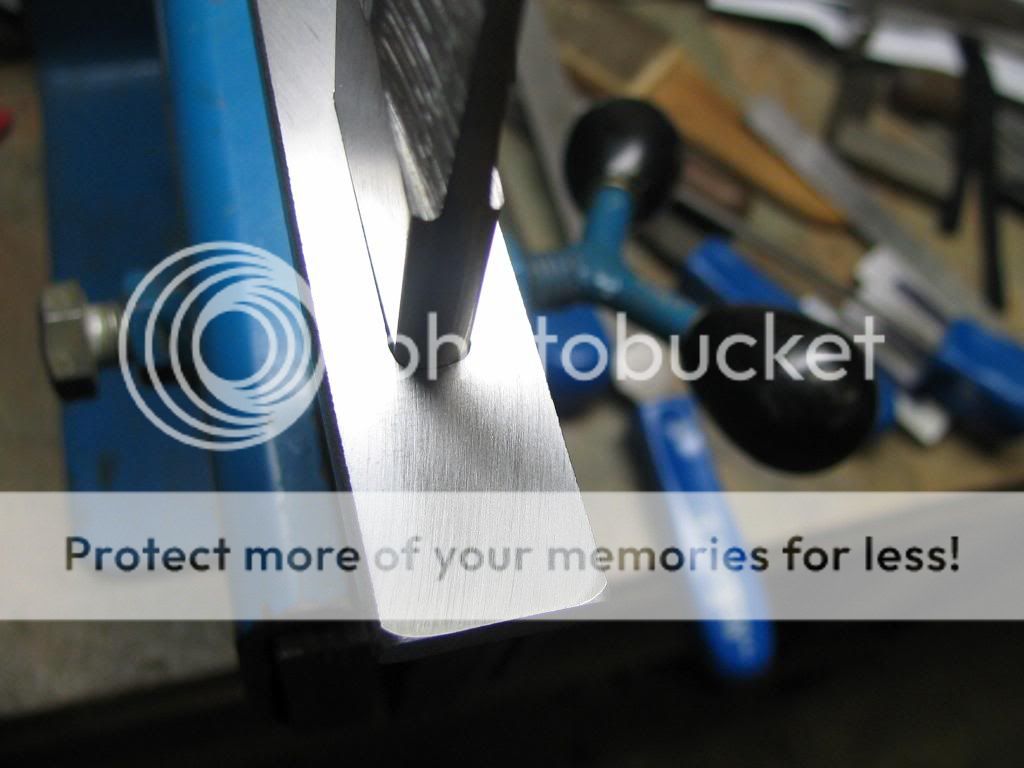

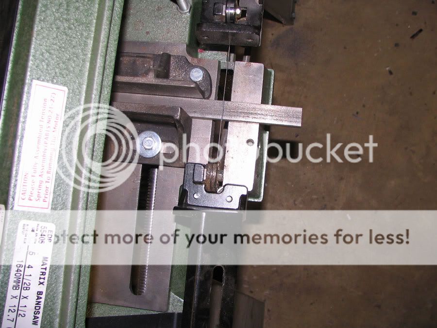

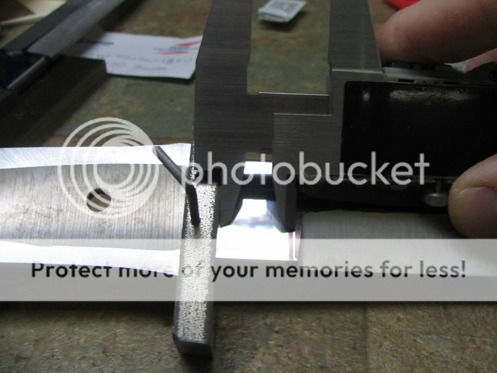

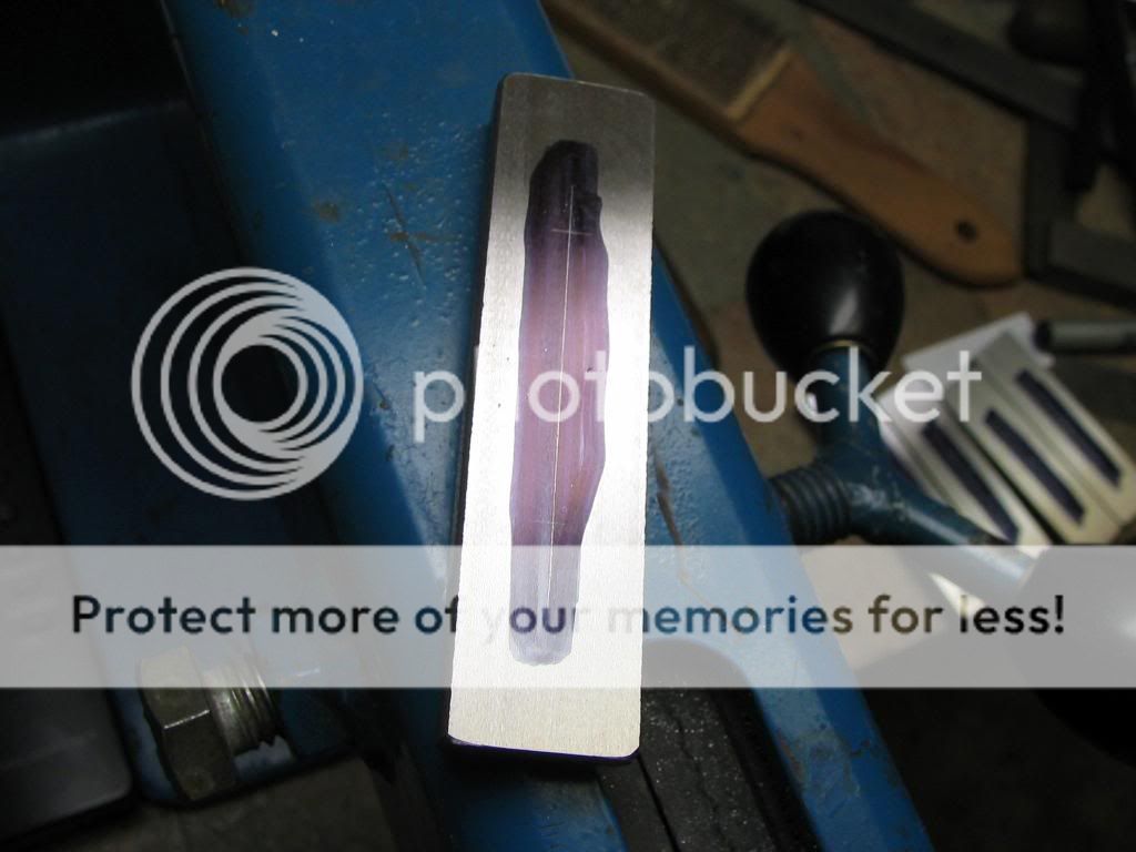

Cutting a 3" section of 416 SS for the guard

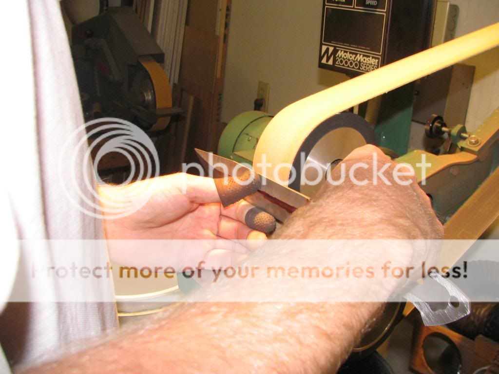

Cleaning up the mill finish on some guards

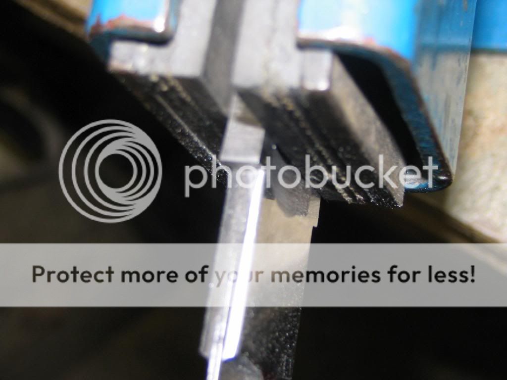

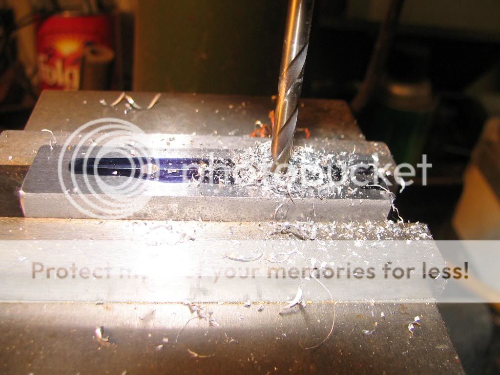

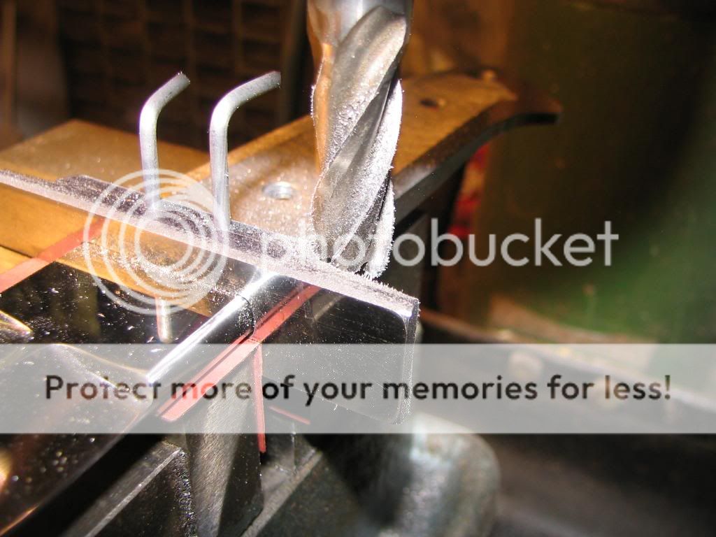

Drilling a hole close to each end of the guard slot

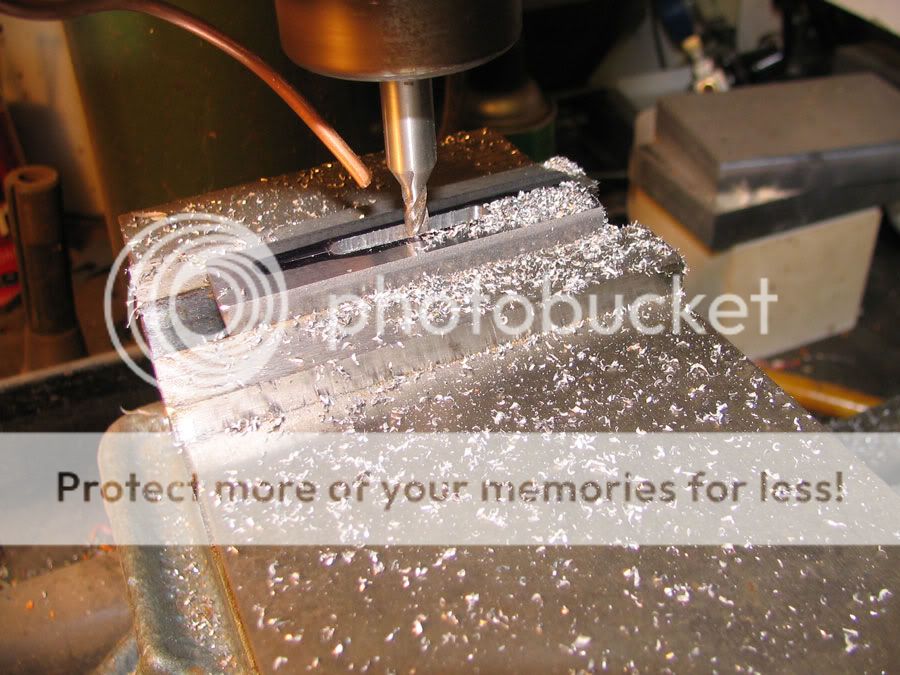

Milling the material between the holes and then mill up to the marks.
Taking off a little bit more

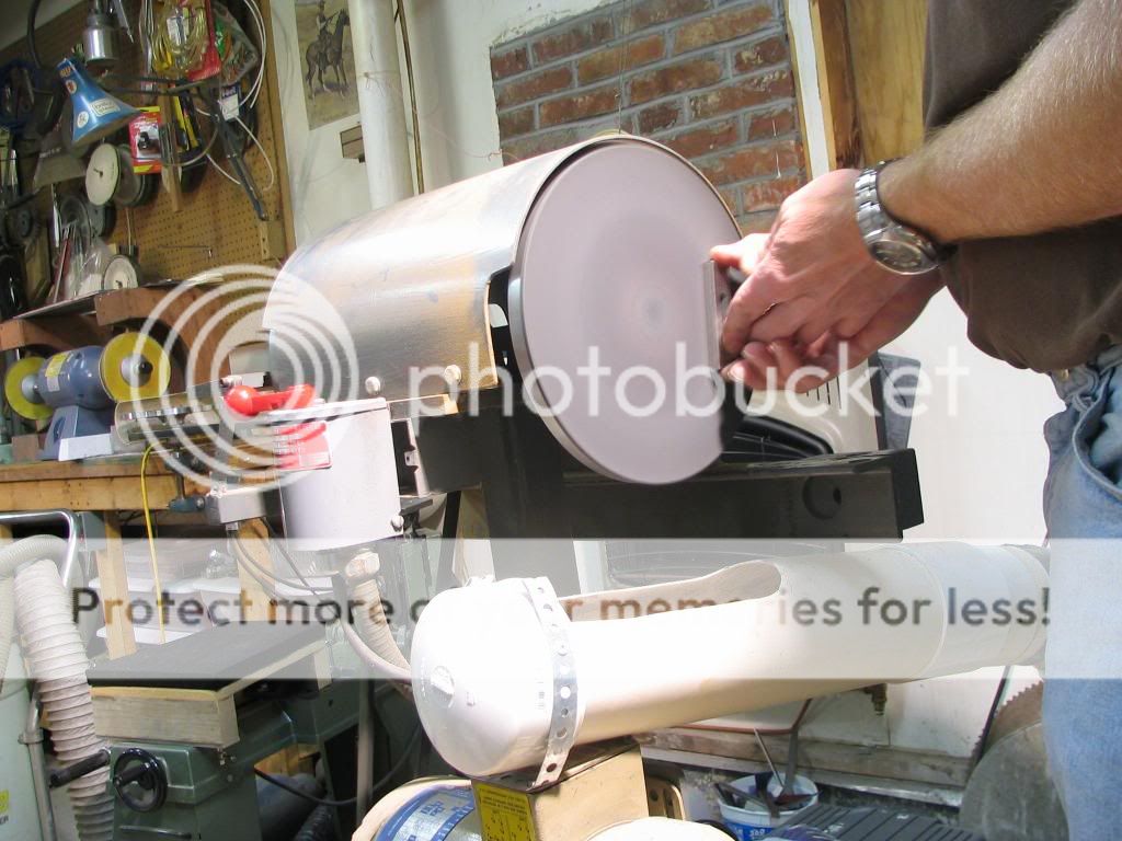

Cleaning up the top of the guard.

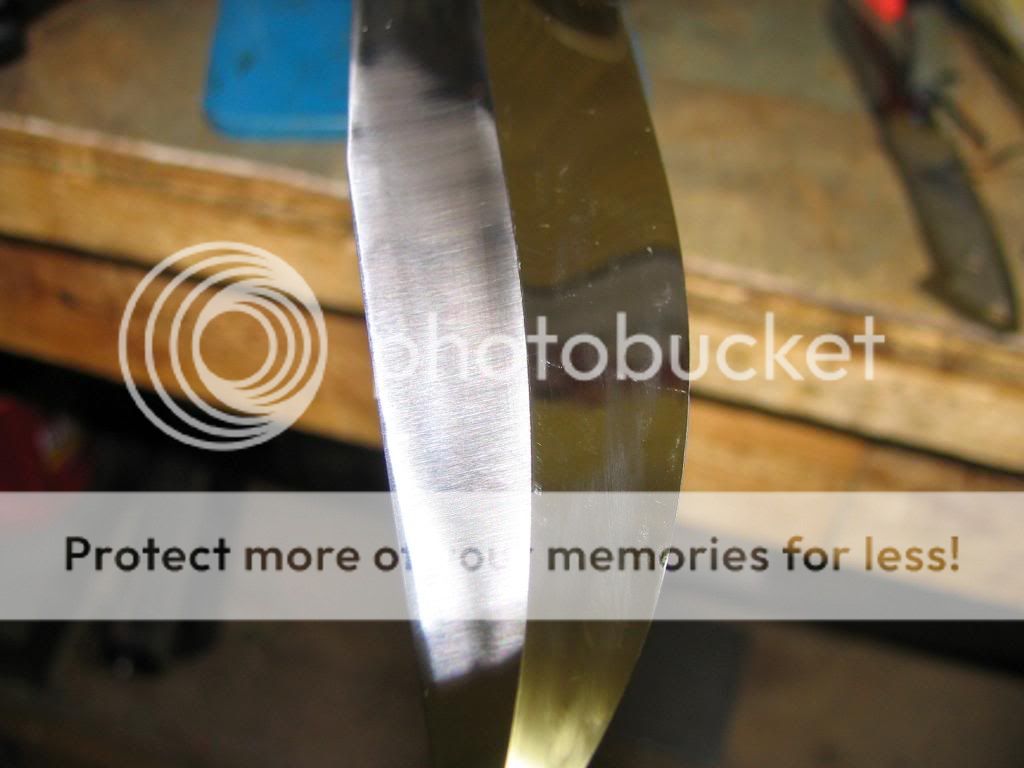

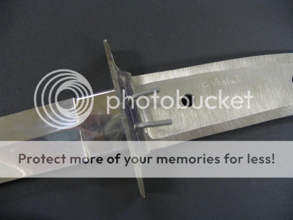

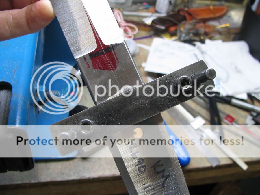

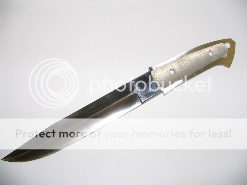

The result of the guard fit-up

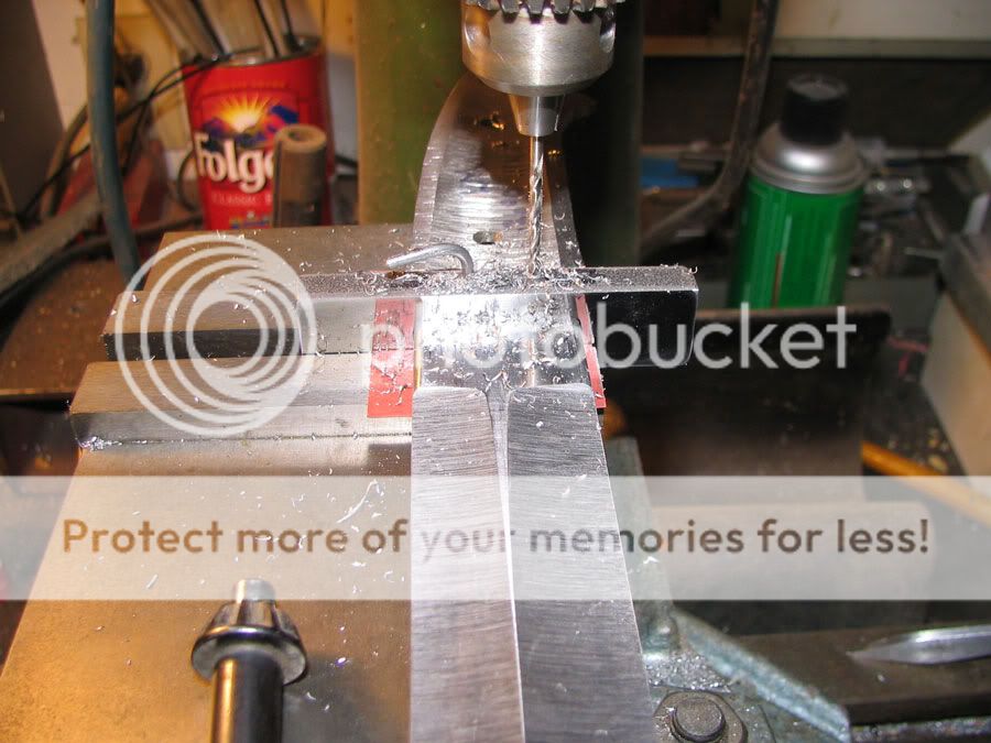

Drilling two holes in guard. This will be the last step before the knife is sent off to Paul Bos for heat treating.

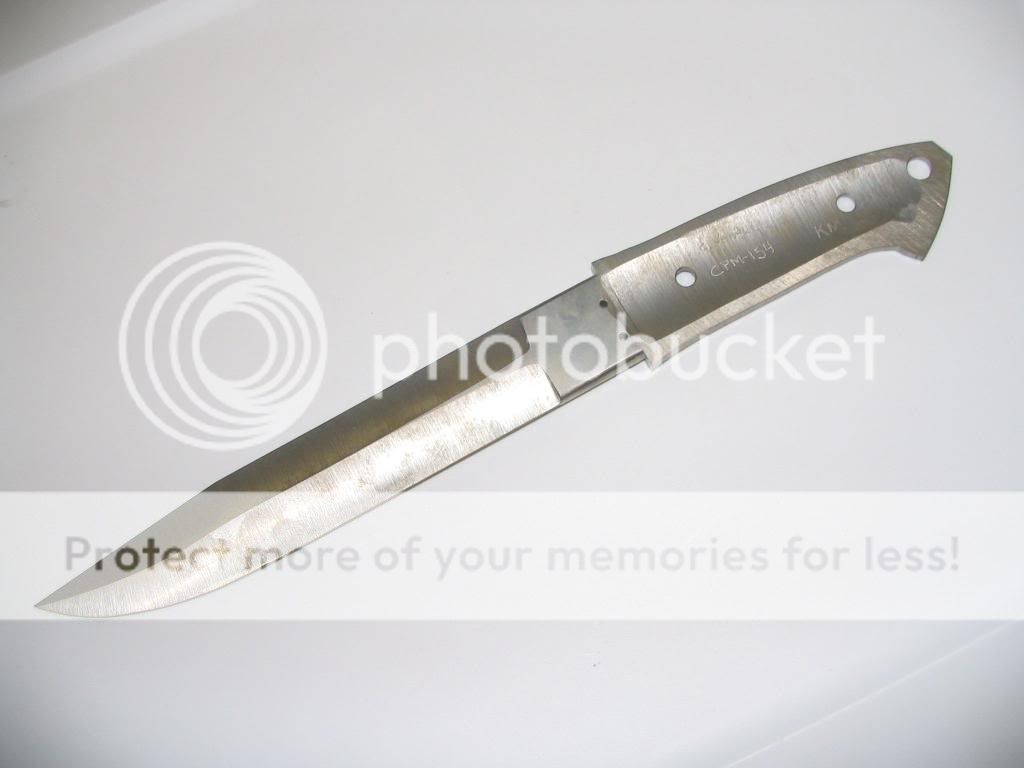

We move forward in time about three weeks and Mr. Bos has heat treated the CPM-154 blade to 60-61 RC

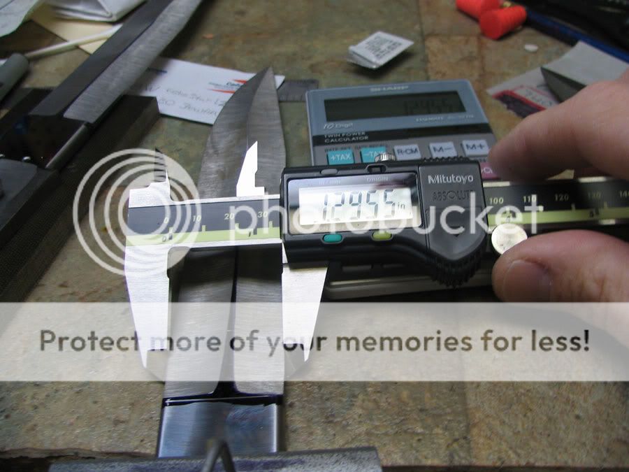

Measure the width of the blade devide by 2 and subtract 0.050" this will give you the distance from the top of the blade for the center grind line.

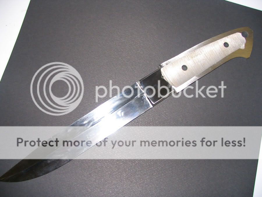

Here is the blade after the 400 grit belt work.

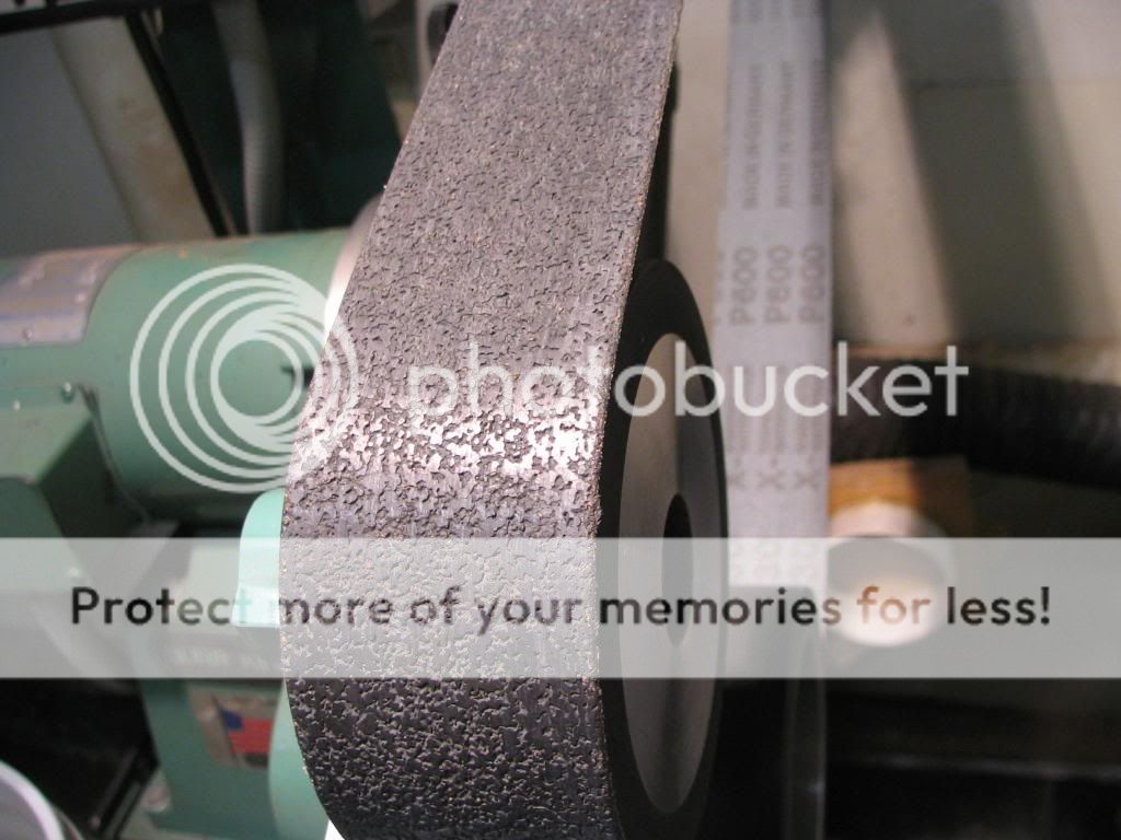

We now go to a 400 grit cork belt loaded with green chrome compound.
The on to a 600 grit cork belt loaded with the same compound.
Now some wet sanding with 2000 grit paper. I use a piece of brass to back up the paper.
The grind on the right has been hand sanded and you can see the results of this step.

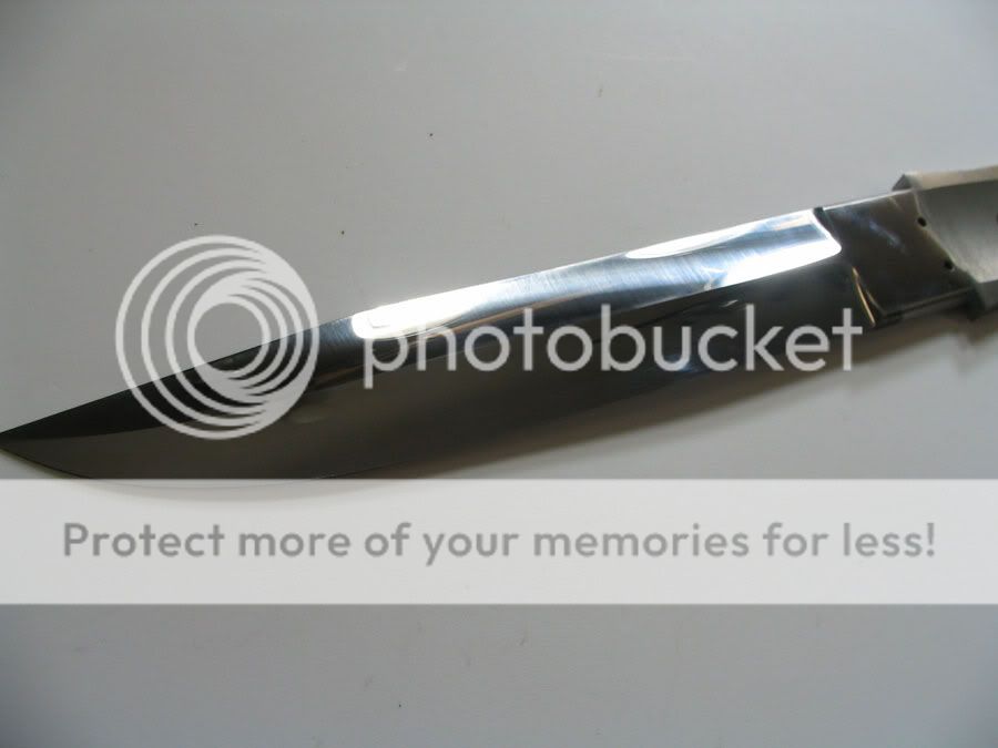

The whole blade wet sanded.

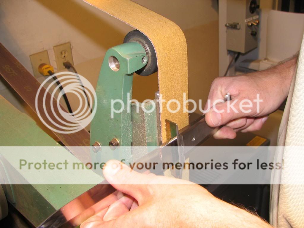

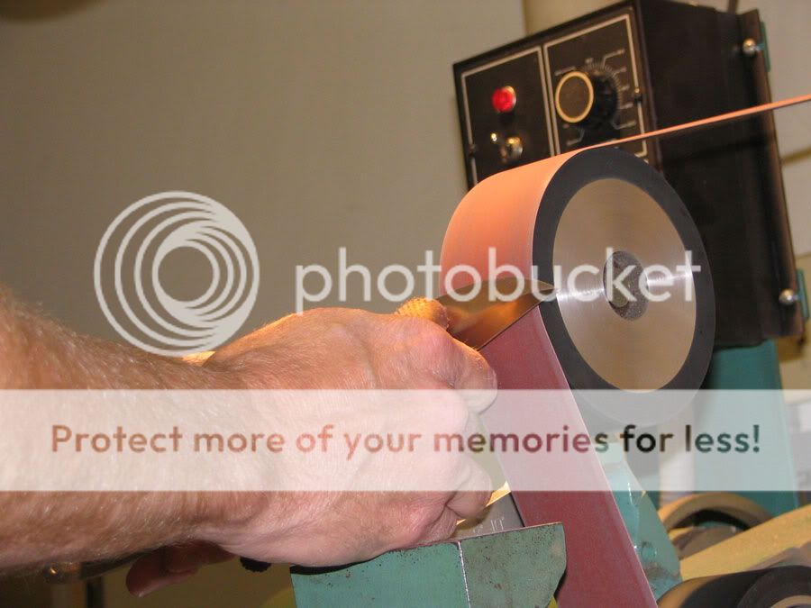

No trick to matching up the plunge lines, just have to grind a little look at where you're at and keep doing that untill you get them close with the 60 grit belt. Then you can fine tune them with the 400 grit belt. The 400 grit cork belt will remove very little material but it is good for cleaning up the plunge.

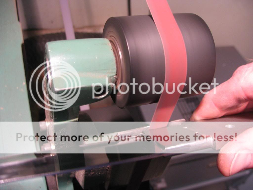

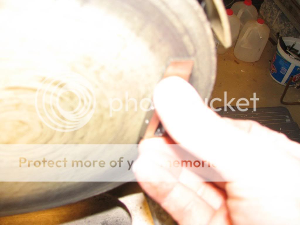

Cleaning up the choil with a split 400 grit belt.

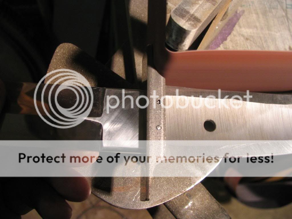

Cutting away some of the guard wich will make the next step easier.

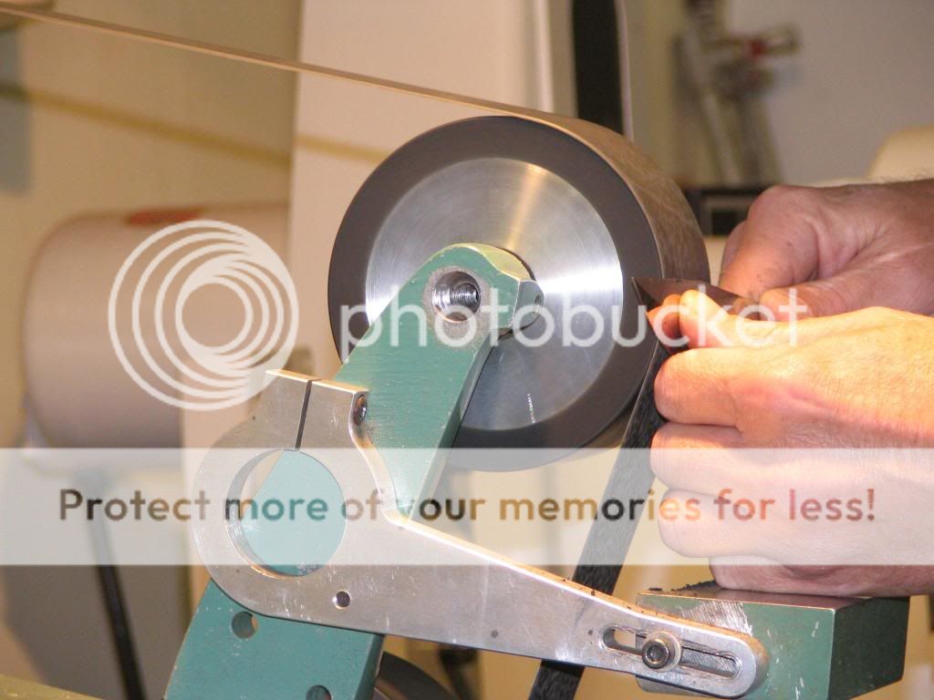

Using a 1/2" mill to radius the guard cutout.
Remove the last of the material from the guard radius with a 120 grit belt.

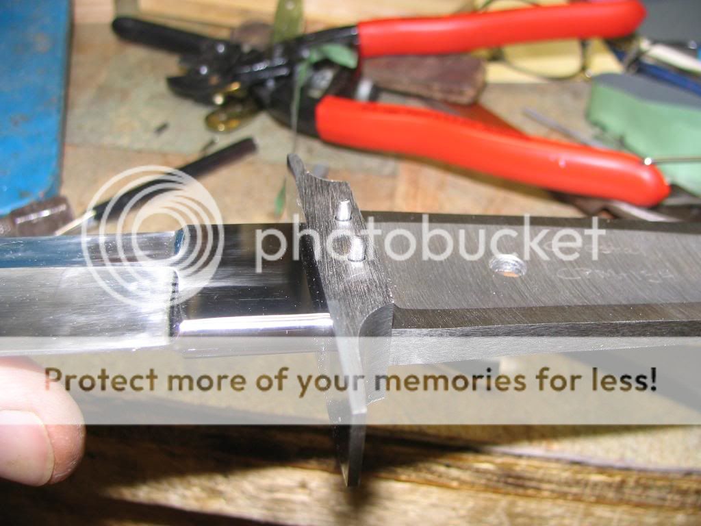

I use a center punch and hammer to flare the guard pin holes.

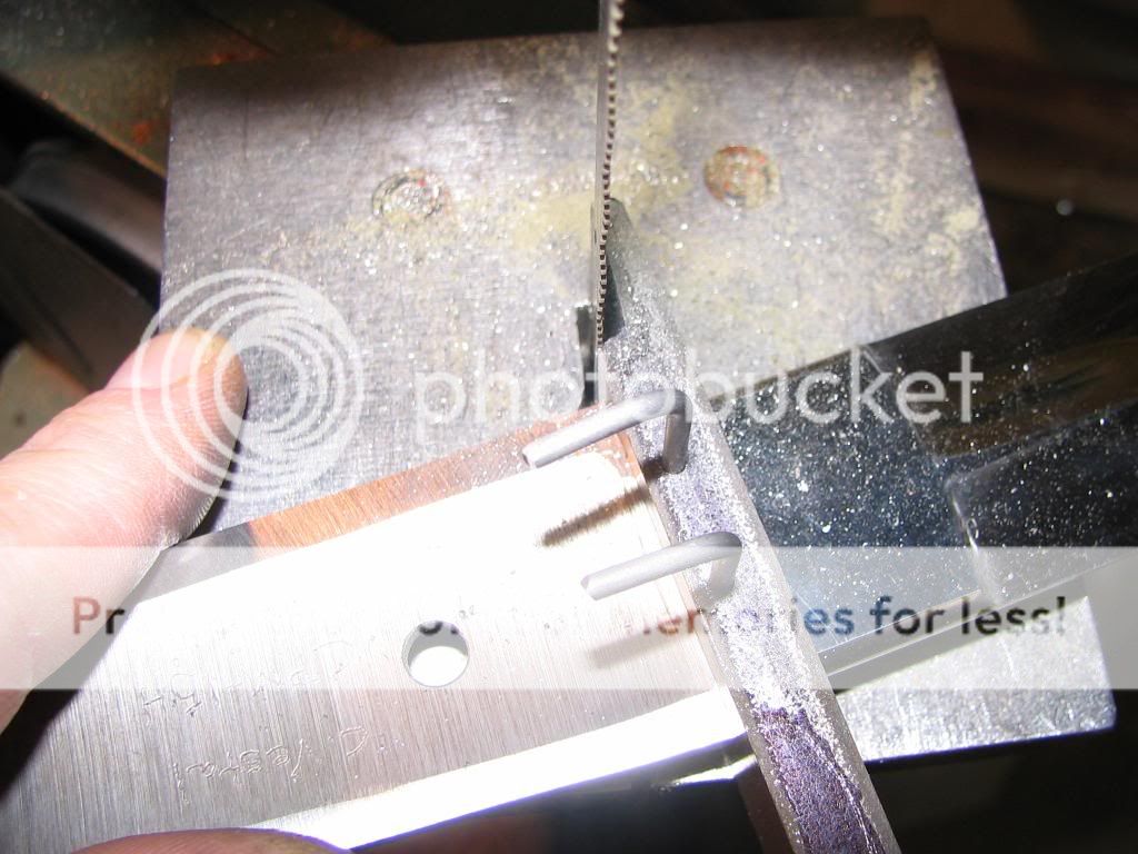

Pins cut and domed

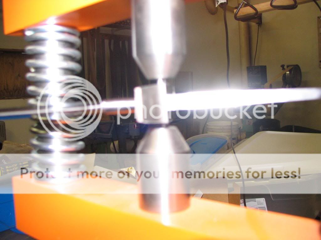

Using the pin press to flare the pins
