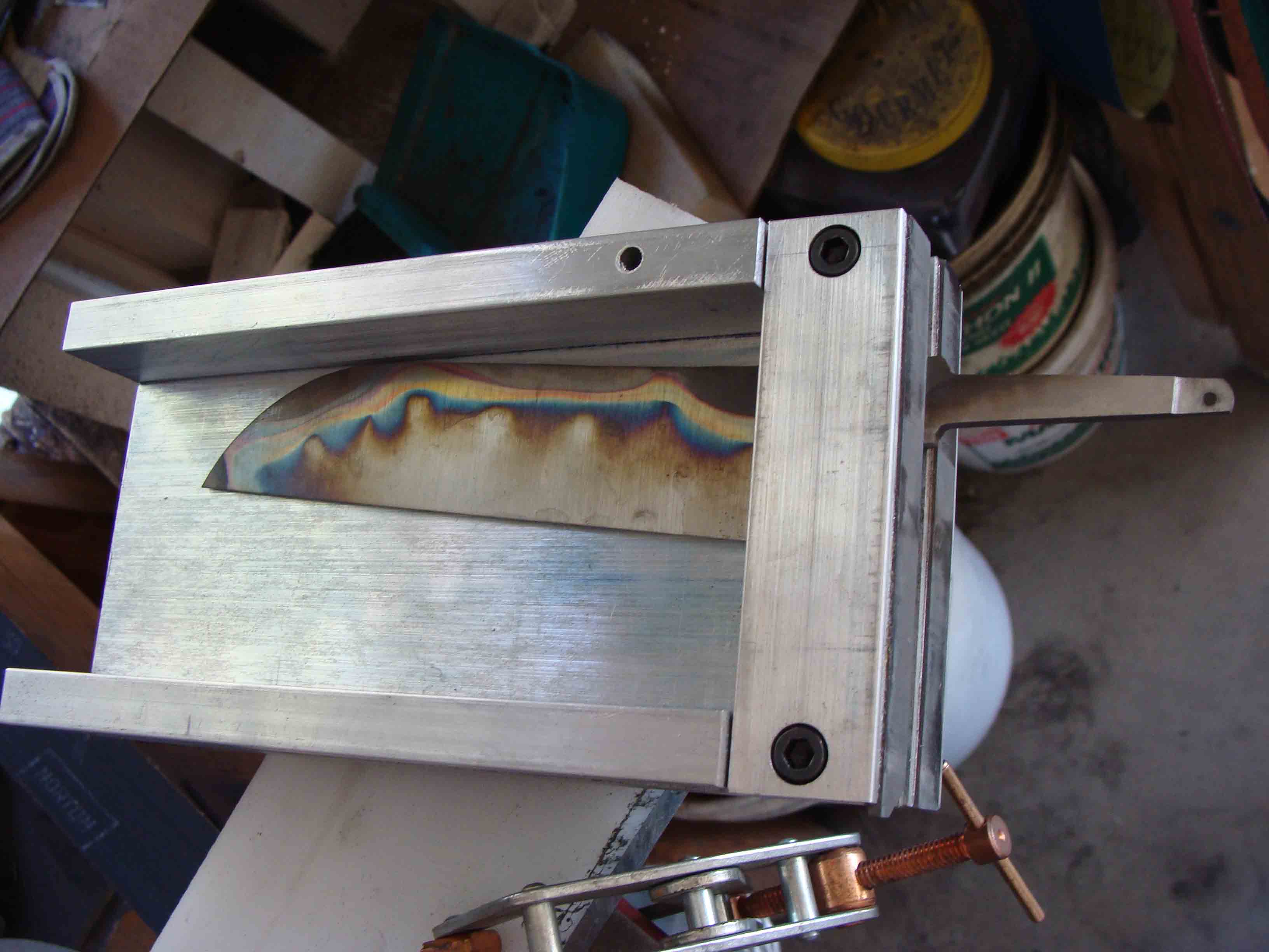

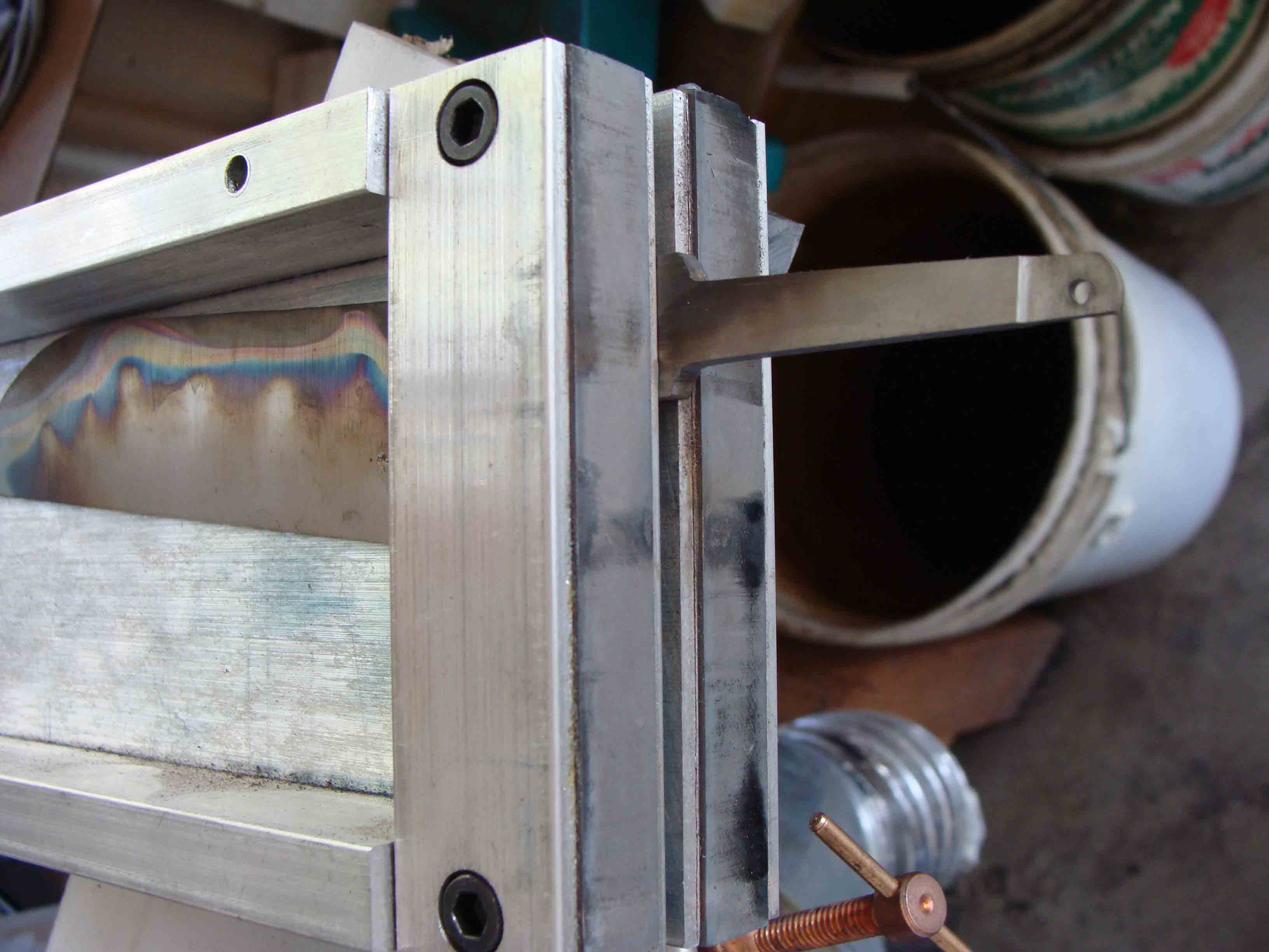

Wow Carl- those are some fancy drawrings! :eek: :cool: :thumbup:
Thank you! That's a lot fancier than my pencil sketches ;)
I already bought materials to make a couple different guides... I think everytime anyone complains about the price Uncle Al charges for his, I'll just post copies of my receipts. This crap is expensive--- dowel pins, drills, reamers, carbide strips... not to mention the time to build the thing. $150 is a deal! Especially if you have to buy a diamond coated wheel for the surface grinder.
woodworker- I actually made one like you described, but it's hard (with what I made) to get the blade positioned exactly where it needs to be. Some red-neck re-engineering would probably fix that.
Sam, using one side as the reference might work, but I use the guide for lots of things in the show nowadays, and I'm not sure if it would work for all my tasks that way.
I'd like to get a better understanding of what James and Rick are saying, because maybe I'm just on a different page.
My mentality with most things like this, are that I don't mind getting complicated when building the actual guide/jig/fixture.... if it means it will be simple and straightforward once in application. :)
My first thought was right on the line of Carl's...he just put my thoughts into pictures much better than I'd have been able to describe it. :) Looking forward to seeing what you come up with. You always build such nice fixtures.

I think Carl's take might benefit from some swivel tip screws to actually push on the tang and keep everything centeted, and therefore keep the guide faces perpendicular to the midplane of the blade. Otherwise it could rock or move.

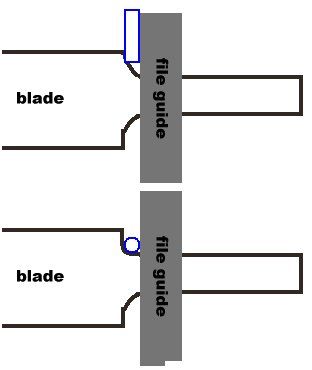

Here's what I was trying to describe:
Square the shoulder faces with a rectangular file, clean up the radius with a round one. (the files have to be the same width, obviously.) Sorry for the de-rail :o
Thanks for the drawing James, I appreciate you following up with that. :) :thumbup: I guess the bad part here, is that is what I thought you meant. :foot: I've actually tried it that way a few times in the past and it didn't work for me.
I can see where that seems like a simple solution, but in application it is really hard to file perfect shoulders. Any rocking, or just slight movements off of a perfect plane mess up the shoulders.... and for me, that's what the guide is for--- to eliminate those little body quirks or slips that knock a corner off. And like Rick mentioned, my tangs taper down from the guard, usually as much or more than, the blade distally tapers to the tip. So I would still have the taper issue fighting me.
Solidworks :)
What Carl drew is a pretty standard tapered jig setup. I don't see any other way to do it.
If I could pencil sketch faster than CAD I would have. ;)

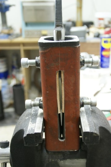

Here's what I use. Learned this from Mike Vagnino. Even with short ricasos it keeps very square. If needed slip in some shim stock at front of knife, it's a very quick process.
Shoulders are done post heat treat on grinder or disk. No more hand filing. Love this thing.
