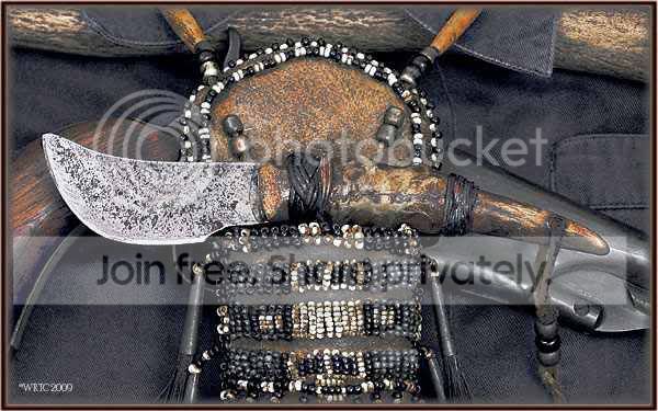

This one is a farrier's rasp forged thin with almost none of the rasp marks left. It's a collab done with Carl Rechsteiner.rxrl3resized.jpg
I'm noticing a pattern here.. almost all of the knives being displayed are forged from files... as opposed to a stock removal process.

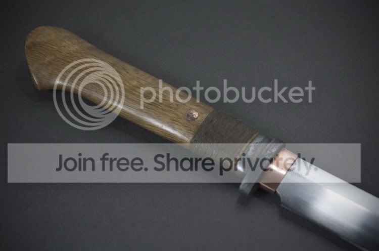

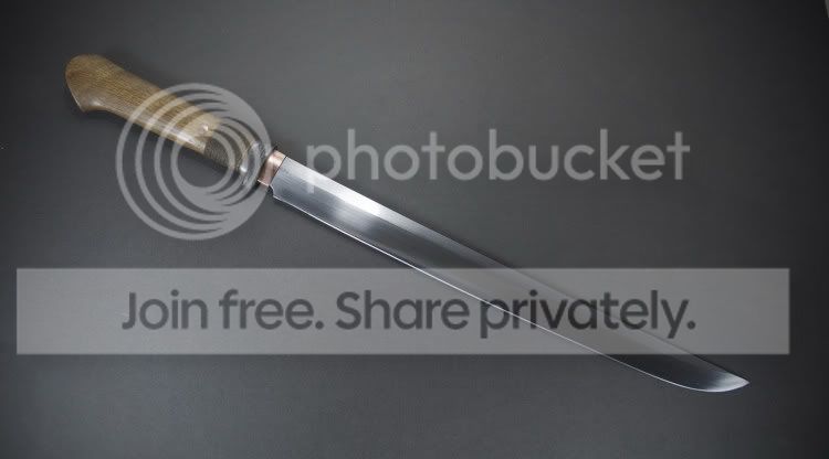

This was a Family Heirloom set, made from remnants of the ol' "Home Place".
A file from the floor of Grandpa's shop in the barn, handle made from a stabilized piece of an oak beam, and the guard from a splitting wedge.
All to remember times on the farm when they were kids.

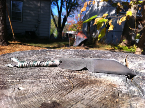

This one came from a file. In the second pic you can see a few of the teeth left near the habaki.
