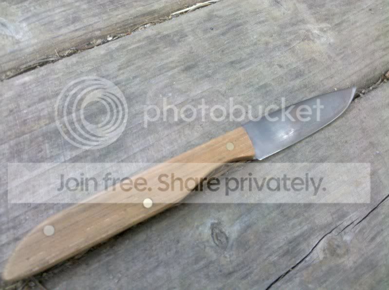

This is the first knife I ever made, started when I was 14 made from an old Nicholson file.
I got tired of dealing with files quickly and went to barstock

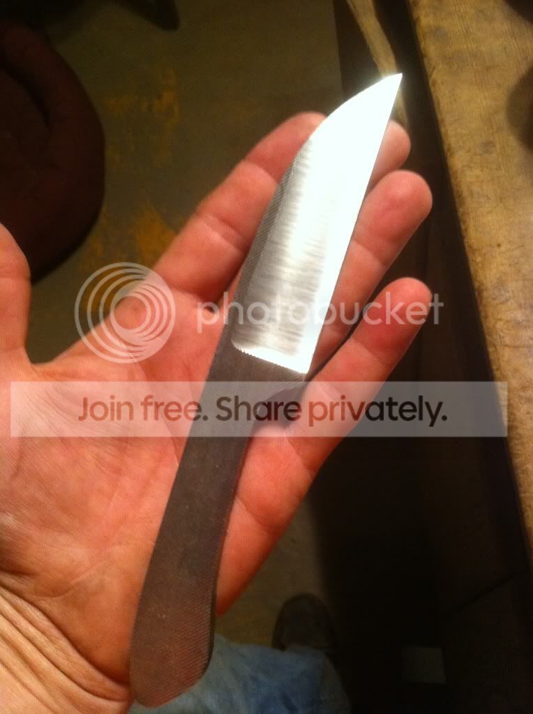

In progress:
Work in progress, file knife number 7. Probably the only one so far I'm proud enough to show. Its almost finished.
WIP

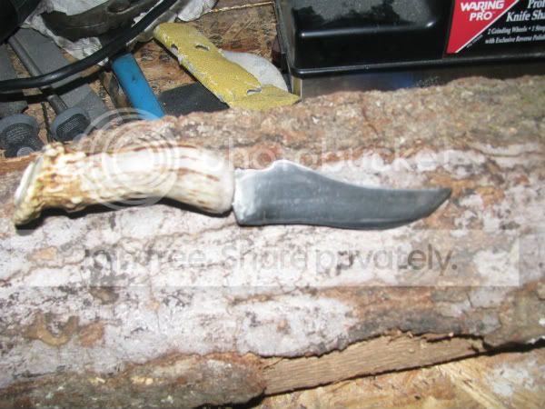

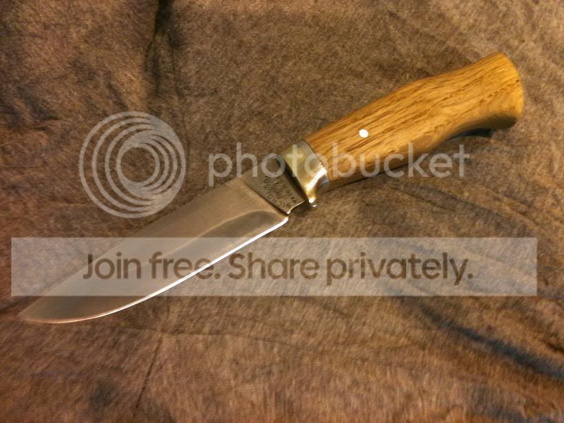

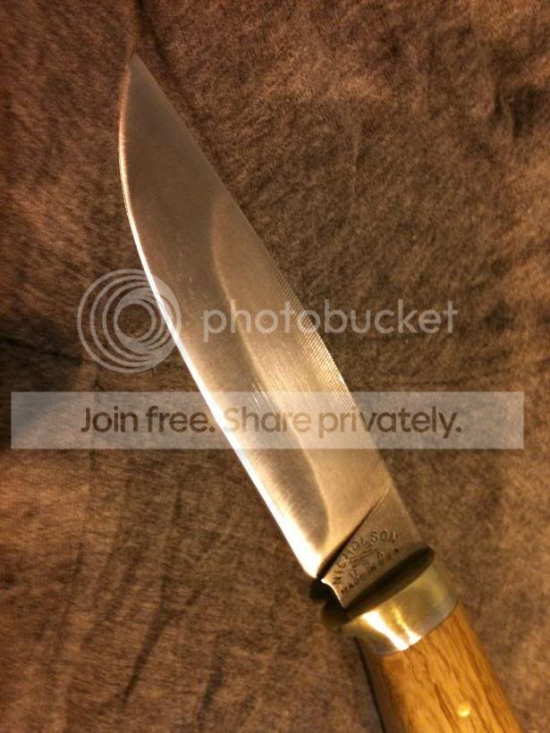

Here is my file knife. It is my second knife, I use it in the shop all of the time on leather work.
It was a Nicholson file that got broken, annealed in a bonfire, and heated to non magnetic in a charcoal fire in a hole in the ground with my shop vacuum as a blower, then edge quenched in some random mix of 10-30, ATF, and gear oil if I recall correctly. I didn't temper the blade, because I knew I wasn't going to be hard on it. It holds its edge pretty well. The scales are hickory that I made out of a broken old axe handle and some red liners and brass pins.

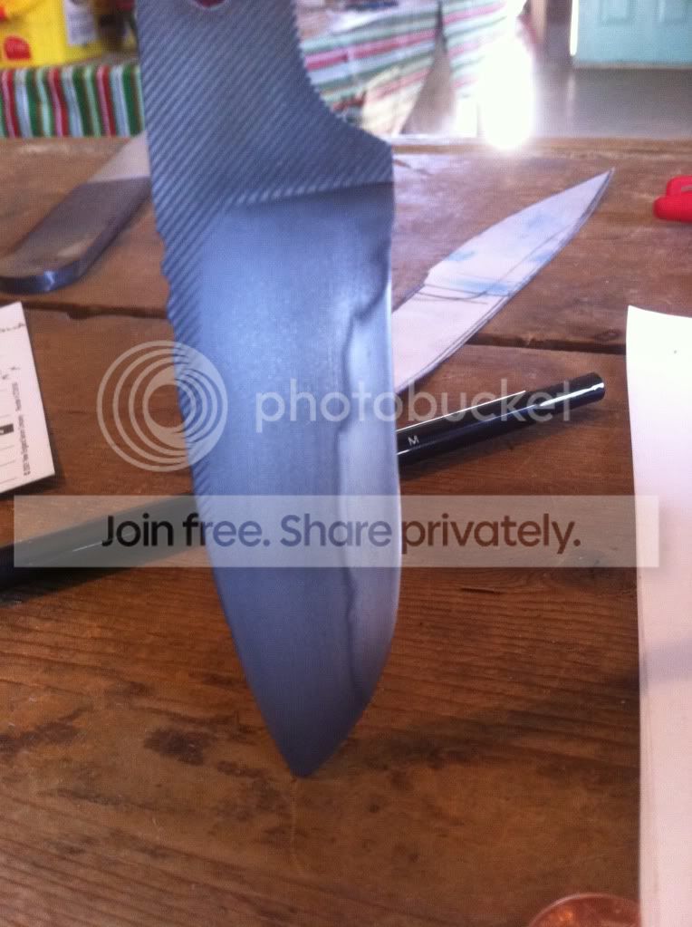

This one decided to show a crack I had previously overlooked after quench...
The crack can be seen in this photo. Yes that is my finger and thumb holding the tang...

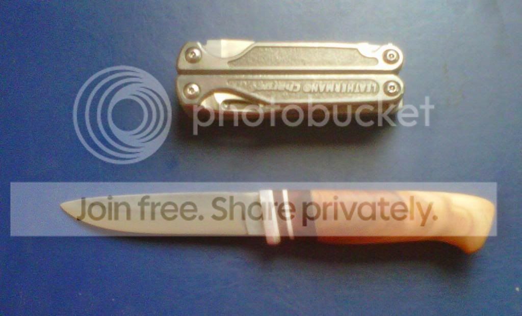

Well iI finsihed my first knife and it is made from an old nicholson file . i did learn a lot of do's and dont's on this one for sure . let me know what ya think

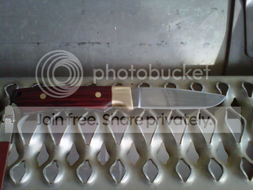

here are 3 from me. I like to make small full-tangs with hamons. these are easy and fun, and a great way to use old files. This is the kind of blade I make to relax between big projects.
these are all from right when I started. I haven't been taking pics of the file knives in the last couple of years. I guess I should take more pics. oh yeah, and make more knives!

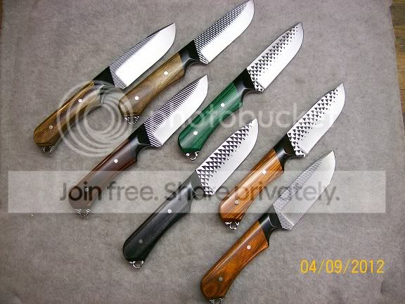

I guess I need to chime in here! These are my #1 most popular sellers at the local shows... 8 1/4" long, 3 7/8" edge...
-Michael
