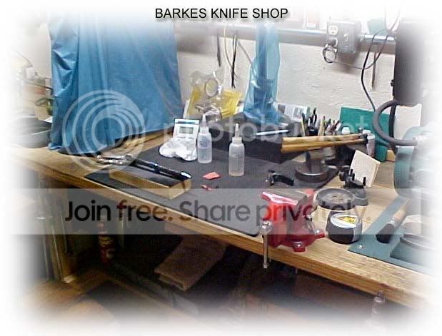

All my hand rubbing and finishing work is done utilizing this workbench. With a little kerosene and mineral oil for lubrication. Also, the next time you start hand rubbing your blade out get a piece of leather and use it for backing and pull one-way and do this 4 or 5 times changing the grit and that will get rid of the little hooks, swirls. That's what works for me. Hope this was of help. :)
