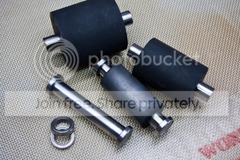

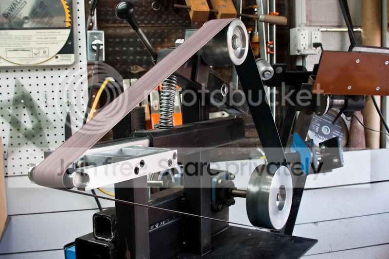

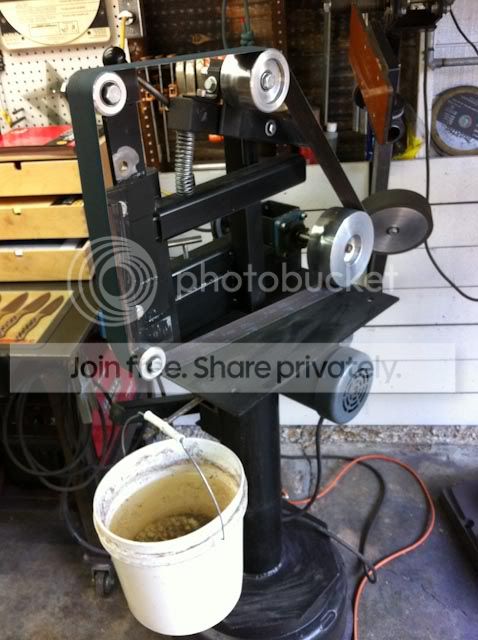

I love my NWG, I would do it all again.
Next, I would get another machine - not sure which one, though. Here's what I have so far.
I've spent as much time building my NWG as I have making knives. Here are a few views of the grinder and some of the accessories.
I love this thing. EA.
Wow Erik. Where to start.....First, could you estimate about how much money and time you have in that grinder? It looks sweet!
and, you sure got a lot of cool toys on that thing..:thumbup::D
Oh, and that stand is just crazy cool. Where the heck did you get that?
