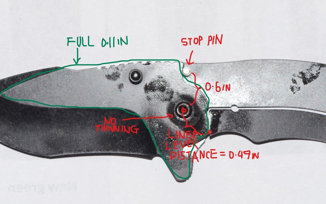

This is a very simple job for a knife smith, but this is my first time. So I have to do a lot of thinking and planning.
I bought 4 cheap knives($13ea) that looks to be very robust for a 3” blade and for the weight. The blades come very sharp on all 4, no accident on this. Sharper than my Cold Steel and many of the Steel Will knives. It's the sharpest out of the box out of over 2 dozen of knives of different brands. Also, I compare the hardness of the blade by hitting the spine of two different blade to see the size of the dent. I do NOT believe they will heat treat only the edge of the blade and not the spine. Most likely for small folding knives, they heat treat as one piece(if they even heat treat).
Good thing is even it has ball bearings pivot, they did not thin out the blade or the liner to fit the bearings, so there's no weak point at the pivot. The spine side of the blade is of full thickness to about 3/4" from the tip that make it strong and harder to break when use for prying. Also another thing I like this knife is the flipper tap is very long, it serve as good protection of the hand when thrusting into a hard object. This is the internal picture of the knife.
[/url
From the internal picture of the knife, you can see the distance from pivot point to the edge of the liner lock distance is 0.49" as shown, which, is longer distance than a lot of knives particular only 3" blade. This make the liner lock more secure and stronger. I want to change the ball bearings to bronze washer to make the knife tougher.

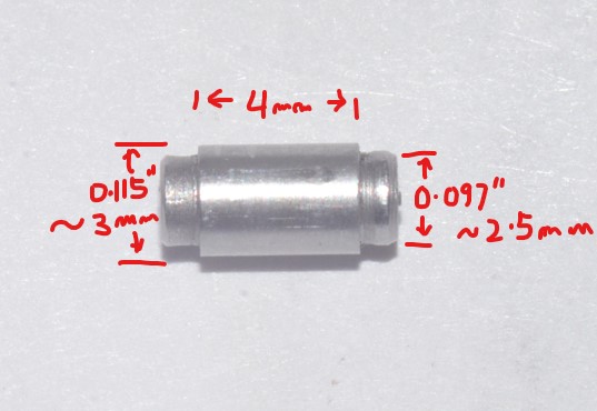

Problem with this knife is the blade stop has diameter 0.1” on both ends to fit into the liner as shown, the middle is 0.116” as shown above. So replacing with bronze washer would make the distance between the liners at the pivot point thinner than the blade stop pin as seen in the picture below, the pivot and blade stop pin is very close(0.6” apart) as shown, this make the distance between the liners uneven and the blade is wobbling sideway no matter what. I have to replace the blade stop pin. I chose a straight pin with 0.116” diameter dowel pin. I have to drill the hole on both liner plates a little bigger to accommodate the new pin.
It's quite an effort to drill. I step increased the drill size to step up to 0.116" in 2 steps to make it easier to drill through each step. IT WORKED. . I can feel the hardness of the liner when I try bending the liner lock out more to give it more a secured lock, together with how hard to drill, I conclude the steel of the liner is very good. Broke a few cobalt drill bits in the process.
The dowel fitted very snug, I use 1 bronze washer on each side of the blade with one at 0.01" and one 0.02". The original ball bearings were 0.03" thick each side. I literally took out 0.03" to make the linings much closer to the blade. The finished knife is smooth in opening, no side way movement of the blade. Everything is tight just like when the knife first came with bearings. It is a success.

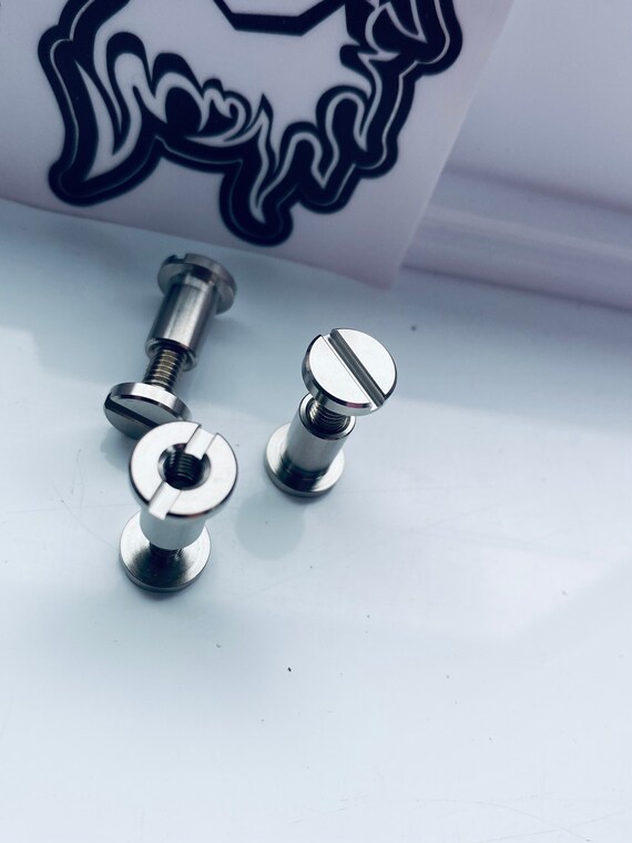

Take a look at how Strider and Hinderer do their "thru-pivot" bolt arrangement. IMHO "bottoming out" is a really difficult way to go.
What is that? Do you have any link? I did a quick search and can't find anything. Might be something I can learn for the future.

😁 Actually it is the opposite of what you are attempting - there IS no bottom. But it allows for maximum amount of thread engagement, which I believe is what you mentioned regarding strength.

If you look at the internal picture in the 1st post, I specifically labelled "LINER LEVER DISTANCE". There is physics behind this as LEVER action where the longer the distance, the less stress it put onto the liner. If you look at a lot of knives, a lot of them has very short distance in the 0.3" range. This one is particularly long of 0.49". I am still working on how the angle with respect to the pivot affect the outcome, but in general, the stress on the liner lock is 1/2 when the distance is doubled. The longer the "LINER LEVER DISTANCE", the less stress is on the liner. Actually looking at the picture on this is one of the reason why I took the chance to buy the first one to see. You'd be surprised a lot of so called "SURVIVAL" knives with thick blade, heavy and tough looking have very short "LINER LEVER DISTANCE" LIKE 0.3" or less.

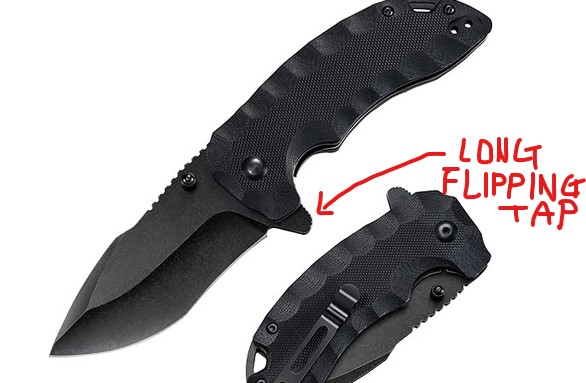

Look at this survival knife, heavy, looks tough in the picture. But when I opened it up, looke at the "LINER LEVER DISTANCE" is ONLY 0.34" vs My knife of 0.46". Another thing is from pivot to the blade stop pin is only 0.46" vs my knife of 0.6".
You can see the tough knife put a lot more stress on both the blade stop pin and the liner lock.(assume the pivot angle is same which it is close looking at the picture).
It's not just the cost of the knife or what it advertised to be. One has to really look at the design. I put my bet on my cheap little knife over this heavy tough looking knife even though the liner is slightly thicker ( 0.01").
From calculation 0.6/0.46=1.304 times on the blade stop pin. 0.46/0.34=1.353 times on the liner lock when comparing the two. So even the cheap knife is smaller and thinner, BY DESIGN, it has about 1.3 times advantage over the heavy tough knife.
Also notice on the heavy knife, there is a big hole right under the thumb flipper tap at the base of the blade? That really weaken the blade when comes to prying. Look at the little cheap knife, sure the blade is thinner, but there is no holes on the blade.
Another thing, the liner of the cheap little knife has no cutouts to reduce the weight, the big heavy knife has cutout. That weaken the liner also. So even the thickness of the cheap knife is 0.045" thick vs 0.055" of the heavy knife, I am not sure the heaver knife as advantage as the blade is 3.5" long, that put more stress than a 3" blade on everything. Again, this is LEVER action.
