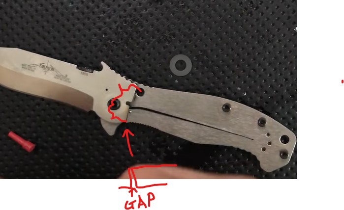

Look at this knife, over $200, this is the closest to what I want, tanto blade with thick blade all the way to the tip. strong liners, no weak point at the pivot, not using ball bearings. The Lever distance is OK.
BUT, look at the picture carefully. there is a gap in the wrong direction where the liner lock engage the tank like I drew. THIS IS BAD WORKMANSHIP, FOR A $200 KNIFE.
You still think paying more is better. I'd bet on my $13 knife any time of the day over this one.
Here is the video. The image is taken at time 16:31
I didn't get that.
I just happen to find a disassembly video of a very expensive knife that potentially fit what I want in the design in post #26. BUT you see the gap between the tank and the liner lock? It's not as bad if the gap is on the opposite end, but this end spells disaster.
Of my 30+ knives that none is close to that price, I yet to see such SCREW UP. They have no quality control. So much for an expensive knife. All my cheaper knives engage at that end of the liner from looking at the wear mark( I actually use marker on the liner, put back, open and close many times, then check the wear on the market to make sure the angle is correct). This is too obvious a problem they should have caught.
That pic is of the knife half disassembled, no? Yup, there's going to be gaps when you do that.
Look closely, blade on pivot, AND you can clearly see the stop pin hole is perfect alignment with the blade stop point.
This means the blade is in perfect alignment already. look at the gap at the bottom compare to the top. the top tank is touching the liner lock, BUT THE BOTTOM HAS A GAP. IT IS SO OBVIOUSLY OFF.
You think I don't take all these into consideration before I posted? Look carefully again,.
I don't think you have enough knife experience to know that a disassembled knife ain't gonna line up. If the gap is there when assembled, then we have something noteworthy.
This is where you need to recognize, many people here have way more experience than you. How many knives you disassembled? I've got a few hundred under my belt, and others here have way more. I can tell you 100% that you cannot draw the conclusion you have from a screen shot on the internet.
