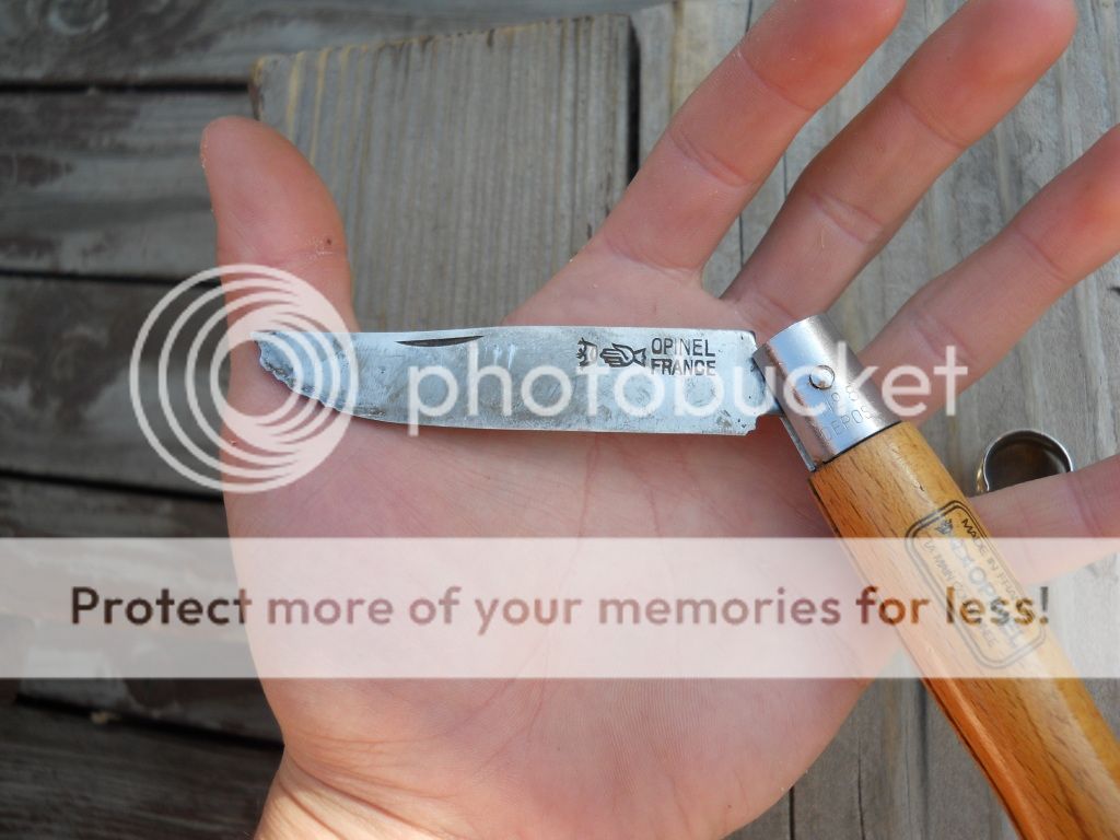

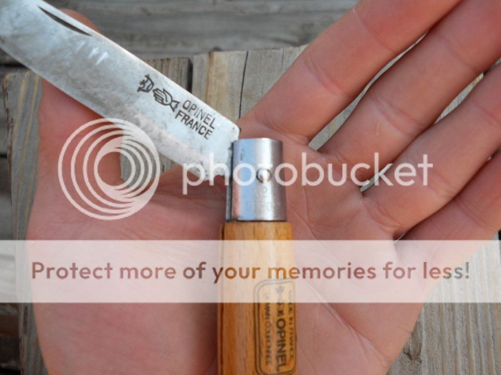

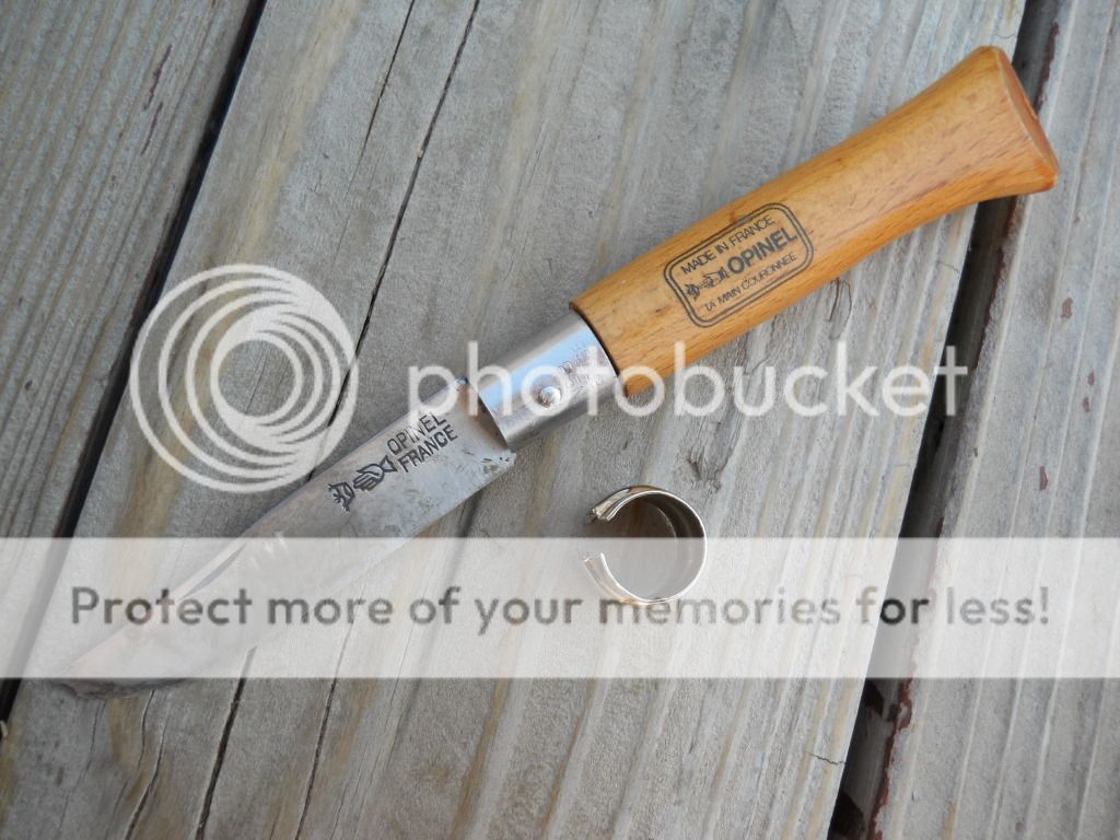

Here is my 'new' Opinel

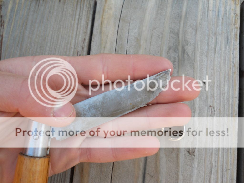

As you can hopefully see, the edge is heavily damaged and needs some work...
Some blood on the handle and inside the knife :eek:
In my quest to fix up and personalize this gift, I have a few questions as to how I can accomplish some of the things that I want to do. As you can see, I already have the ring off already. I have also gotten most of the rust off of the blade and ring, but there is still some in the inner workings of the pivot pin area that must be taken care of. I would like to remove the pin, clean up the blade, clean the blood on the inside of the handle, reshape and waterproof the handle and work on the blade. At this point, I am stuck though; I do not know the best way to remove the pin without destroying it so I can continue.
With this I have some questions...
-How do I remove the pivot pin without destroying it?
-If I have to replace it, what should I use as a new pivot pin?
-How should I clean the blood from the inside without removing too much material?
-What would be best to use for waterproofing the handle after sanding?
Is there anything else you can think of that I could do with this old girl? I will keep everyone updated on my progress in restoring and modifying this gem; I cannot wait to see what becomes of it. Anything you guys want to say, add, suggest, criticize, etc. is more than welcome. In fact, I encourage it.

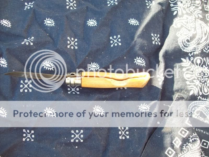

If you're going to reshape the handle you might want to file a notch in it like I've done here to aid opening. Nice story. Thanks. :thumbup:
I definitely want to take a whack at an 'easy open' notch. Tell me, how comfortable is the notch when you are using the blade?
i need to post a pic (actually i need to take a pic or three)
i tried to carve an EO notch on my Opinel
ummm, i went way to far...less is more in these cases :D

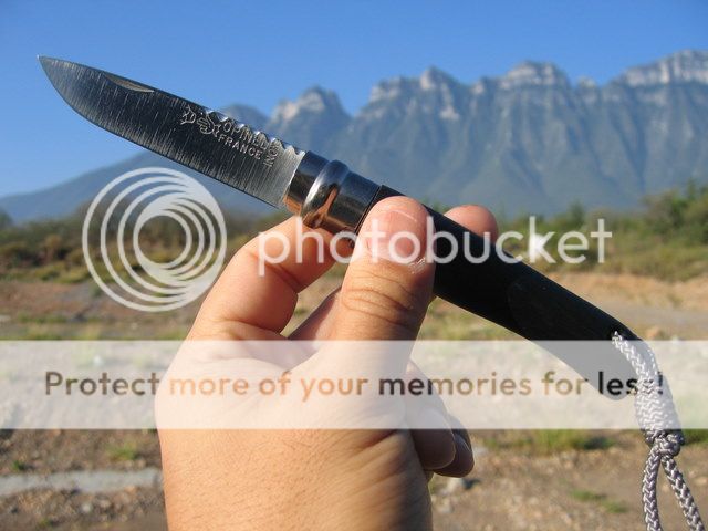

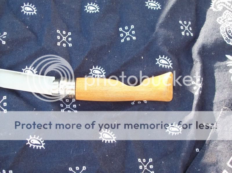

I really want to do an EO notch, but this pic I found may be my inspiration as to how I want this old girl to live the rest of her life.
What would you think if I sanded down the handle like this? Would you think it would be enough for me to open it similar to how you are able with a EO notch?
(Pic not mine of course. All credit goes to the OP; and the OP deserves a lot of credit IMO.)

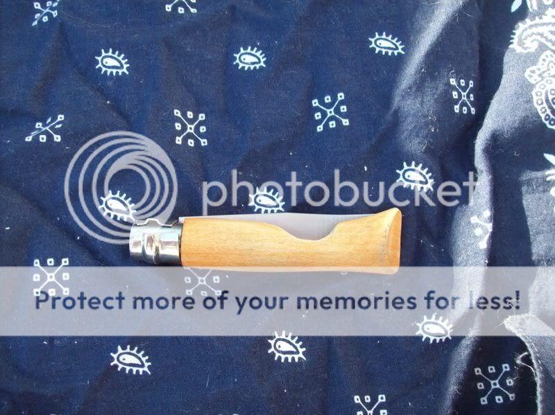

but i DID get off my rear end and take some pics
now, i am not done, just getting started really, i wanna reshape the handle some more
and i got some stain for the wood when i am..i'll have to take some before and after pics i think
anyways, here is an example of "going too far" when carving EO notches :D
the thought was, "big enough to use while wearing gloves" :rolleyes: ah well, practice makes perfect
Thank you for the pics sir! I bet that when you begin to reshape the handle, you can smooth out those lines and come out with a wonderful shape. A blessing in disguise perhaps? :D
perhaps, perhaps
i am a little unsure about how to shape the handle the way i want
i actually am kinda digging the handle shape you posted above, might have to think about this a little more :p
For the pivot pin, I found this post in an old thread here ---->: http://www.bladeforums.com/forums/showthread.php/380971-taking-apart-an-Opinel
I've done it several times now.
With a pair of needle-nose pliers, grasp the locking ring where the raised ridge meets the open slot, and pull it out away from the handle, and also toward the end. It should pop up over the pivot pin, and off the end.
The pivot pin can be difficult. It's basically a rivet, with a large round head on one end, and it's pounded at the the other to keep it in place. If there's enough of the end showing, you can try filing off the excess to make the next step easier.
To remove the pin, use a hammer and punch. (I use an old drill bit shank that happens to be the right size.) Drift the pin out through the handle and blade tang, and then remove the inner (non-rotating) ring around the end of the handle. The blade will just fall out of the handle slot.
That's it. Not many parts on an Opinel. ;)
Reassemble in reverse order. Don't worry about hammering the end of the pivot pin/rivet; the outer locking ring will keep it from going anywhere. Getting the ring back on is harder than getting it off; I use the pliers as mentioned above, and also a large flat screwdriver to slightly open the ring up at the slot a bit. Pull the edge of th ering away from the handle to get it over the round end of the pivot pin, and it should just pop into place.
If the locking ring is too loose, remove it again, and squeeze it more tightly closed with a large pair of pliers, then carefully reinstall it, taking care to not open it up any more than necessary.
That should do it!

Well, anyway...while I figure out my pivot pin predicament, what would you opinion be on using a dremel to modify the tip to a drop point? As you can (hopefully) see by my pics, I have a lot of metal to remove anyway to fix the edge.
I'd have some reservations about using a Dremel to alter the blade shape, only because it would need a very steady hand, and might overheat the steel. I think if I were doing it, I'd do the rough shaping with wet/dry sandpaper against hard backing, like glass. It would take longer (then again, maybe not, if compared to the dremel), but would give much better control of everything. With the edge so heavily damaged near the tip, I might just file that damaged steel away, either with the paper or with a file. If using the paper directly against the edge, you might 'blunt' the edge first, so the paper doesn't get cut too easily. Silicon carbide wet/dry paper takes metal off fast, and at very coarse grit (220 or lower), should work pretty quick for the rough shaping, especially on this relatively small, thin blade of good ol' carbon steel.

That Opinel has seen some heavy abuse, but it's salvageable for a usable knife. I'd go for a heavy spear point on that blade.
