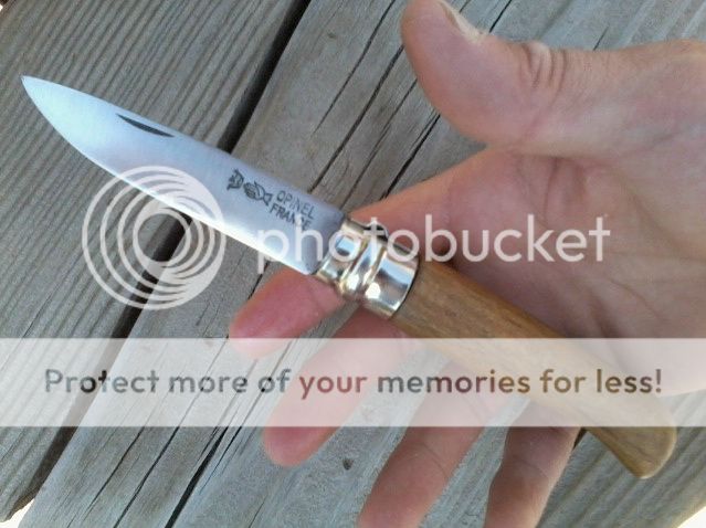

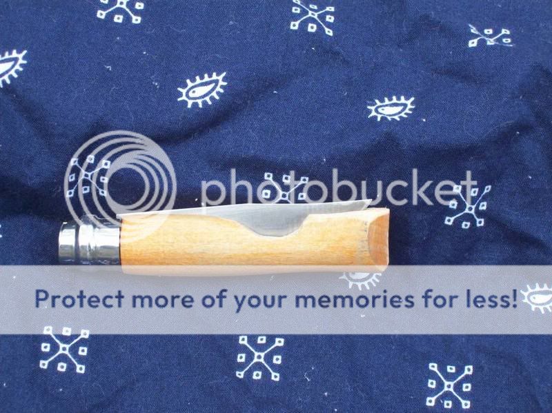

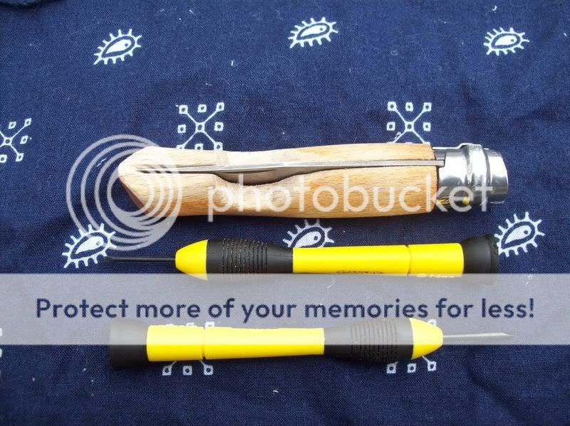

well, seeing as I am an unemployed househusband at this time, i took a break from doing chores and took a few pics for ya
hope this illustrates what i am talking about better
I'd just start digging in that blade recess, using one of the methods in my earlier reply. Might take a while; that's quite a lot of exposure there. With any luck, the blade is resting in the area near the tip only; there's more room there to dig deep, if you have to. My main worry is if the whole blade edge is touching, or very close inside. That'll take a lot more work, if so. Also depends how much wood there is between the bottom of the recess, and the back of the handle. Might use a ruler to figure out how deep the recess is, compared to the handle thickness, and how much the blade needs to be lowered to fit. Another possible issue might be the back of the blade edge pivoting into the edge of the ferrule inside. If the blade hits the ferrule before it's low enough, there won't be much else that can be done (save for grinding away the rear of the blade's edge; probably more trouble than it's worth on a $15 knife). That, or reshape the blade's tip as a drop point.

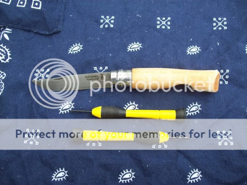

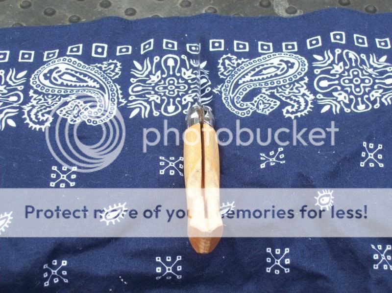

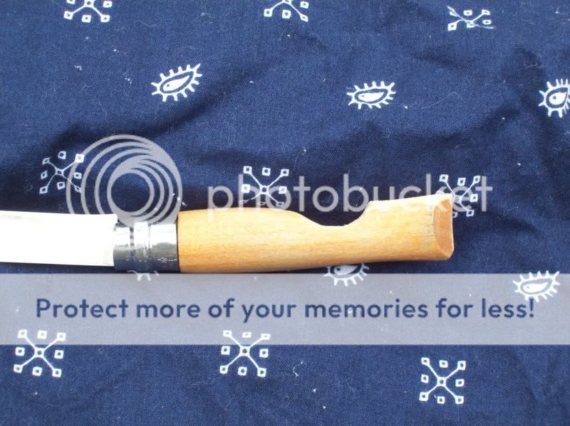

ahh hah! i managed to fix this little problem
tried a couple things but what finally did the trick, is i have this set of TINY screwdrivers...really small.
basically just carved the groove deeper and deeper till it fit right

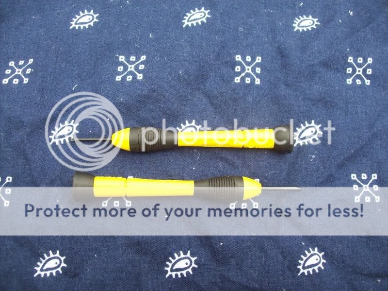

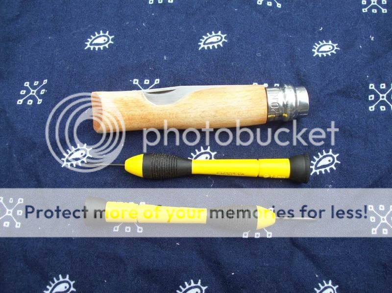

ok here we go
first here are the tools i used to chisel out the groove
and a few pics of the knife with the tools for size comparisons
and the money shot i suspect :p

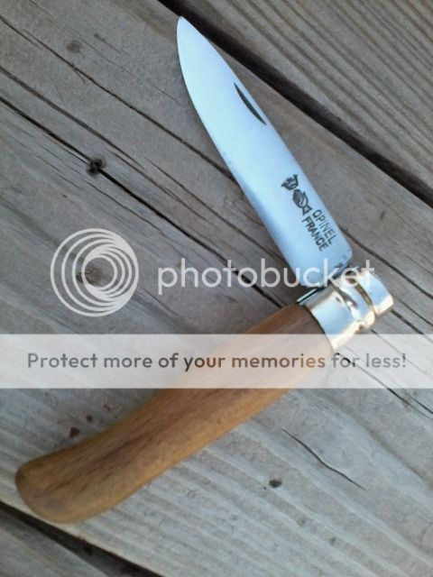

Alight guys and gals, my project is finished!!! I apologize that it took so long, life kinda got in the way :o
The crappy cell pics do not do justice at all. I would have better pics, but my camera crapped out on me :mad:
I hope you guys enjoyed this little journey with me. If you have any new ideas, questions, criticism, etc let me know!!
