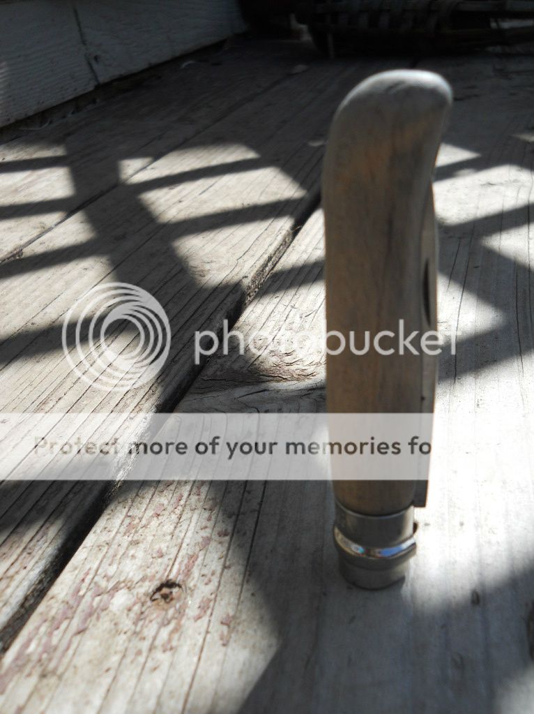

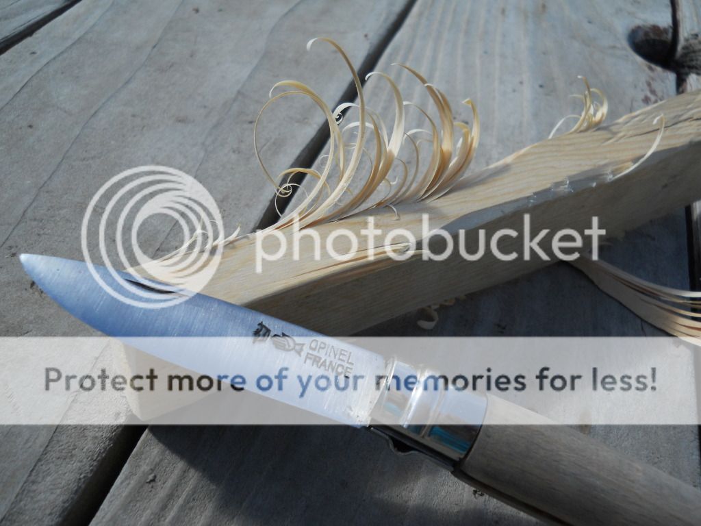

Alrighty, so, I spent a good portion of my time yesterday restoring the blade and sanding the handle of this old No.8. After you guys gave me that push to ignore the pivot pin, I used my Swayback Jack to whittle (VERY SLOWLY!) the general contours that I wanted in the handle and to get rid of the blocky figure; she has curves now :cool:. After that, I took the spine of my BK14 (yeah, yeah, it isn't traditional :rolleyes:) because the squared spine took off the gloss much more quickly than the sandpaper. When all of the gloss was off, I sanded her down to my liking. When I finished the handle, I moved on to shaping the tip and sharpening.
I used a mousepad and 80 grit sandpaper to get rid of the chips, rolls and kinks in the edge in a short period of time. I actually tried the nessmuk idea out since, if I didn't like it, I would have to remove that metal anyway for a drop or spear point. It actually looked fairly good, but I knew I wouldn't like it as much as a drop point, so I took it off (sorry, I should have gotten pics). I rolled the edge accidentally at the end of shaping when the blade cut through the sandpaper :eek:. Aw well, I just get to perfect my technique again!
I really like how she is looking so far. As much as I was obsessing over making the handle black, I am now pondering whether or not I could keep this color, waterproof it, and retain this matte look it has going on. Why I am having these thoughts is because, when I was shaping the point, my hands were covered in metal dust and my sweat made it stick to the handle. It had I really amazing 'Earthy' look to it that I adored, but I sanded it off for obvious reasons.
I am still deciding on the EO notch simply because I do not want to ruin the natural looking curves of the handle. I may sand down the front so the notch is more subtle, shallow and long.
I am also debating whether or not I would like a lanyard hole...so many options :rolleyes:

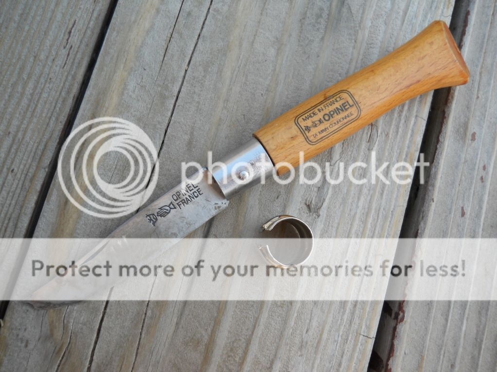

Well, let's get to the good stuff, shall we??
Here she is before:

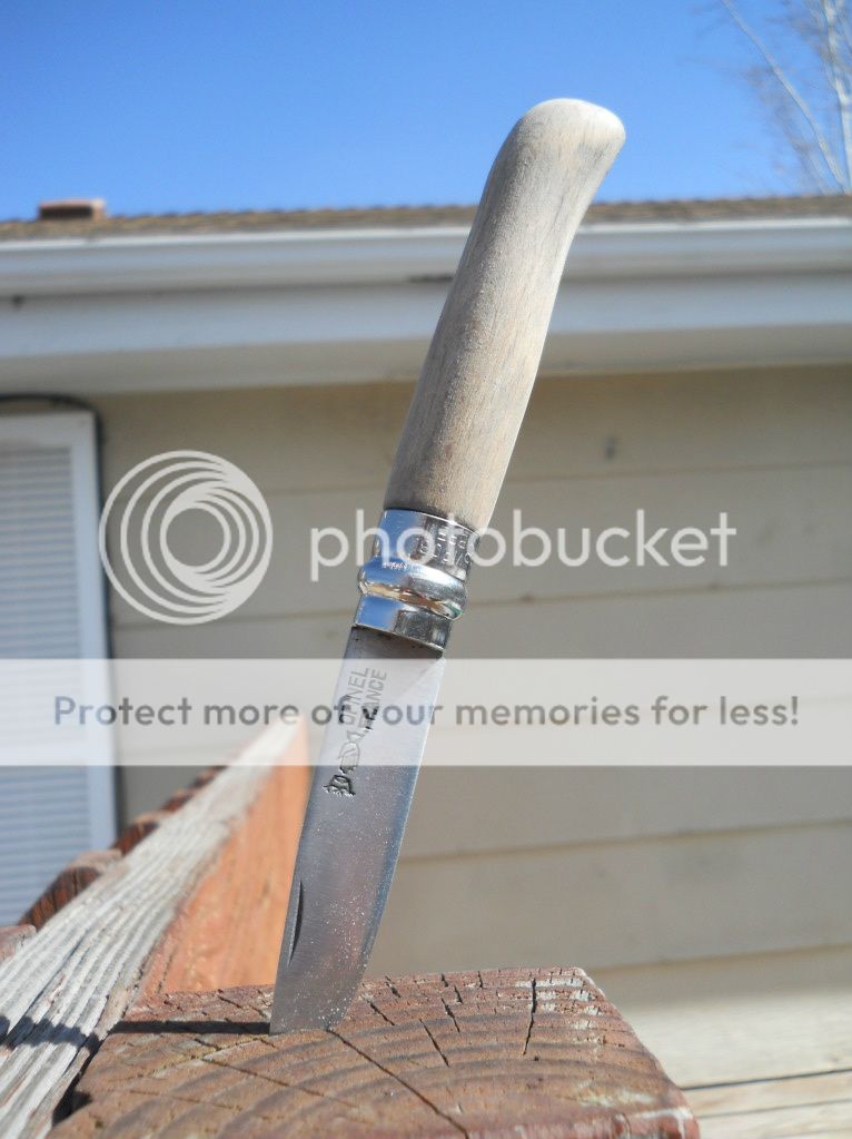

And here she is now:
So, I hope you have enjoyed this transformation so far. I know it is not much, but I don't want to go too crazy and mess up a knife that means so much to me. I really want the handle to have some deeper, darker, matte 'Earthy' tones to it; I just don't know how I want to do it. Is there any way to waterproof or seal the wood without a glossy finish? I am also wondering how I should go about giving the handle a more natural and subtle 'Earthy' look that I am looking for...any ideas my good friends??
I have said it before, but I am beginning to truly appreciate knives with thinner stocks and convex grinds. I have always had a place in my heart for them, but this experience has solidified that feeling. I really want to convex all of my knives that I haven't already gotten my paws on :D
Also, with how my post high school life is starting to look as it unfolds, I might do what I can to start make this a long-term hobby of mine. Hooray for seasonal employment!!
