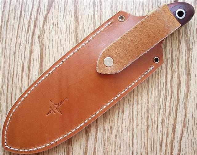

i like those sheaths too. do they have beltloops on them?

Yes! There is a belt loop on there!
