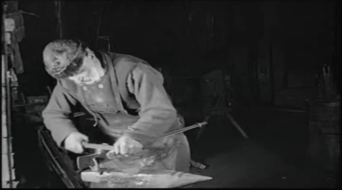

Came across this 1923 film from Sweden on Facebook.
Link: http://www.euscreen.eu/play.jsp?id=EUS_11F056F290054E4E859759AAC04EA24B
I wonder if they were made in a different way in Finland.
Bob
Bob,thank you for posting this,a Monumentally Classy video....
My opinion is that even at the time of the filming the shown technique was a couple hundred years out of date...That's WHY they filmed this guy,who,i imagine,was one of the very last practitioners of the Old ways of forging those axes...
That guy is not just good,he's a Fantastic,Superlative hand at all that...And yes,that's pretty much the way Finnish axes were constructed as well,maybe barring that poll forged out of the main body,that is WAY arcane...
The old helve hammer in the back may or may not have been in industrial use then...Those things Are surprisingly effective,for doing Just that...
He's swinging a big hammer and making every blow count. That guy knows his sh!t and has done it before uncountable times. He's a badass.
I had to watch the welding of the bit several times. Not an insert or an overlay. He just stuck some steel on the end and shaped it! Watching him relieve the poll from the bottom of the socket was amazing. He used his same hammer - that square-poll cross peen. He moves steel like Hofi. I bet he could sharpen it with his cross peen if he wanted.
Very cool watching him use a hardy fork as a vise. He slipped a ring over his tongs to keep them locked then used his hip to pressure the axe in the fork to lock it down. He didn't just come up with that move this morning.
Video - awesome.
Commentary - awesome.

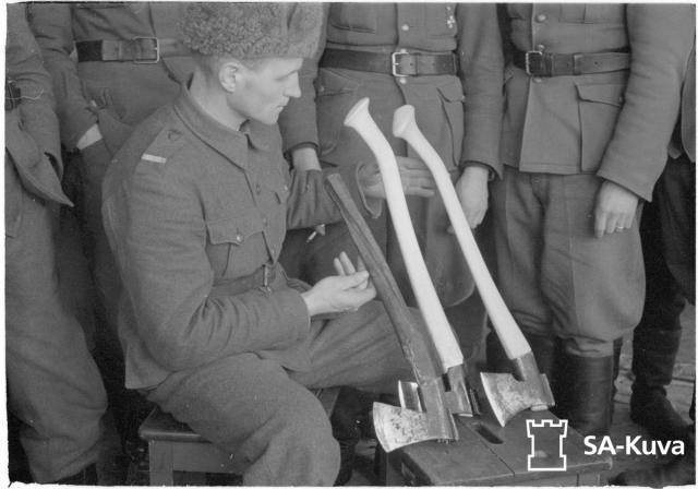

Finnish Army issue axes
I was looking more closely and took noticed that the Kellokoski stamp is sometimes directly underneath the model # and the MB Crown as well as further down the cheek closer to the business end.
The 13? in the video that Bobscreenshot has the mark higher up:
And then another example I have here has the mark farther down the bit:
I wonder if the change in mark placement might indicate a time frame to place the manufacturing date somewhat? That is something that really only a Fin could tell – and probably only if they were axe crazy…
From what I am reading, Finland didn’t have an official army until 1940-1941. Before then they operated the Civil Guard known as Suojeluskunta or Protection/Defense Corps.
Long story short, upon creation of the official Finnish Army in 1942 they started marking their Mosin Nagants with an “SA” in a box. Too many variations in stamps there to get into and would be another great topic maybe not BF/axe-centered. SA stands for Suomen Armeija (Finnish Army).
Rifle-oriented info on the Civil guard from mosinnagant.net:
http://www.mosinnagant.net/finland/thecivilguardoffinland.asp
Anyway, I thought if they started the official army that year and marked their rifles as such then maybe they did that as a designation for other gear as well – issued axes in this case.
https://en.wikipedia.org/wiki/White_Guard_(Finland)
Here is a Kelokoski 12.3 and “C” below that and is marked SA on the flip side. There is a “P” under that there as well.
https://flic.kr/p/Wa8kaL
So, I am thinking that if one of the axes is marked “SA” then it is 1942 and on. I don’t know how long they marked the 12.3’s with an SA or when the military stopped or changed their gear marks. What I do know is that they stopped producing that style of axe with the old numbering system in the late 50's or early 60's. At that point they focused on the new stylings and manufacturing methods of Fiskars (insert technology…) They also redesignated the model numbers.

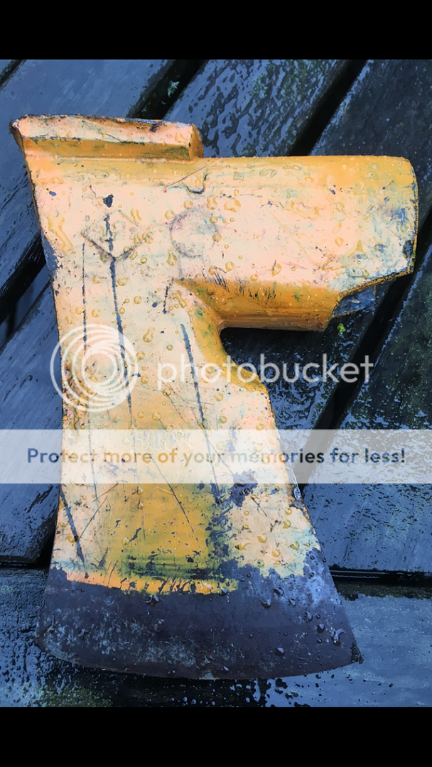

Head on a stick this morning:
This afternoon:
