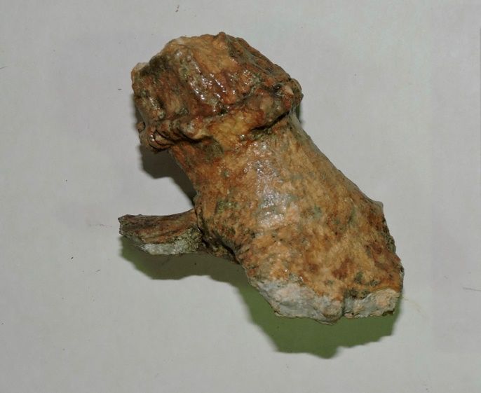

300six's likening to an antler growing out after a shed is pretty close - the pedicle (I had to look that up):
It's the base of the discarded antler I was talking about and not what re-grows from the ungulate critter's head starting a few months later. A foundling Caribou (sorry, Reindeer) antler might make for a dandy axe handle in a barren land or mostly stunted tree region!
