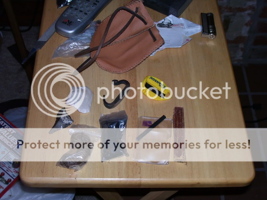

Here is my external kit that goes on my pack, four methods of getting a spark/coal
My KSF fire-wallet - nice little flint and steel kit
Here I am busting out a coal - first time bowdrill under the tutelage of DocCanada

I figured I oughtta put up a pic of my fire kit... It's not the greatest:o but serves what I need it for..
In it are a couple of pieces of flint, firesteel, charcloth, waxed jute, a fresnel,
Fatwood, and a large pencil sharpener(saves my knife and finger for other things)...
I also have a rope lighter similar to the slow fuse, but made with waxed jute.. That's in my EDC...
