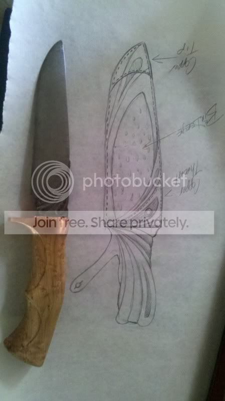

Thanks Charlie! I will say that without all the great inspiration from fellow members here, this would have never happened. Hopefully the leather shows up today, i have some cool plans for the sheath. I am going to do a windowed sheath with a slice of the birdseye in there to match the handle, and a sewn in copper tip and possibly throat...ish. I will draw a quick sketch so you guys can see what i am rambling about.
Ok got it drawn. Here is a real rough first draft/design kinda like what i want to do.
What do you guys think?
you really captured the spirit of the design Mike, I must say!
Can't wait to see your leather work, that's very ambitious.

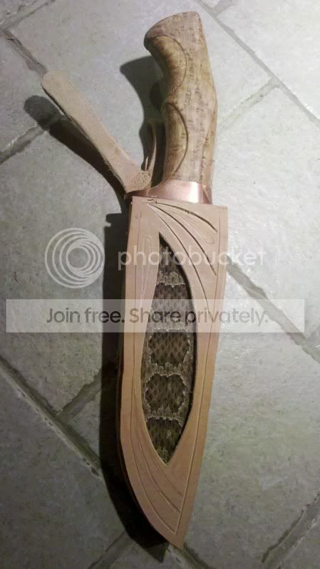

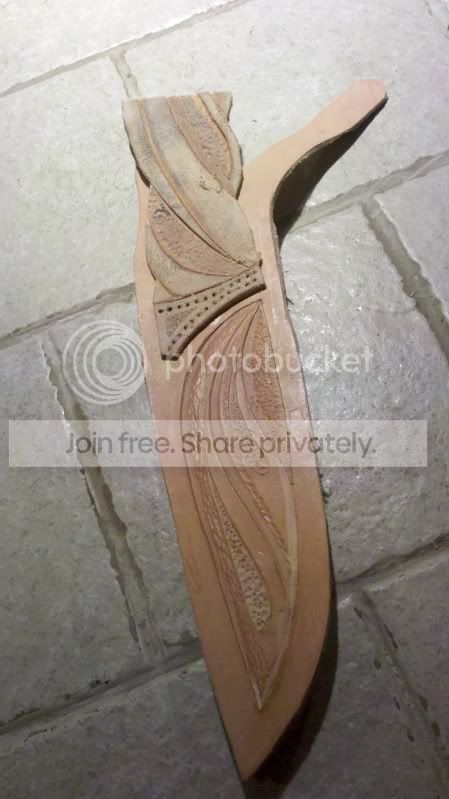

Ok so i screwed up the sheath....Apparently i just need to buy a sewing machine....I tried to drill the holes on my small drill press....With a bit that small, apparently they tend to wander. So...I started over. I made sure to make all the holes in each piece BEFORE i put it together. I guess never really doing this before, i should have bought a dvd lol. I am not sure if i will window this one...Probably still will, but now i know that it takes some fore thought to make a sheath lol.
I use my press to drill my sheaths, but I stack everything up and hold it together with 2 sided tape. I drill slow and deliberate and get almost no wandering now. I liked the look of the sheath I think if you have the time you should give it another go:thumbup:
I never got on well with drilling my sheaths, for that very reason. Always use an awl now.
I never had much luck drilling stitch holes in sheaths either. Plus, I prefer the look when you punch them because the hole will close back up some around the stitch. When you drill, it actually removes the material and leaves a permanent hole that won't seal up at all. I got a punch from Tandy that you can hammer through the layers of leather much more easily than just pushing it through with a hand awl.

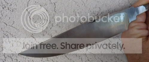

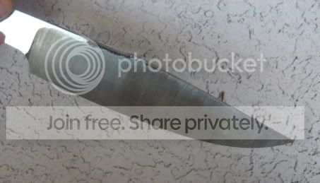

OK, I'm still in big trouble with the deadline, but I at least finally got my blade rough ground prior to HT. Not the prettiest grind, but I was rushing and using a somewhat dull belt that was close at hand. I hope everyone is making better progress than I am!

Paul, It is great to see your progress photos. I am really hoping you make the deadline
Ok i have all the pieces ready to go! Now i have to window it and tool it. I did a lot more practicing on my tooling. I think this one be a bit better than the last. I little different from the last one, but it is going to be cool :)
