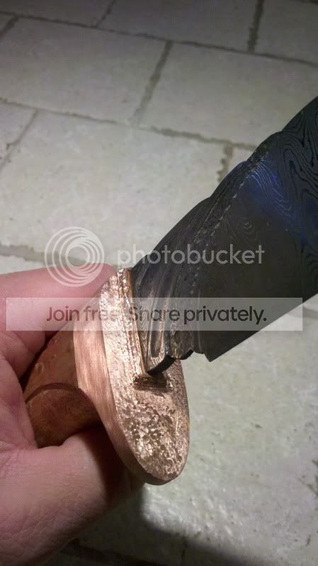

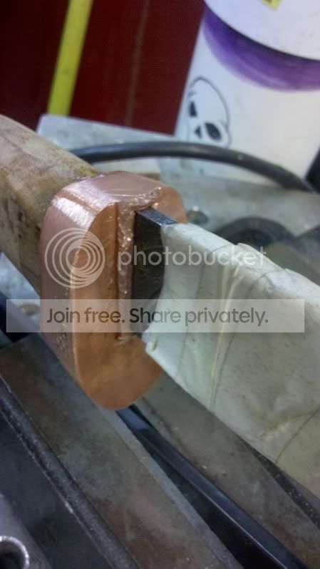

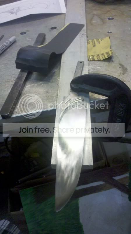

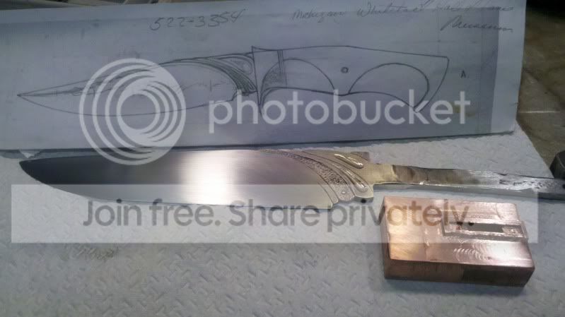

Ok so i finally managed to get some shop time in. Here is where i chiseled out the guard to do 2 things. One i can drop the blade down into it about 1/16th of an inch. The other, i stepped it on the mill and hammered it onto the blade, making a 99% gap free fit. Also with the carving i have in mind, the step is going to be pretty cool.

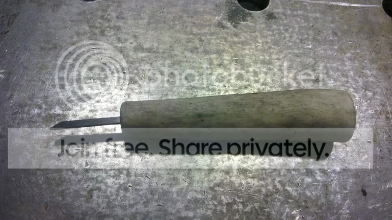

Here is the chisel i made earlier today to do this. O-1 and antler...silly

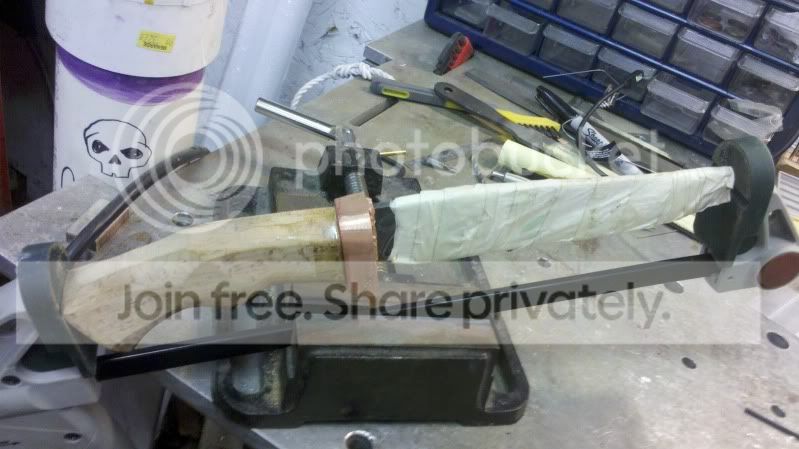

Final sanding of the blade before etch.

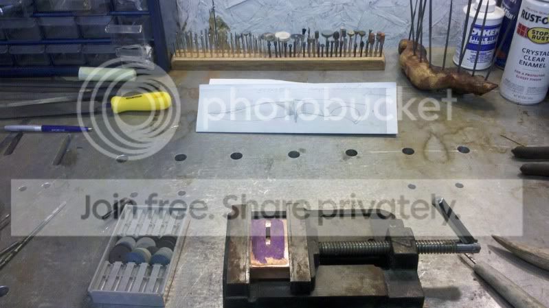

Here is the guard and blade, along with the drawing i did over Lorien's design. Trying to keep to this...

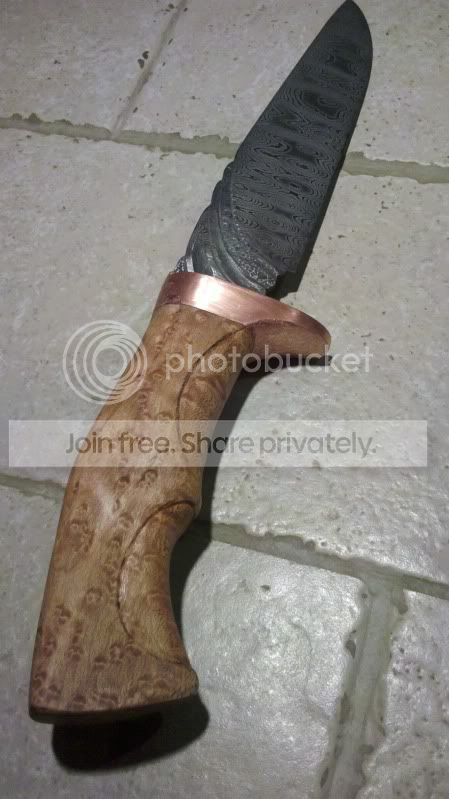

And here it is now... Too tired to keep going on this, don't want to screw it up lol.
Finishing this beast up tomorrow. Thanks for looking :)

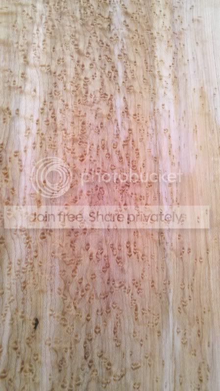

Mike that is Cool! The guard is going to look great, is it Copper? I like the "Silly" chisel too. You should take some copper wire and pound it into the groves on your blade engraving! what are you using for spacers between the guard and handle material? what kind of wood is the handle. Have I asked enough questions? Looks Great.

Thanks Ryan. I have some annealed copper wire i plan on doing some inlay in the handle. Yes, guard is copper. Didn't use any spacers material...Wanted to, but didn't have any lol. Handle material is a pretty wicked birdseye maple. I have some minor adjusting to do to the handle. It fills the hand for sure!

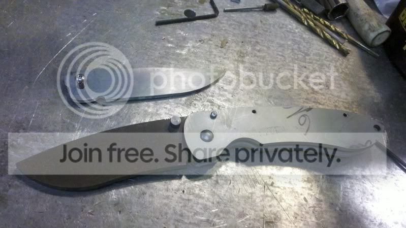

Ok here is a few in hand pics. Had to wait overnight for the epoxy to set so i started working on a folder to pass the time lol. anywhoo here is where i am at. I need to do alot of handle profiling yet, and carve the handle/guard. This should be done later tonight....Thats the plan anyway.
And for shits and giggles i thought i would post the framelock. It is a bulldog kit from Tracy at USAKnifemakers supply...Dont let anyone tell you it can just go together...No way..

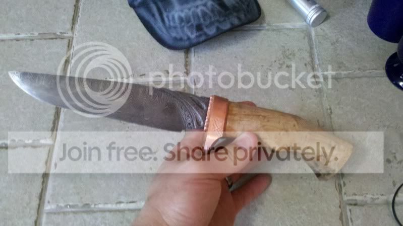

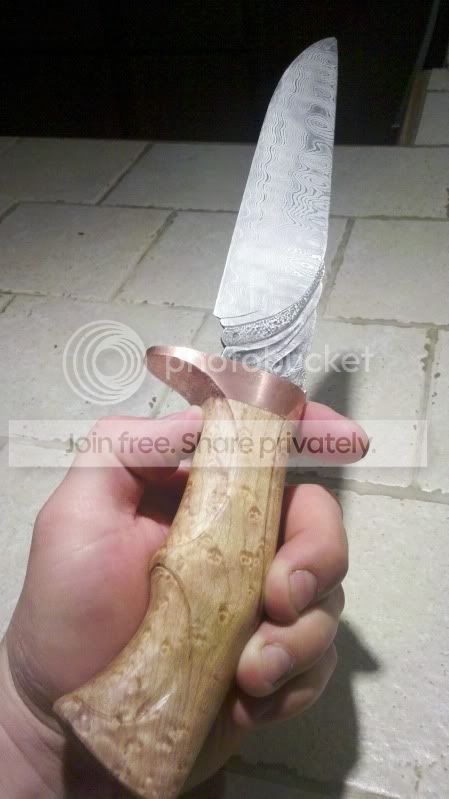

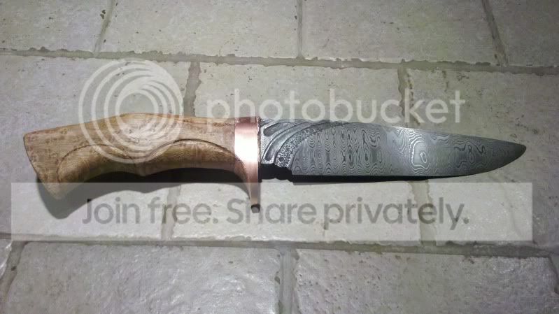

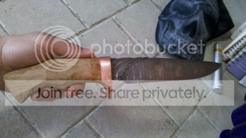

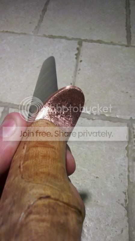

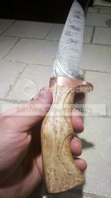

Ok well....Here is as far as i got today. Guard needs a patina...Not sure if i can get the chemicals locally, but am going to try before work. I have a little more clean up work on the handle, but considering it is only my seventh knife, i guess i can be happy with it. I sanded the damascus a bit more, gives it a cool semi polished look. Sorry took a lot of pics.
#7??? Wow man, nice work!
I don't believe that is your 7th! but OK! I Really like how you tied the guard into the handle, I didn't understand on your design drawing. but that looks amazing. What are you going to use to Patina the Copper.
Hmm... Gars and Ribs, too bad you are so far away. We had snow yesterday so I am really chomping at the bit to get outside (And be warm)
Yes, my 7th actual finished knife. I have a few that i didn't like the grinds on and pitched them. Yeah, too bad you are far away Ryan, it is 90* here :) Thanks Lorien, i know you are a pretty good judge of nice custom's, makes me feel like i did something right lol. There are a few things with the knife i am not too happy with, but it is a little late to change them now. I planned on getting some Liver of Sulphur, but looking like i am going to have to order it. I guess i probably should order some stuff to make a sheath also....I was thinking about a copper throat and tip but think i am going to do it a bit differently. I have made one sheath...and it sucked lol. I hope this one turns out better.
Thanks for the kind comments guys :)
I'd leave the copper as is, it will take on a nice warm brown patina if you just keep rubbing away at it with your fingers.
