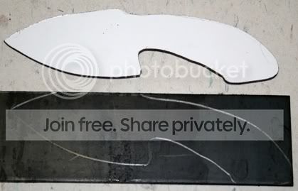

This is my first attempt at making a knife. I have my pattern and a 1/8" piece of carbon steel. Can I cut this with a hand held electric jig saw, or with my table mount scroll saw? I know a band saw would be better, but I don't have access to one.
Jig saws come with metal cutting blades I am not sure about scroll saws, you can try it may be a bit tough to hold all you will be out is a couple of bucks for the blade. You need something in the 18 -24 tpi range. You can cut with a hacksaw, the shape is pretty simple and could be traced with a hacksaw.
Sawsall with a metal cutting blade does pretty stinking well for roughing out shapes as well...
Good luck and keep us posted!!
Frank B
You can use a dremel, but you will go through alot of cutting disks and they tend to explode. Once you got most of the material removed then start with a flat and round file to get the final shaping done. That is if you don't have a belt grinder. Be sure to post your work.
Welcome to Blade Forums!!!
You can also drill the shape with a hand drill, then use a hacksaw(or dremel) to cut between the holes. An electric angle grinder with a cutting blade works pretty well or a pneumatic cut off tool.
David
I really like using a cheap $15 angle grinder from Harbor Freight for cutting out blanks. I do any straight lines I can with that and the rest with the bandsaw. Without the bandsaw I'd go with just the angle grinder. I couldn't get my jig saw to work well but maybe it was my cheap blades.
It will almost iimpossible to cut that with a jig saw as they just don't work well for that sort of thing. However I don't have a bandsaw as of yet. I use an angle grinder and metal cutting blades.
Clamp your piece and use a support handle on the grinder when you can. go slow and you will be amazed, you can cut curves.
For tight curves I switch to a dremmel and metal blade. With a dremmel you really have to let it cut and don't force it, or it will explode or burn up the blade!
You can then use a grinder wheel on the angle grinder for some areas you need to clean up as well as a belt sander. The slack belt, and the curves of the wheels can help with other areas. As well as small drum wheels for the drill press.
The key is take your time and don't burn the metal and cool often. Always be sure of how you are feeding into a grinder or any other machine. A minutes carelessness can cause you to get hurt or anyone around you, and sometimes hurt is if you are lucky!

I did my first knife with a hacksaw, it wasn't too bad, not as nice as the bandsaw, though!
Wow Bruce that is very kind of you. Midnight Flyer (Robert) is right, you folks are class acts and nice to boot.
I tried this on both my jig saw (felt like I was standing on a trampoline with my kids) and my scroll saw. The scroll saw quickly said "ain't no way you gonna cut with me". So I'm going to check with the metal shop at work for a hand at cutting. If I can't find somebody local, Bruce may be getting a package. :) All my equipment is for woodworking - no bandsaw yet - so I'm handicapped from the get-go.

If a hacksaw proves too much for you, get an $8 angle grinder and some cut off discs from Harbor Freight and go to town.
Dremel tools have their windings open to the air and do not last long cutting metal. After a few knife blades you will be buying a new one as the motor will have shorted out.
I understand your concerns, Steve, but I've had this dremel for a couple years, and there are many, many hours of use on it, almost exclusively cutting/grinding steel. I'm sure it will puke out eventually but so far, so good.
Can I use some type of cut off wheel on my bench grinder to cut this? What would you suggest?
I have a small bench grinder and figured I could use that for stock removal instead of a bandsaw or an angle grinder. Would it work?
Okay, I clamped this down on my B&D Workmate and went to town tonight with my jigsaw. Have it rough cut and will post a picture tomorrow. It'll take some dressing with my grinder but looks pretty good considering how quickly it cut once I got down to business. Thanks for all advice and we'll see y'all in the morning! ;)
