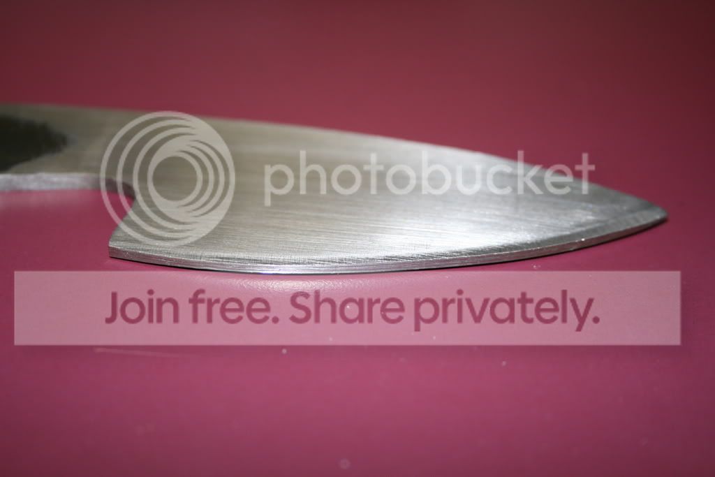

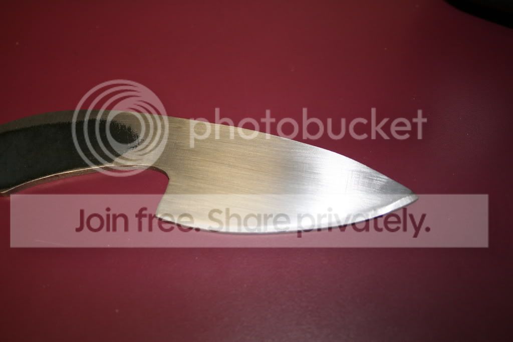

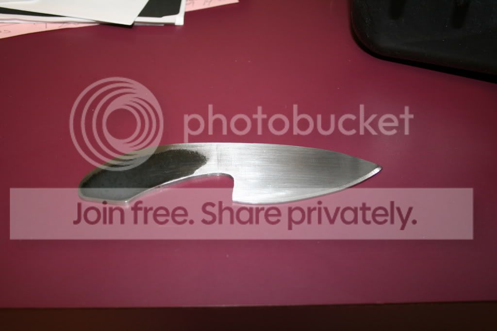

Here's some new pictures. I started hand sanding last night with amazing (at least I thought so) results. Never would have thought hand sanding would produce an even sanding (better than my belt sander would). Just thought laying it flat on the belt was hard to beat, and I was wrong.

At the risk of sounding like an ignoramus here Clyde, are you sanding the blade before filing/grinding in your blade bevels (it almost looks that way from your photos, but it's hard to tell and I'm not sure.) If so, you are probably wasting effort sanding material that will no longer be there once the bevels are done.
I'm not sure how much of a bevel I'll have, or if I'll have one yet. It's been kind of a design as I go knife, being that it's my first. I haven't figured out how to make the bevel without taking off any of my edge, and I wanted to be sure my edge was thick enough that it didn't crack when I fired it.
You have to have a bevel! Unless you're just making a knife shaped piece of steel? :confused: How do you have an edge without a bevel anyway? Not sure I understand and from what I see in the pics, it looks like there is no edge? Ok, I just took another look and I see the grind. It needs to come up a lot higher. It's at much too steep of an angle right now. Your edge won't crack when you quench it, if it's thin (sharp thin) it might warp so to avoid that grind the bevels and then leave the cutting edge about the thickness of a dime, then after the temper, grind it real slow and keep it cool.
Well I'm a newbie, so take it for what it's worth, but I think you want to have bevels on your knife with 1/8" material. How you do it is up to you...you can file them, draw file them, use a belt grinder, use an angle grinder to rough them in. I hand filed my first blade without any jigs, but they are easy to make and will help a lot. They are sort of like an overgrown Lansky sharpener, so they hold a consistent angle. The bevel does not have to come all the way to the spine, but I think you need something. It's usually recommended to leave a dime or nickel thickness at the edge before HT to prevent cracks or warping. I've only quenched a few blades so far, but some of them have been far thinner than that and I haven't had any problems yet.

Clyde, I have made that exact shape as a skinner, and I just flat grind the whole blade to the edge. I add a final small secondary bevel to set the edge.

Not to beat a dead horse, Clyde, but reading all of the above I too wondered if you were going to heat treat the blade with practically no bevels. The profile looks good and all, and the surface looks pretty now, but it will get dirty looking all over again in the heat treat and you will be hating life if you leave that much steel to remove from the bevels until after HT when the steel is much harder to sand/grind. I'm rooting for you, keep it up! Another good one on knifemaking is "How to make Knives," by David Boye, and "The Complete Modern Bladesmith" by Jim Hrisoulas is a favorite of mine as well.

I followed it pretty closely, and I somehow managed to end up with a functional knife. As mentioned above, resist the urge to say 'I'll just take care of that after HT'. Many times I felt that way during the making of my first blade, and anything that seems hard or slow going before HT will be exponentially more difficult after when the steel is hard.
