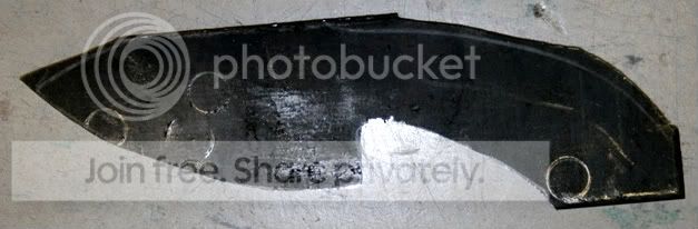

This is the blade after the initial cuts. Pretty rough but taking shape. I was pleasantly surprised at what my little B&D jig saw could muster. I'll dress this up on my grinder next.
Okay, now you are at the point where things get abit more serious. Scribe a center line for center of the edge. This may be tricky if you don't have access to a center knife scriber. But using a sharpened center punch, work a center line down where the cutting edge will be.
Then start the stock removal process. Gradually start removing material to form the bevel lines using hand files or belt sander. Double check your work as you go to make sure things remain symetrical. Symetry is critical for a good looking blade. Go slow and compare each side of the grind reguarly until you are satisfied with the grinds. Then work with progressively finer grits until the knife finish starts to look good.
I usually bring a knife blade to a 220 grit finish prior to heat treat. Drill all holes for the handle prior to heat treat.

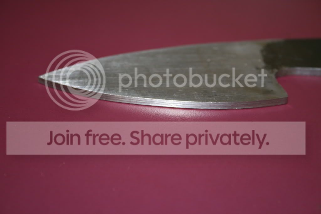

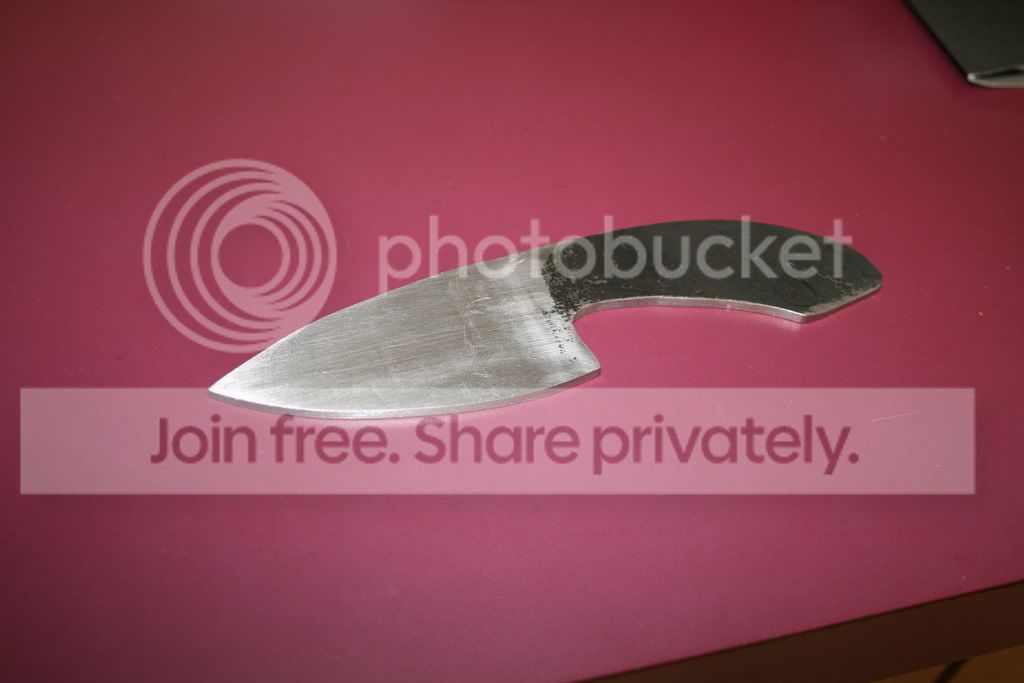

I think it's starting to come together now. I still have some sanding to do. I just bought a new belt for my sander - wore the old one out. Now I can work on gettting a few of the ripples out of the blade. The spine has taken a little different shape than what I had planned, but I think I like it better this way.
Please feel free to offer any advice. All help appreciated.
That's coming along nicely! It also looks to me like you did a fine job scribing the edge guidelines :thumbup:

If you want a nice clean plunge, set it first with a file and some kind of guide. At least set the beginning of it for a reference point. As for beveling, start with a 45-degree angle on both sides, being careful to only go down to the scribed lines. Then start working the bevel back towards the spine.

I am worried about sanding the bevels, afraid I'm going to get them lopsided. Any advice other than take it slowly? Should I make some type of jig to hold it at the same angle?
Those sanding mandrels are great. Since you have a press, follow Bruce's advice and look at a bandsaw next.
I think if you're careful, you shouldn't need a jig. You might try clamping the blade in your vise point-up, so you can see the angle you're working at compared to the spine more easily. Glue scrap leather from an old belt or something to the vise jaws to prevent nasty marks that are a pain to get rid of. Then set the 45's with a file... it's nearly as fast as a belt grinder when shaping a small amount and easier to see what's going on.
If I'm telling you stuff you already know, don't be offended! I just figure no one is born knowing this stuff...
No, your not telling me stuff I already know - I'm far from a "know it all". I understand the part about the 45's, but what about the rest of the blade. From the edge to the spine? Or, should I only bevel the very edge?
Start with that 45 degree bevel down to the scribe lines you made. This won't take long. You left enough space between those lines that you should be fairly safe from warpage in HT.
From that point until after the blade is quenched and tempered, keep that flat edge the way it is, and work the bevel back towards the spine. OR, since that's relatively thin stock, you could just do the 45's and grind the rest of the bevel after HT. It would take a bit longer to grind that way, but you would have extra insurance against warping in the quench.

If I understand what's being suggested, I should grind it from the edge all the way back to the spine, leaving the small gap between the scribe lines on the edge?

Take it from the spine to about a nickle's width on the edge before heat treat, at least I think a nickel.... don't have one on hand. I'm poor :(

Oh yeah, you do understand what's being suggested. The blade would be a perfect wedge in cross section. And it would be easier for you to draw file or grind first time without worrying about a grind line having to visually parallel the cutting edge!
