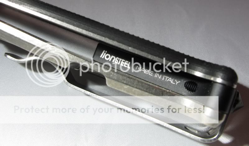

Quality control on this Lionsteel made knife is excellent apart from one single (misprint doesn’t count) minor issue and anyone calling it a piece of crap is being ignorant, letting their bias against RYP show and probably hasn't held one.

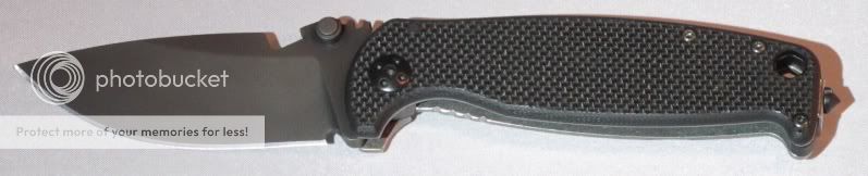

I am here because I'm interested in good knives. The HEST/F is one. Overall it's a well designed and manufactured folding knife with some unique features and maybe a couple perceived minor flaws. The tip issue is a minor one, has happened on plenty of production and custom knives before, and is easily and permanently fixed by the end user with no negative side affects at all.

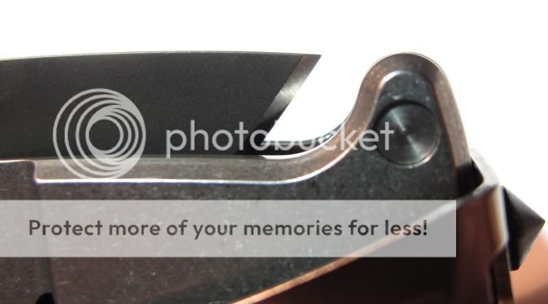

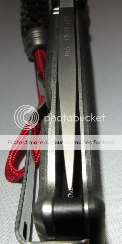

On at least some, (probably all but I'm not sure) of the 250 LE blades, the tip of the knive sits slighty proud of the scales when the knife is closed.
This is how mine (and I think all other LE blades) sits, more or less:
I'm not sure but I suspect the main reason for this is the coating on the blade and the stop pin. Without those coatings the tip would have sat perfectly, that's how little difference is required in the size of the stop pin, at a guess.
RYP/Lionsteel are fixing all the LE blades that haven't been shipped yet (I think by replacing the stop pin but not 100% sure) and I think they are sending replacement stop pins to everyone who already has the knife. That will correct the issue.
The standard production HEST folders will not have this issue at all.
It shouldn't have shipped like this IMO but it's a small thing and easily fixed.
All it needs is a new pin with a very slightly smaller diameter which is easily replaced by anyone with a T7 Torx bit for the handle and the pivot tool that comes with the knife. Detent and lock up are not affected by this to any relevant degree at all as is obvious when you understand the relationship between the pivot and the blade length.
I removed the stop pin, did some testing and put it back in, untouched as I'll wait for replacement pins from Lionsteel, no rush. As it is I can't touch the tip with my skin but can get a nail under it. It won't catch on anything so I'm happy with it like this for now, but would want it fixed eventually.
I measured and 4mm of movement at the blade tip when closed, or open, equates to approx 0.3mm movement at the stop pin and even less than that at the lock face, about a 10% difference in the lock up which is no issue at all in a lock this well engineered.
The lock face has a great shape, it will never make it’s way over to the other scale thanks to the curve of the ramp in the blades lock face and the lock will just wear in more securely as time goes by. this is how a frame lock should be made.
In my opinion there is no need for the knives to be sent back to the factory or anywhere else. Lionsteel should just send everyone a new stop pin (or 2 or 3 if you want to get the position extremely precise) and maybe a T7 torx bit, ($2 from eBay) plus instructions which even I would be happy to write or film. It is no more than 5 minutes work to swap the stop pin, no matter how slow and careful you are.
When closed, the blade can be just touched with my little finger if I poke it in there, and would sit only a very small fraction of a mm lower with a new stop pin (not noticeably at all). Personally I would like to see a very thin backspacer right up to the end of the blade. The backspacer could be paper thin really and then end in another handle screw, right through the sharpening choil cut out. It would still leave room for a flipper if the finger guard of the blade where extended to be one. If I keep the knife I may make a temporary flipper from JB weld or something just to see how it works.
Mine is sterile but as for the misprint issue on the Mr. DP blades, who gives a crap, big deal, it in no way affects the performance. It's worth more like that long term and you should be happy if you got one. I have bank notes with misprints. if the Mint can miss those, I can forgive Lionsteel and RYP.

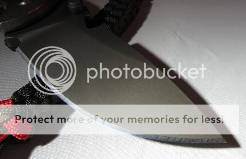

The blade is centered bang on. I read criticism of un-centered blades but haven't seen pics, anyone seen a blade not centered? The pivot and washers are big enough that if tightened properly I can't see the blade getting close to the liner, even though the fit is tight and gap is small. When closed I can’t wiggle the blade enough side to side to make it hit the liners unless I was to get stupid with the force used, which I wont.
The HEST/F blade is 5mm thick, same as my Junglas and Fallkniven H1.
The coating seems great but I haven't used the knife so don't know how it will hold up. I suspect it will be pretty tuough and durable, seems better than Emerson and Fallkniven coatings for sure. Spyderco and ESEE coatings seem tougher and I don't know how they compare to the HEST/F long term.
Blade is the same as the fixed HEST, great big belly, flat ground, good point and thick and strong. Fair bit of distal taper near the point so should be ok for fine stuff. Not sure how it will slice, it's no Opinel...
It's very sharp, has only been touched by my finger tips but it's a fine edge. I haven't cut aything with it but I'd expect it will be the same as the fixed blade apart from the coating being smoother. The jimping is great, deep and aggresive, you can press real hard and not slip or get a sore thumb.

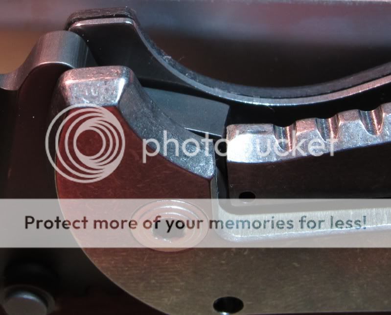

7. Detent
The detent is already pulling the blade closed when the tip is level with the highest point of the end of the handles, which is 8mm proud:
The detent is centered when the blade is almost but not quite touching the back spacer, and the tip is well below the handles:
The detent hole in the blade is 2mm wide. So the detent works acceptably to pull the blade closed anywhere from the blade being 8mm+ open, to the blade hitting the backspacer (and further). The detent is consistently very strong over about half that range. There will be no issue with the detent with new stop pins.

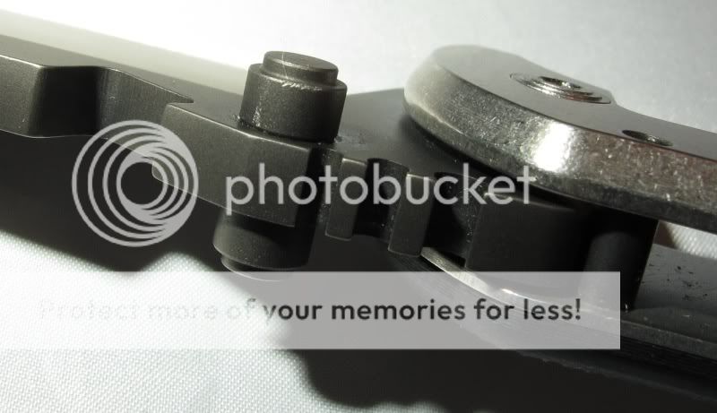

8. Rotoblock
The rotoblock works well, mine was stiff but is free now, I only turned it 20 times or so. I have only waved the knife open twice, once forwards and once backwards, and neither time did the rotoblock engage but it was still stiff and I didn't wave hard, just enough to lock it. Personally I would probably end up adjusting the rotoblock to never engage as I don’t get too rough with folders, but it’s still good to have as it provides 2 more functions, as on Hinderers, the Lionsteel SR-1 etc.
1. It prevents the lock bar being over extended due to too much force when closing the knife.
2. In hard use with the knife hard in the open position it prevents the lock bar being bent up toward the top of the handles when squeezing the handle, which does happen with framelocks that are gripped or stabbed hard.
I should have taken a photo of how it sits from the factory, my mistake. I'll add one to the review now.
I can't get my finger in that area so it won't nick me and it's no big deal, but the tip really should be below the scales. RYP/Lionsteel are fixing all the LE blades that haven't been shipped yet (I think by replacing the stop pin but not 100% sure) and I think they are sending replacement stop pins to everyone who already has the knife. That will correct the issue.
ok thanks i guess i was seeing this and didnt register that the pic showed the blade as it was fully closed from the factory. how does the smaller pin affect lockup? i should ask is this also something thats going to be fixed in the next release?
