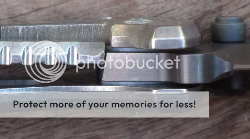

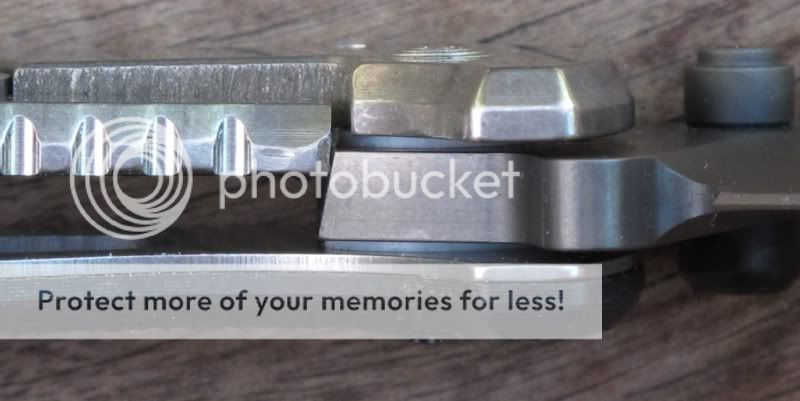

I just took a couple more pics which I should have done in the first place.
This shows the lock up when the tip of the knife is in the current position resting against the old, thicker stop pin. As it currently is, when the stop pin is thick enough for the tip to sit here when closed:
The lock will sit here when the blade is open, which is were it is right now:
This shows the lock up when the stop pin has been removed (or replaced with a very small one) and the blade rests in the same position it would if the stop pin was the right size for the blade to sit right down in the center of the detent, more or less. This is worst case how the tip will sit (on this knife) with the new stop pins:
And this is the lock up with a stop pin that will make the tip sit as it does in the pic above:
That is how it will sit with a smaller stop pin, allowing the knife to open slighty further. So you get slightly earlier lock up.
The above pics show a range of 3mm difference at the knife tip.
And that's worst case, assuming the new stop pins are small enough for the blade to almost touch the backspacer, which they won't be. So you can see, very little difference to the lockup.
Sorry for my rambling explanation, brevity is not my strength :o

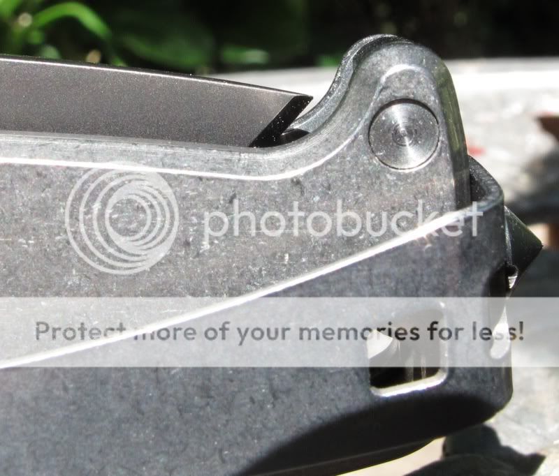

the tip sticking out bothered me too. so i fixed it took a couple seconds and didn't have to remove any screws. i've been carrying and using it pretty hard for the last couple of weeks with no complaints.
i polished right here
the coating is holding up pretty well. i've used it to cut hay bale netting, trim some pvc and other regular stuff around the ranch, the wire striper jimping looks more rough than it feels and does strip wire very well. the bottle opener dosn't catch on my pocket unless i turn the knife just a bit on pulling out of the pocket.
the more i carry it the more i like it.
take it easy
cricket

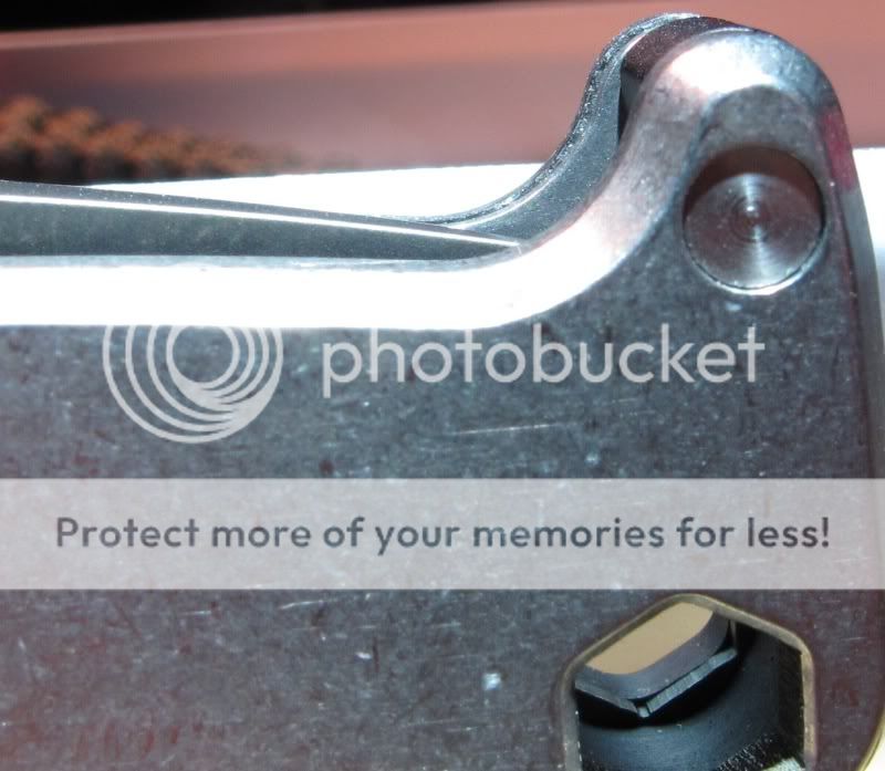

Ok guys, you two could easily catch your clothing, fingers, children or whatever in that tiny little opening between the birds-head and the "exposed tip".
My direct, in-hand, using the knife, not just making assumptions based on seeing pictures on my interweb-viewer, tells ME that it is not a problem. It simply does not do the things that you are ASSUMING it will do from your looking at the picture on the web - believe it or not, you are wrong about that.
Here is a picture of MY knife showing how the tip lives on my example, and this has not cut me, cut my clothes off, injured local children, or otherwise interfered with my enjoyment of the knife in the two weeks I have had it in my hands.
best regards -
mqqn

If you tried to do it, could you catch that tip on the edge of a piece of clothing/shirt pocket/pants pocket, table cloth or other piece of cloth?
Thank you. (point proved... I don't have to try it, to know that it could be done easily if I tried to do it)
Hi Tim -
No, you cannot easily or accidentally catch that tip as you describe, and yes, in fact I have experimented with doing just that.
I have tried to rub the knife against clothing and skin, and it does not catch.
I can press the knife, blade side down, with the exposed tip on the leading edge, and rubbed it against a sweatshirt, denim, and my skin.
It does not catch my skin, it did not catch the sweatshirt, which I figured would be the one that would catch it if anything did, and it did not catch on the denim.
I bunched up the sweatshirt and tried to get the tip to catch, and I could not easily get it to catch. I had to specifically fold the sweatshirt, and then press it just so into the small crevice that is left between the end of the handle and the tip of the blade. I don't know how a person could accidentally get any skin in there.
In short, it is not a danger or safety issue in my direct experience.
I think that now, if an objective observer reads this thread, they will read ssumptions of people who have no experience with the knife, and the actual hands-on experiences of someone who does have the knife.
It's a very good knife, but it did have some very minor flaws as delivered.
No big deal; I would not buy one if I were you and I were concerned that this would be an issue for me, no problem and all good.
best regards -
mqqn
