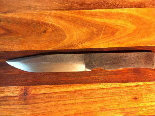

Alright so I got inspired when browsing the awesome knives on this forum and decided to try to make my own knife.
I have no professional equipment, all I had/have to work with is a lot of sandpaper and a couple of files.
There is a few things I hope you guys can help me with before continuing on the knife.
1. This was a really old file that I got from a farmer, probably about 40 years old. I know that it's some kind of tool steel but I don't know which, so how should I go about the heat treating? Any ideas of what kind of steel it could be? (I'm guessing O1 or A2 maybe?)
2. The edge is only 1mm (0.04 inch) thick at the moment, I read a bit too late that it should be about 1.5-3mm thick if not HT in vacuum. I'm gonna do it in a homemade forge (charcoal and hair dryer) and quench it in vegetable oil. Is there any safe way to go about it to prevent it from warping since it's already too thin?
(the knife spine is 5mm/0.2 inch thick)

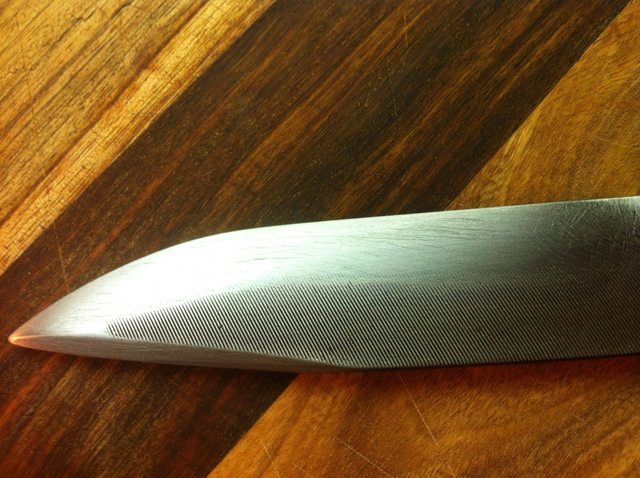

3. I want to keep the blade grind/file pattern line straight, any good idea how to do a nice jig for this only using a file for the grinding? (I tried covering up the file pattern in tape but it doesn't work very well)
4. As this is the first knife I've made any other advice is much appreciated!
To heat treat this, you are going to need a kiln, or a salt pot. Don't waste your time. Get some 1084 or 1075 and you will end up with a functional knife.
I don't know where you read that a blade should have an edge 1.5 to 3mm thick for HT, but that is totally wrong. About .015-.030" is good, which is 0.5 to 1.0mm

I can't get my hands on any knife steel at the moment. I'm spending 4 weeks at a cottage in Norway, that's why I don't have any proper tools either. I've heard that you can temper it in 2 or 3 cycles in a regular kitchen oven? Will get it to around 450-480 farenheit max which should be enough?
And for the hardening I was planning to use a brick forge heated by charcoal and a fan to get it to non magnetic, which worked when I annealed the file.
Am i misinformed about this?

Alright good to know, was afraid that all the hours of filing being a waste if it warped. Thanks!
Usually the oil is heated to decrease the viscosity which helps increase the heat transfer from the steel to the oil. You should have enough oil to immerse the entire blade. Vegetable oil seems to be preferred, usually due to safety reasons. 500 F will give you a softer but more ductile blade. Many start @ 400 F. If the blade is too hard you can temper again at a higher temperature. Don't forget to normalize the blade before final quench.

How have you shaped the so far? If by stock removal only, no heat/forging, I don't really see a need to normalize. It use to cut steel, that should be good enough for you with your first knife. Heat it until non magnetic and then a little more, quench it in 120 degree f. veggie oil, and temper in kitchen oven for 2 rounds, 1 hour each at 400-450. You will have a good knife. Hard to get much better with what you have to work with.

Old files could have up to 1.2% carbon. Without precise heat control, your carbon is going to end up in places that are bad for a knife. I was at the Southern Alberta Hammer In this weekend, and spent most if the weekend discussing steel with Kevin Cashen. While I was on the right track with much of my process, I have been enlightened on a lot of the finer nuances. Retained austentite, micro fracturing in plate martensite, carbide problems, and carbon going where it will be harmful rather than helpful would be at the forefront of my mind using a high carbon steel, especially if you don't know the composition. The importance of learning the temperature needed for each steel was reinforced.
That said, I like what you have done with the file :thumbup:. Since you have limited resources at the cottage, have fun. Your plan for heat treat should work ok, which is as good as it can get with that equipment. When you get home, get some good steel, and make things easier on yourself.

Practice on something before you try filework on it. :) But otherwise, I would build a filing jig and get those grind lines straightened out before a filework attempt.

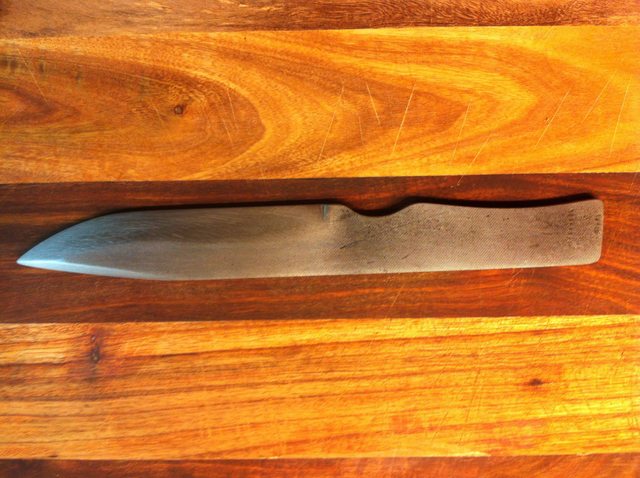

Unfortunately I can't make a filing jig since I only have like the most basic tools and limited material ( I'm spending the summer at an isolated cottage in Norway) but I think I managed to file it down pretty evenly anyway.
Only the HT, filework and handle + sheath left now. Who knew knife making could be so addicting and exciting!

The HT is finished now, the good news is it didn't warp or crack. But I'm not certain if it's evenly hardened, one side seems harder than the other? And I was able to make some scratches with a file.
I got it up to critical using a magnet and then kept it there for about 6 minutes, then got it straight into the canoa oil in less than 5 seconds. Maybe I should have used salt water (brine) since if it is 1095 it needs a faster cooling medium.
