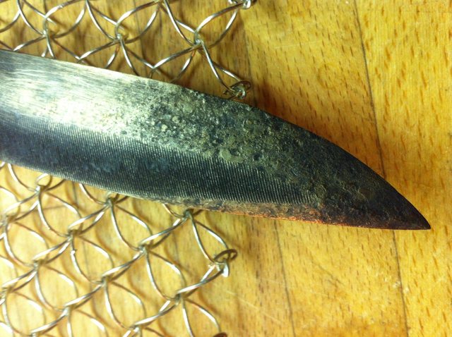

Yes I did but I think I got the spear point too hot due to uneven air flow, looks like it began to melt.
Should I just file it even again and then sand paper/polish it and check the hardness? I can do the HT again if necessary, I just need to normalize it first right?
Looks like you burnt the steel a bit, although I have done worse. Did the rest of the blade harden up? If it did, you can spend some time removing the burnt layer. The steel under the pits probably has some grain growth but may be OK otherwise. Or, you can anneal the blade and clean up the tip. In that case, you should normalize this time around before quenching.
Definitely overheated. Sand it down and see if there is enough "good" steel to see if its worth trying to save. There is likely heavy decarb in that area, and there is no way to get it back.

It does indeed look like I burnt the blade because of the increased air flow around the tip and maybe because of the tip having a tad smaller edge.
The good news is that the blade seems to have been properly hardened, after I removed the decarb surface (thanks for the advice about the vinegar Willie71) the blade was pretty damn hard. But on the other side I don't know how to remove the deformation on the spear point now, I tried filing but it's too hard. I don't really want to do the annealing and HT again since it's such a pain in the ass to HT mystery steel and I can't do it in a controlled environment with the exact same temperatures.
Should I just sand it to oblivion and try to get rid of it?

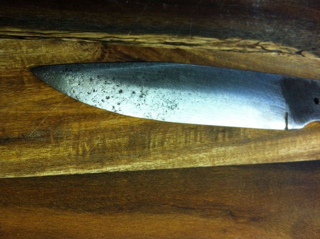

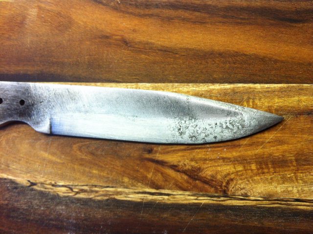

Pics after some cleanup.
Seems pretty hard in that area still, can't really scratch it with a good file. Maybe the decarb from overheating isn't such a big problem since the original file may have been up to 1.2% carbon steel? (The file was a lot harder than my other files when I got it)
Temper it at 400f for one hour, test the edge for chipping, and increase 25f each time until you have an edge that doesn't chip. You will have to sand rather than file hardened steel. Buy name brand sandpaper.

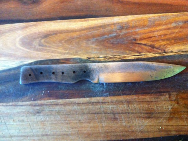

I have already tempered it, two times 1 hour each, first at 400f and the second one at 420f. The edge seems fine no chipping and really hard. Files and sandpaper is the only thing I have a lot of in my cottage^^, I have from 40g to 400g. Hopefully the sanding will be enough to get rid of the deformation.

Use windex to lubricate the sandpaper. Water with dishsoap will work too. It prevents it from loading up. Watch Nick Wheeler's sanding video. It will save you a lot of time. This has been a really fun thread. Thank you for posting this.
If you can't get rid of all the roughness, consider a forced patina. You could use white vinegar, lemon juice, mustard. I would try mustard though.
