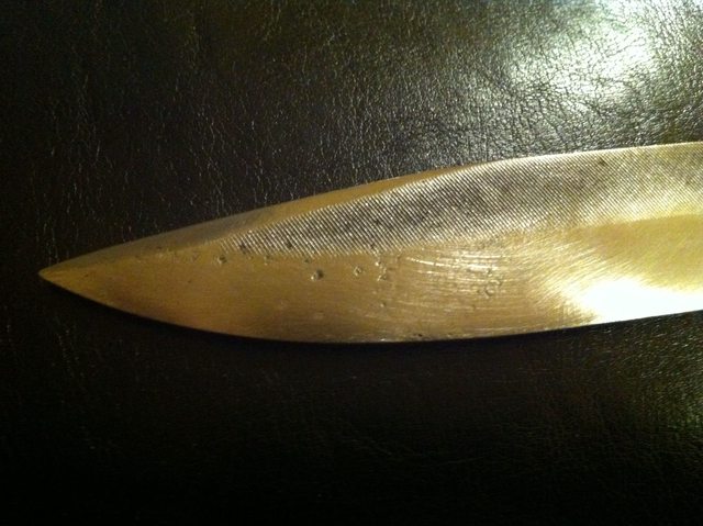

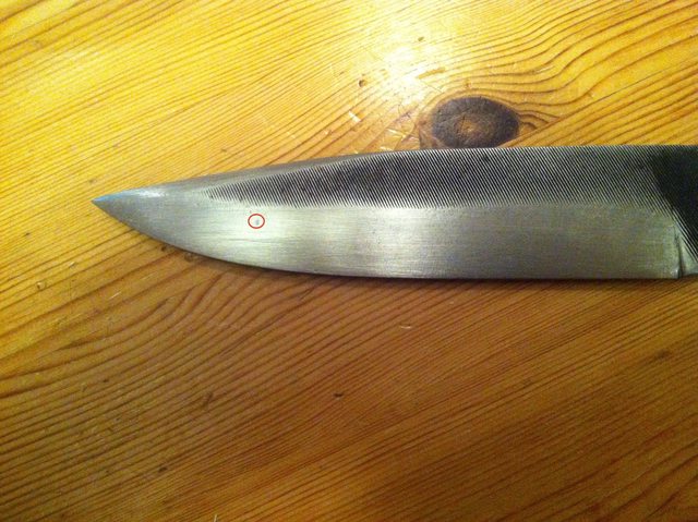

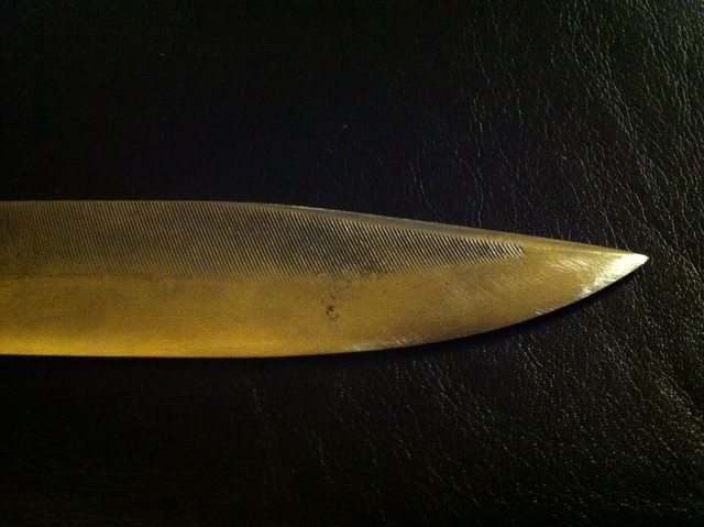

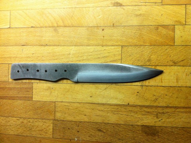

Update on the sanding:
I'm glad too see that I'm able to sand down the deformation on the blade but it takes a lot of time, makes me wish I had a belt sander in my cabin.
As you can see on the second picture some of the "craters" are rather deep but the spear point was a bit too thick and front heavy anyways so I think I will be able to get it as smooth as before even if it will take hours of sanding.
I'd just leave them in this knife. To get that out with sandpaper will take ... forever :)

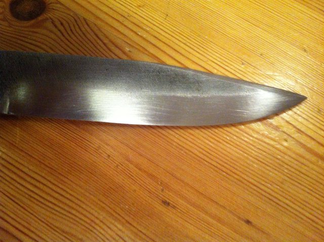

I was about to leave them thinking it's my first knife and all but I couldn't stand the thought of having to watch them forever so I decided to sand them anyway. It does take a long time indeed but I think I've made some progress during the last couple of hours. There is that one crater that refuses to go away.. I guess I will just have to keep on sanding, I'm still using 50grit so there is a lot of work to do.

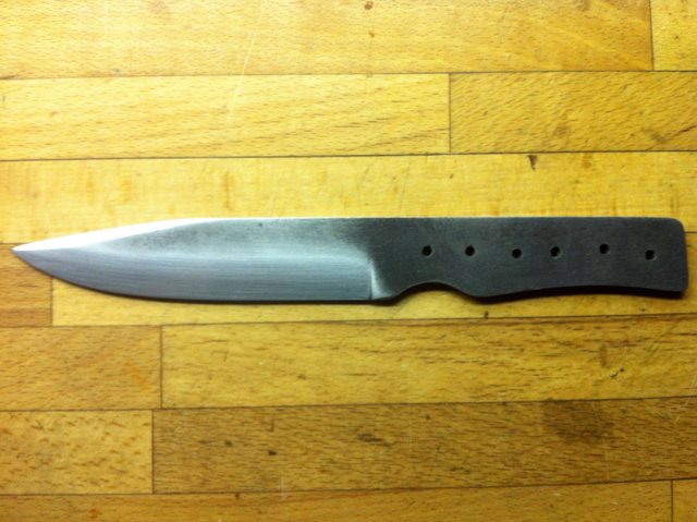

I'm finally done with the sanding, I think I got rid of most of the marks from the burnt steel. It's not perfect but I think that is as good as it gets with the amount of sandpaper I have at my cabin.
Now I only need to sharpen it and make the handle. I'm really excited to see what it looks like when it's complete and how it performs!

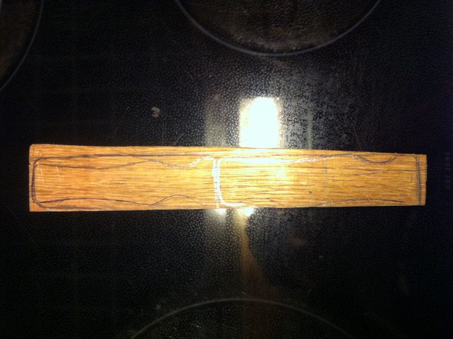

I would rather prefer something more interesting than oak for the handle, but it's the only wood I have laying around, I think it should do for my first knife.
It's great that the handle material comes from the cottage :thumbup:. Looking forward to the results.

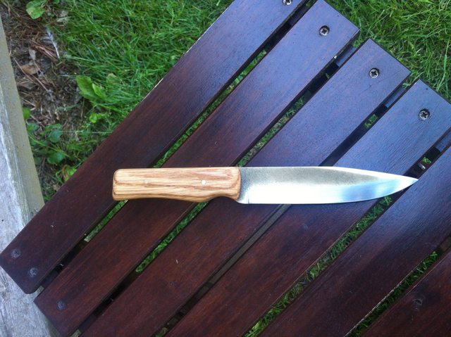

Back from an amazing hike and the handle is now complete. There are a few things that I'm unhappy with about this knife but I won't make the same mistakes again on my second try at least.
Unfortunately I didn't have enough leather for a sheath so that will have to wait a few weeks until in back home.
Nothing wrong with the look of that knife. Simple and rustic. It definitely needs a good sheath.
