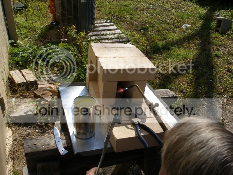

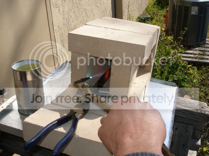

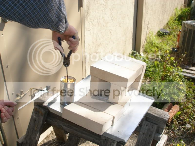

I haven't used 1084, but if it HT's like 01 then a torch will work.
I just got some firebrick from the local masonry supply and stacked them to make a small "forge".
Heated the blade until it was a dull red and non magnetic then quenched it in a soup can with preheated Canola oil.
A few pics of the process.
Diver Texas, do you have to temper it after the quench?
From the reading I've done, 1084 requires:
5 to 20 minute soak @ ~1450 F
Quench in oil preheated to ~150 F
Temper one to three times for 2 hours @ 375 F
