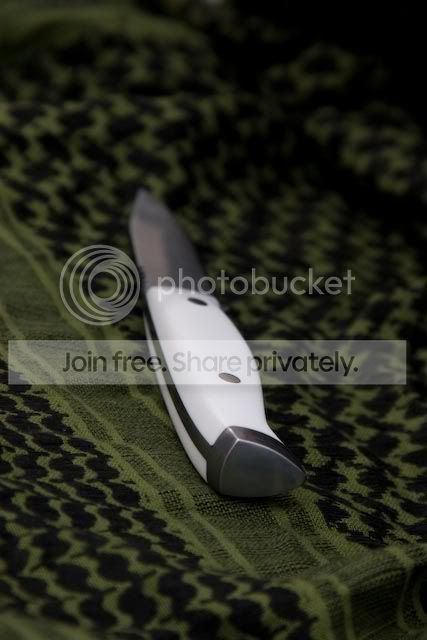

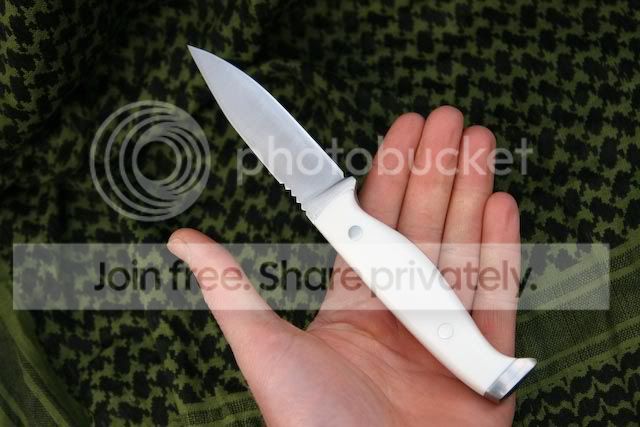

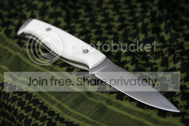

Hi guys thought I'd share this with you I took some advice of some good makers here in Oz to quit muckin' about with hardened power-hacksaw blades and get serious, so officially this is my third finished knife but the first real serious one.
Specs: 0-1
4 mm thick
Flat ground with convex edge
just shy of 100 mm blade
57-59 Rc
welded pommel
Corian scales with stainless pins
Most of it was done with hand tools, bevels are hand filed. I have a drill press and shaped some of the scales with a crappy hand-held belt sander.
I thought it came up ok, I made for my dad's 60th birthday.
Opinions are all welcome.
Thanks for looking :)
thats a great looking knife! the only thing i would change is the handle materiel. i am a big fan of natural handles.
Wow, that's a nice looking knife! Especially for your first (or third.) I sure that your dad will be thrilled.
Cheers guys,
I love a great timber over synthetic as well but I didn't have any timber that has enough interest in the grain and this stuff is pretty indestructible. The next one's mine, a standard bushcraft/scandi style, the blade's finished and heat treated just need to decide on scales again.

I think you passed OK before the scales were attached. That is a great looking knife.:thumbup:
BTW, thanks for using Corian. I work for DuPont and my pension needs all the help it can get :p.
Chris
That's a beautiful knife SB. You seem to have a flair for design as well as making. I look forward to seeing what you come up with in the future. Be sure to keep us posted.:thumbup:

Third or thirtieth...a work to be very proud of. Wonderfully useable design, yet graceful.
Very nice.
Kis
Beautifull, I would buy one, and I usually don't like customs (there are some exeptions).
