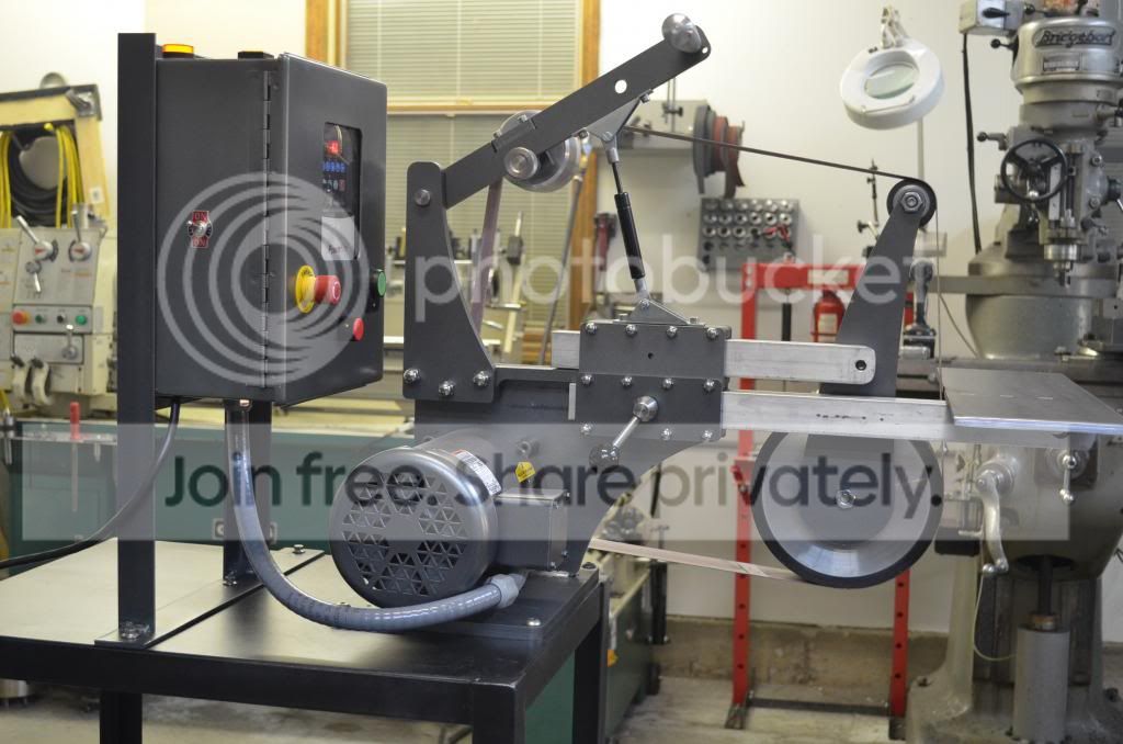

New to the forum, new to knife making, got questions. I've ordered a Grinder in a Box kit from Jamie at Polar Bear Forge and expect it should be here later in the week. I've got a 2hp Weg 3ph 3450rpm motor on the way that I picked up on Ebay. Ordered the 10" contact wheel from Grizzly and will order a 2" contact wheel from USA Knife Makers Supply. I will machine all my other idlers and drive wheel myself. I'm planning to run the KBAC 27D VFD. So, I've done a lot of reading and I'm still not sure how to best set up the drive and motor with regards to RPM and surface speed. My first question is, how much belt speed is enough? I've seen that some of the Burr-Kings go up to 7000sfm. That seems really fast to me and I know the smaller wheels won't be able to handle those kinds of speeds.
My next question is, would it be better to run the motor above 60hz to get the speed I need or to use a larger drive wheel. My calculations indicate that I would probably maintain higher torque by sticking with a 4" drive wheel and over-running the motor when needed as opposed to using a 6" drive wheel and staying below 60hz. Of course there are trade-offs with that. Many of you guys seem to have a lot of knowledge on this subject so what works best in the real world?

Most grinding on knives benefits from slowing down rather than speeding up. A 4" drive wheel is fast enough. I have a 5" on my craftsman, and it is too fast for everything but hogging steel.

Using the Kbac drives above 60 hz results in the following: linear drop of torque from 60 to 120 hz ultimately resulting in a drop of torque by 50% @ 120hz. So driving the motor with the 2x jumper results in increased sfpm but substantial torque reduction when running all out.
When I wired up my KMG, I decided on a max speed using appropriate pulley ratios and a 6" drive. My motor is 3hp so I'm not concerned about lacking torque.
I think the gib is direct drive so you'll have to control the sfpm with the drive wheel size. You could create an indirect drive gib. You could look on the wilmont site and see how they created an indirect drive mounting option for those that wanted the adjustability.

I'm about 5250 all out without using the 2x jumper on the kbac29 drive and 1750 rpm motor. This was achieved with a pulley ratio of ~2 with my indirect motor setup. Hope this helps. I also have a 4" wheel if things need to get slowed down more. One thing to keep in mind is a TEFC motors ran slows down as well as the motor is slowed, so effective cooling is decreased but adding airflow is quite easy using an external fan if needed.

Good point on the cooling. That is another argument for running the smaller drive wheel and setting the VFD to 2x. I'm really leaning that direction. It is pretty unlikely that I would run over 90hz and most of the time I would be below 60hz. I'll run some tests when I get everything together just to make sure the bearings don't overheat and the motor doesn't develop too much vibration. This particular motor is only balanced to 3600rpm but, Weg's are pretty decent; I'm thinking it should be able to spin reliably to 5500 or so.

At 5500 rpm you would be about 50% extra rpm so that would correlate with 75 of max torque. Sound a like you have made up you mind. There are NUMEROUS threads about 4 pole 1750 rpm motors and advantages of this vs. higher rpm motors. With that said, the tw90 runs with the 2x setup and I have not heard of issues. Rob Frink, the maker of the KMG, does NOT recommend running the 2x jumper.

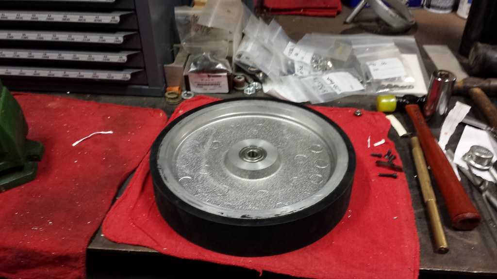

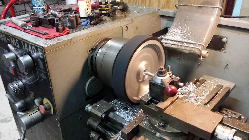

Got my GIB kit today. Box was in pretty rough shape, had a couple nails out on one end but, everything was intact. Looks pretty good. My Grizzly 10" contact wheel also arrived today and I went ahead and machined it out to accept 1/2"x1-3/8" bearings.

How difficult would It be do remove the casting marks on the grizzly wheel? I'm just curious about the lathes uses with cast materials such as this. Thanks
Ranger,
I don't think it would any big deal. The wheel came with one face machined on the underside of the outer rim. I had to machine the same face on the opposite side so I could cut the bores from each side. The quality of the casting seems decent enough. The only issue is, they balance the wheels by drilling holes to remove material. My wheel has two 1/2" diameter holes bored about 3/8" deep on one side.

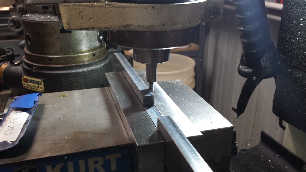

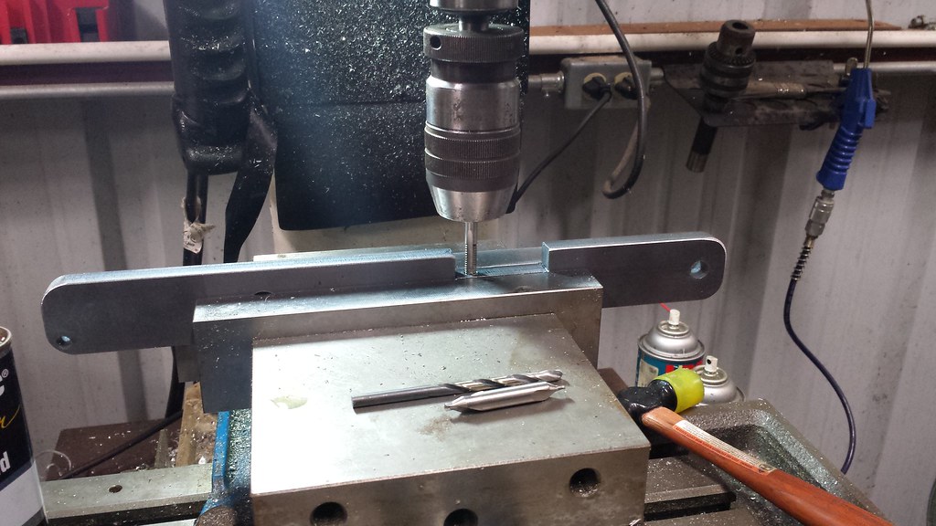

My hardware order from McMaster got delayed due to the recent crappy weather so I couldn't put the major components together yet. I did work on the tensioner arm though.
Finding the edge of the arm on the mill.
finding the edge by Ranger_Bob, on Flickr

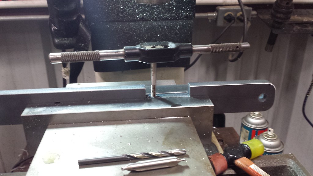

On blind holes I usually do a partial power tap to make sure the tap goes in straight. I just run it in part way at slow speed and hit the stop switch.
partial power tapping by Ranger_Bob, on Flickr
I then finish tapping by hand so I don't end up with a broken tap down in the hole.
finishing tapped hole by hand by Ranger_Bob, on Flickr

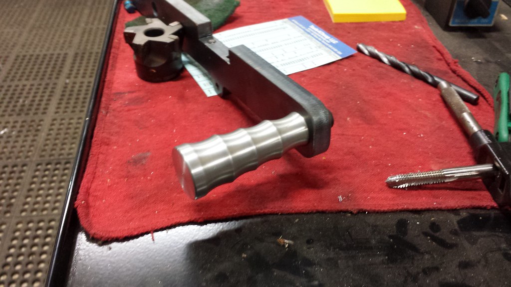

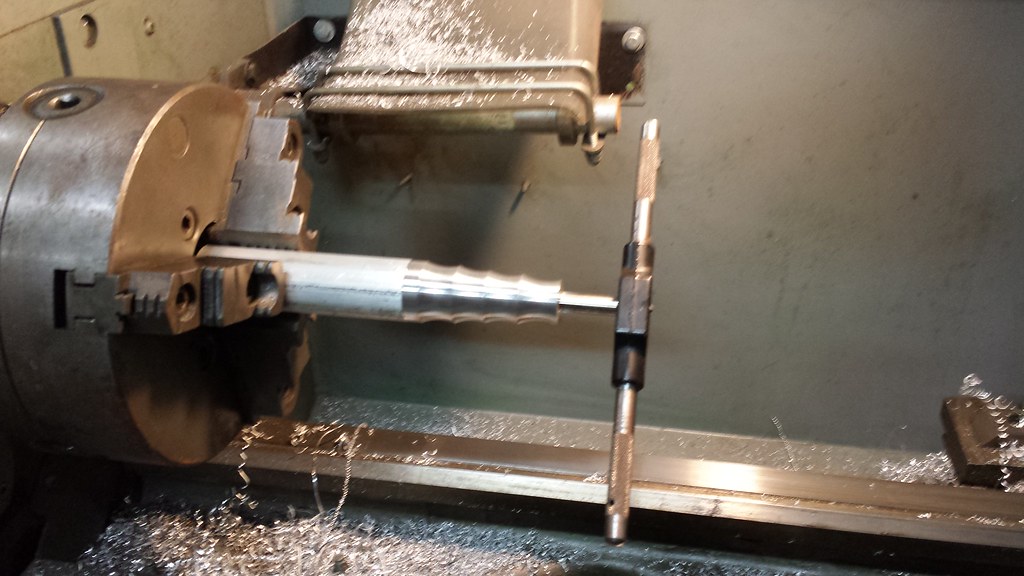

I use the same technique when tapping on the lathe. This is the handle for the tension arm.
tapping the handle by Ranger_Bob, on Flickr
Handle attached to the arm.
finished handle by Ranger_Bob, on Flickr
