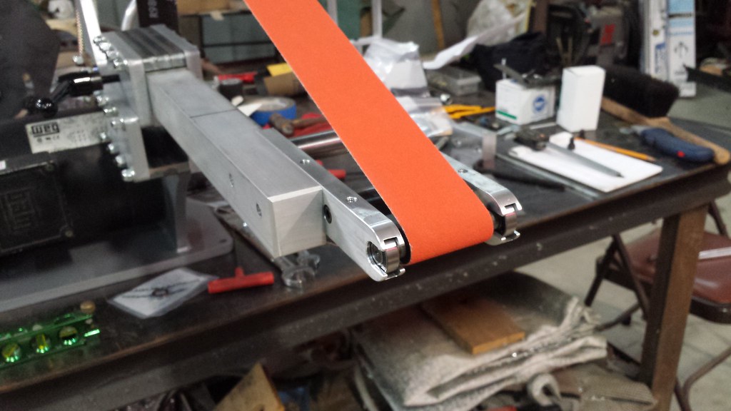

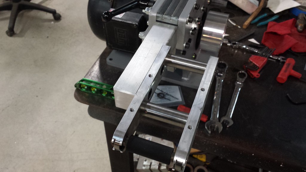

Can you explain the mounting setup? Looks like you used a screw that goes all the way through but then the slit snd compression button head screw throw me a curve.
Did you use cold rolled for the tool arm?
Thanks
It is a flat head cap screw counter-sunk into the 6061 aluminum arm. I did the pinch fit to remove any slop or movement of the axle. I could have done it with any bolt that had an un-threaded shoulder but, I thought this would look clean and keep the bolt head out of the way.

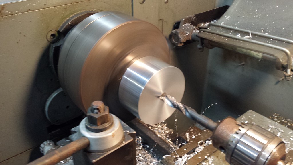

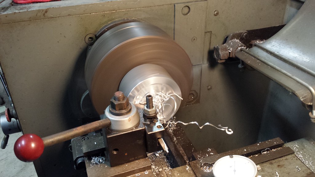

Here's some shots of making the 4" drive wheel. I machined the counter-bore first then flipped it over and clamped to the inside edge. I then turned the outside diameter and bored for the shaft in the same clamping so they would be concentric. I drilled the shaft hole undersize and finished it to final dimension with a small boring bar. I still need to broach the keyway and tap for a set screw.

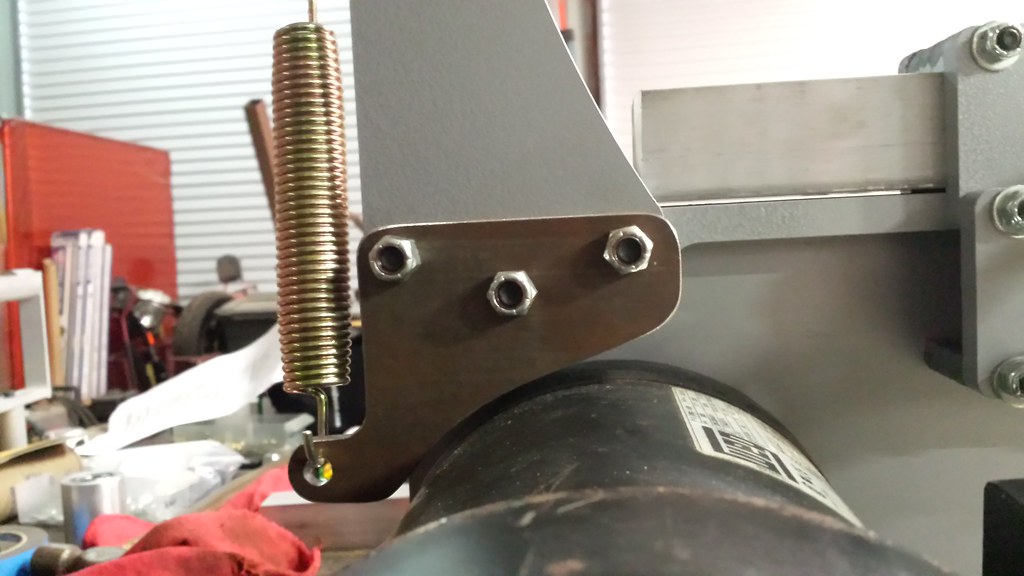

Had some more time in the shop today. Bracket I made for lower spring mount.

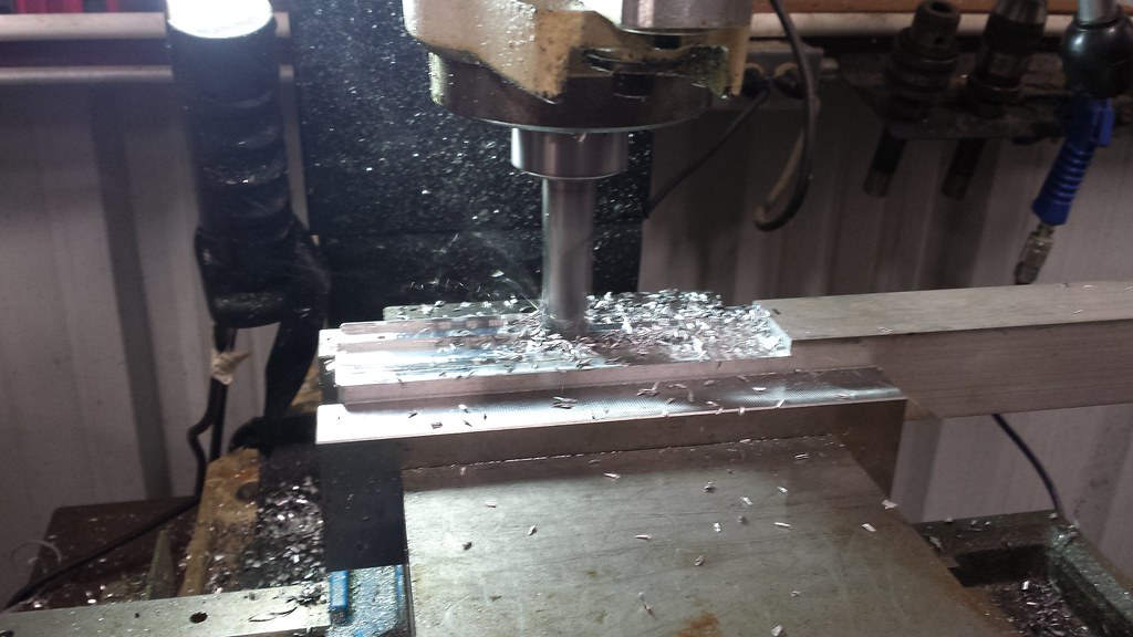

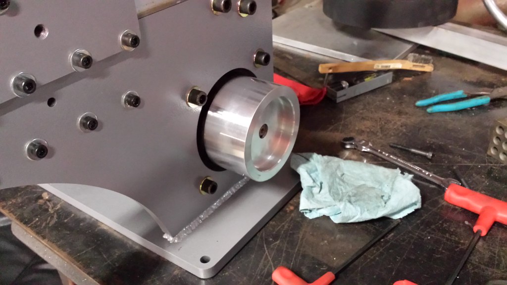

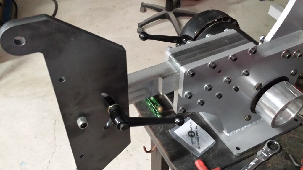

I decided I didn't like the idea of spacing the drive wheel out so far. The shaft on the 56c motor is not very long and pushing the drive wheel out too far really reduces how much shaft engagement you get. I decided to mill 1/4" off the face of the platen arm. That allows me to get an extra 1/4" of motor shaft into the drive wheel and reduce the shimming of the other wheels by the same amount. I haven't received my KnifeDogs small wheel attachment yet but I'm assuming I will have to adjust for it as well. I also had to switch the motor mounting bolts to button heads to reduce interference.

Looking good! I got the small wheel attachment for mine and love it.
When you moved all of the wheels over did you have any problem with the belt touching the side of the frame?
The belt easily clears the frame with all my attachments. I can't imagine an application where it would hit. The only issue I had was that I had to replace all the 3/8" socket head screws with button heads to prevent rubbing. I think you could still inadvertantly rub the belt on a bolt head if you weren't paying attention to the tracking but, if you are tracking straight there's about 1/8".
Thanks, Mine looks close, but I think it will clear. I have already gotten the button head bolts installed, mine rubbed socket head screws in the normal configuration. I don't have any tracking problems with everything spaced out so I am on the fence about moving it all in, but everything nice and tight sure looks good though.

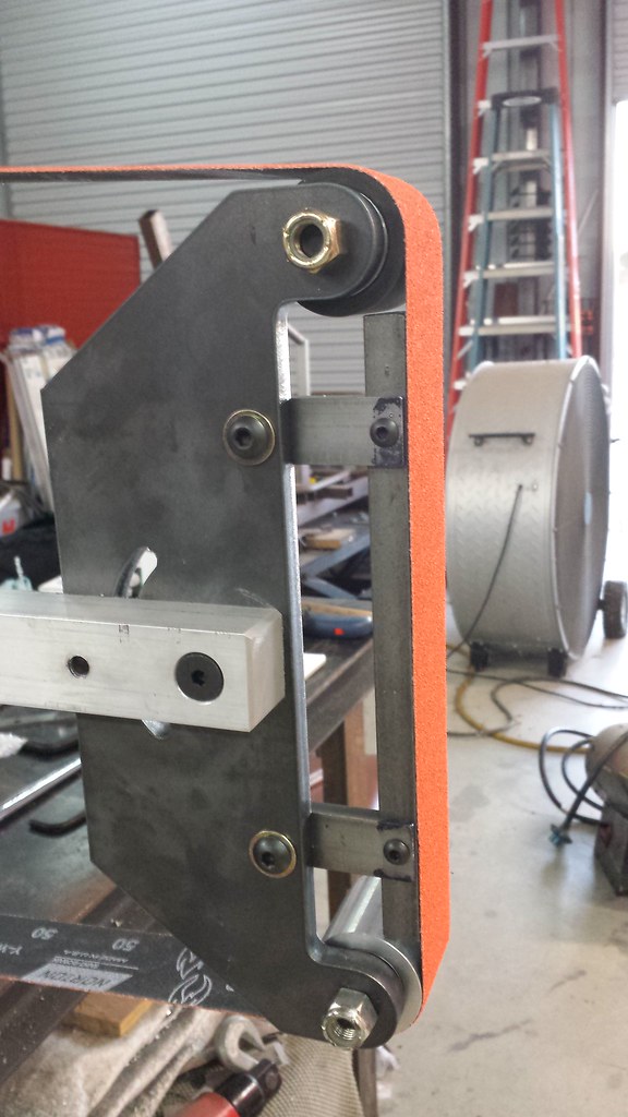

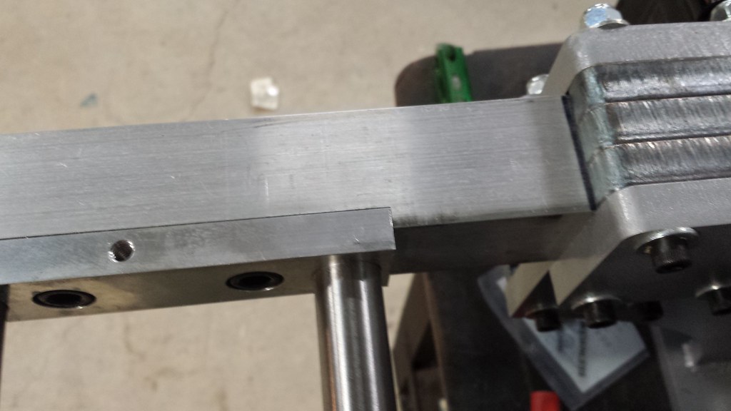

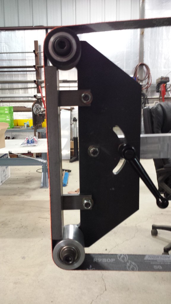

Finished up the fab for the flat platen and assembled everything for test fit. I made the platen out of .625" 1018 CR and I will add a ceramic glass liner to it once I get everything up and running. The top wheel is a 2" contact wheel I ordered from USA Knife Maker Supply; the bottom wheel is a 2" aluminum idler I machined. I got a notice that the VFD shipped so I'm hoping to have this thing running next week.

Your doing a outstanding job ! Very clean look. Platen looks nice what is the length on that ?
Thanks. It is 10"
Looks good. Platen will need to be shortened when adding Pyroceram.
My plan is to use a 9" liner and I will machine the face down to create a shelf with the bottom inch of the platen. I'm probably going to just bevel off the back corners to create a little more clearance.

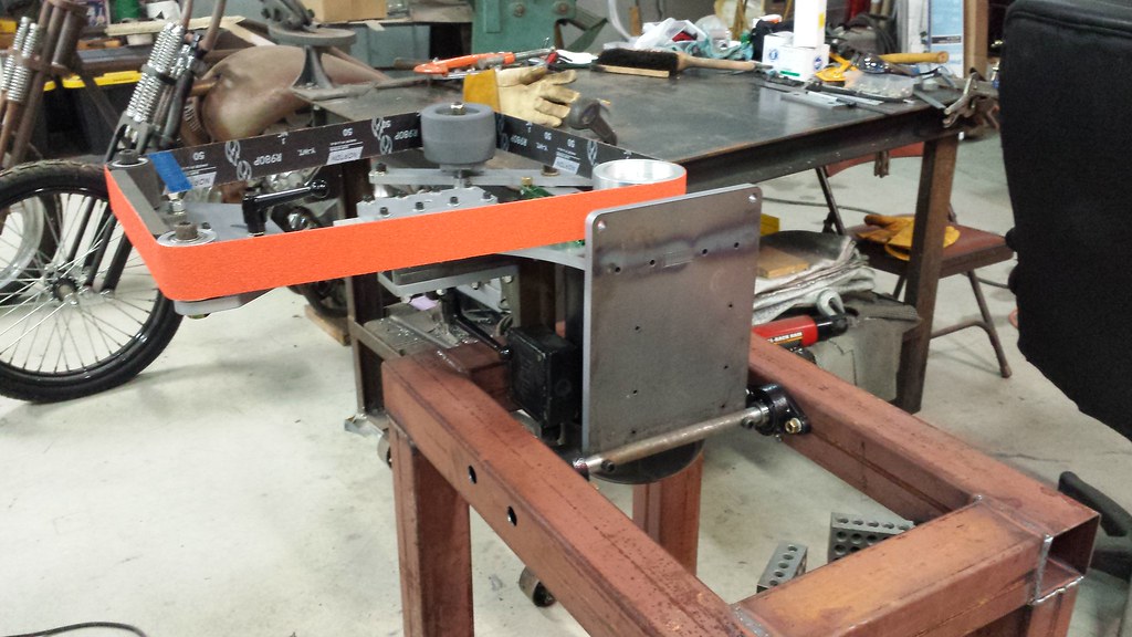

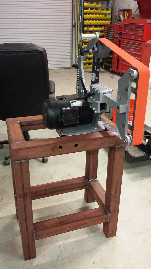

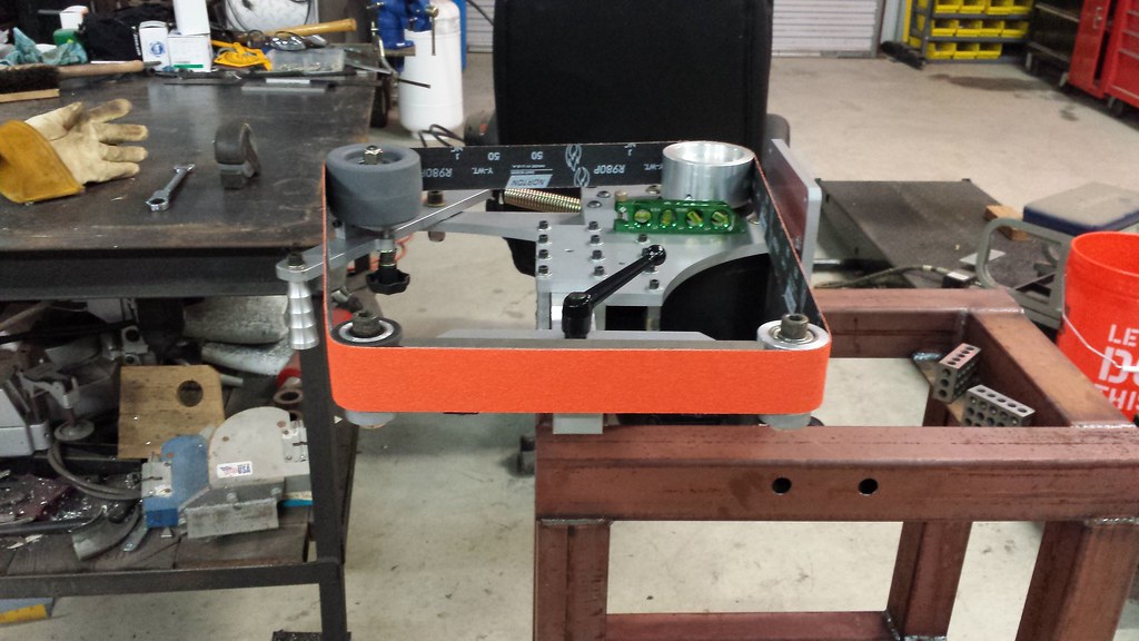

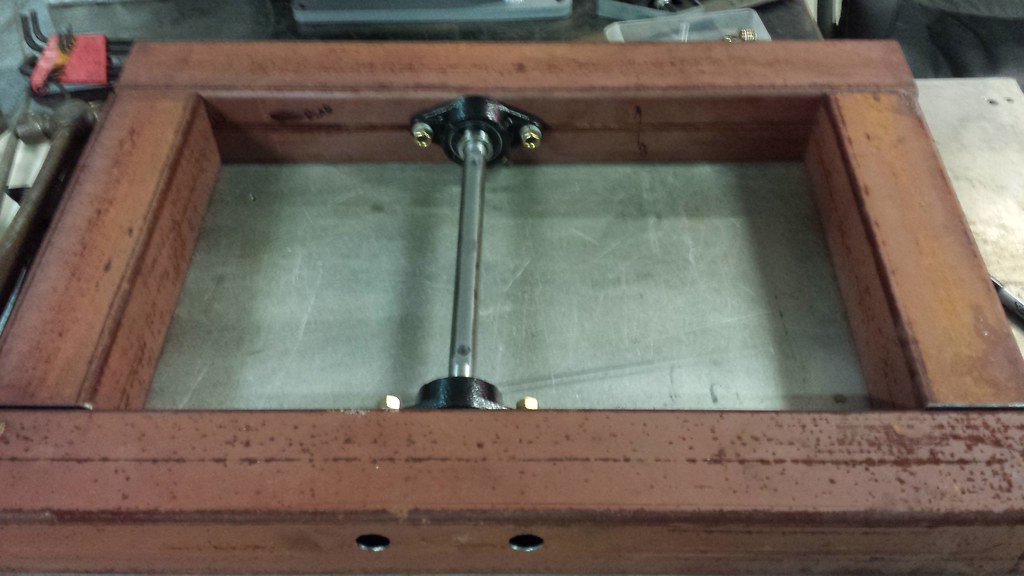

I think I mentioned earlier in the thread that I was going to set this grinder up to flip to horizontal. I started on that yesterday. I'm using some 3x3 box tube I had left over from building a run-in shed for my horses. The plan is pretty simple. I'm using a couple pillow blocks and a length of 3/4" rod. After taking some measurements, it looked like putting the pivot point in line with the two left side baseplate mounting holes would keep the work height the same when flipped. I milled a flat on the rod and drilled it to bolt directly to the baseplate at those holes.. I built this pretty quickly and didn't stop to take many pictures. It still needs some finish work but, I think it's going to work really well. The 1-2-3 blocks are sitting on a ledge that will support a couple adjustable feet screwed into the two right side baseplate holes. It will also get some adjustable rubber machine feet on the legs of the stand. The weight of the grinder should be more than adequate to hold itself in either position.
Bob

Even though the weight will keep the unit in place when in either position, I would add a spring loaded lock pin on the front or side of the frame for vertical use. It can mate with a hole on a block attached to the bottom of the plate. I agree that horizontal use will not need a lock.
The lock pin is just a piece of 1/4" round stock with the ends chamfered, a round knob for the outside end, and a short compression spring for the inside. A washer and a "C" retainer ring retain the spring. Pull back on the pin to release. Push in to lock. The spring will hold it snugly in place.

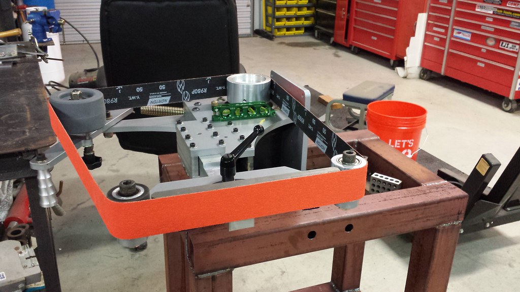

Got the VFD hooked up and did a test run. I felt the tracking was a bit finicky on the 3/4" small wheel. I think I'm going to put a little crown on the drive wheel and see if that helps. It seemed much quieter in person than on these cell phone videos. Still need to install the Mason machine feet which should be here tomorrow and then clean and paint the stand. I think I will go ahead and install some kind of captured pin for holding the grinder tight in the vertical position. There seems to be some vibration coming from the rotational inertia and locking it into the stand tightly should make that go away. Thank you Bladsmth. I need to figure out how I'm going to do the work rest now.
Bob

You are going to want to move that VFD to the other side. If the belt breaks it might slap that VFD into oblivion
