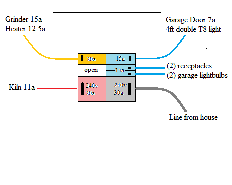

Nice big picture. It also helps that I am on my iPad now instead of my iPod touch. You can add your two pole breaker for kiln on the left. There is nothing wrong with the installation in the picture. The reason the panel is fed through the two pole thirty instead of going directly to the panel lugs is so that there is a "local disconnect". Put your 2 pole 20 amp (or 2 pole 15 amp, either is acceptable by code) on the left then get your Romex, 4x4 box, outlet.....
I see a lot of advice being given to you by people that, although trying to be helpful, don't know what they are looking at or talking about.
In the above post I see something about a white wire going to a breaker - the white wire is clearly going to the neutral bar. And that is where it should be. In reality white wires often go to breakers - in this case they are not being used as a neutral but as a hot. You will often see this on two pole breakers. You are going to do this for your new kiln outlet. Technically by current code you are supposed to re-identify the conductor using black or red tape.
Get your new breaker pop it in and proceed.
