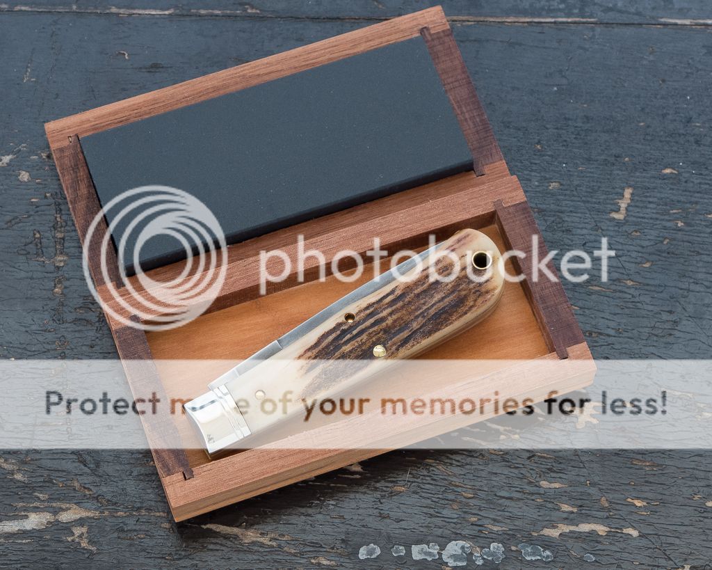

Wow! Those are some gorgeous stones! I really want to get a black one day. :)
My pocket translucent leaves an awesome edge on my slipjoints.
The leather sleeve also makes a handy strop.
- Christian
