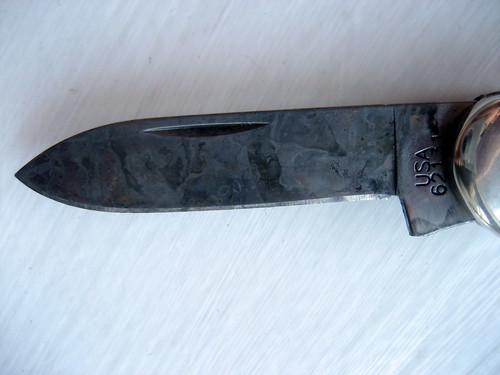

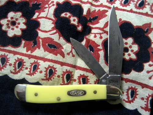

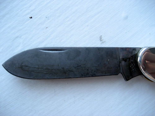

I forced two patinas this month. On my canoe, I stuck the blades in a potato for an hour and then impaled some kumquats on the blade for an hour or so. The kumquats did a lot more than the potato did. Eventually, I got a really interesting patina on the blades.
On my peanut, I immersed the blades up to the tang in Dr Pepper. After an hour, they looked perfect, albeit more even than the canoe experiment.

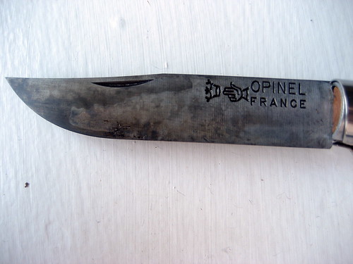

I have an earned patina on my opinel. I will update this post later with some photos.

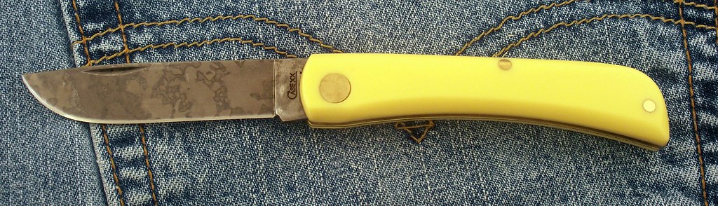

FLymon, funny you should dig this one up today. Just got back from church and taking my wife to the airport, and this little jack is my Sunday go-to-meetin' knife. It was in my right front as I read your post. Here is a pic hot off the digital.
Hasn't changed much, I'm afraid-- I mostly only carry it on Sundays, and it gets little use. My next "patina project" is going to be a short soak in some liquid to give a slight background color, then use mustard to paint on a hamon line. Might look kinda' neat on a slippie, maybe my #9 Opinel.
