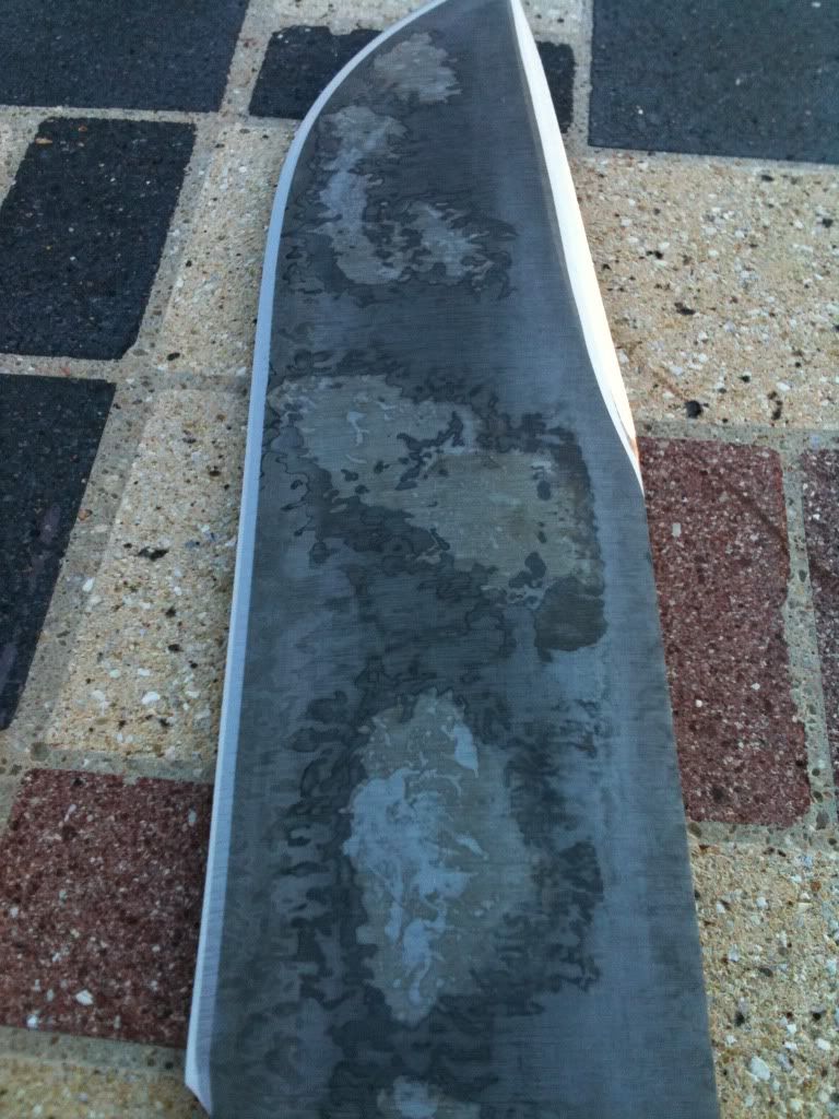

I promised this picture some three months ago. Oh well... Brownell's bluing. A quick swipe and water and oil. Less than 1 minute.

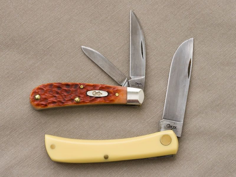

Just now saw this BEAUTY!. What fantastic skinning tools these are!. I have been using mine lately in the rain a lot of the time so often that the the sheath's belt loop is falling apart and I'll be having to repair it soon this week if I want to keep it secure. :( :rolleyes:
Thanks for the pic, Jeff. :thumbup:
Anthony

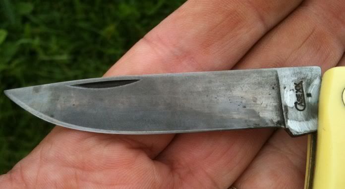

I'm dragging this thread back up to show off the patina that's been forming on this sodbuster jr. since I got it a few weeks back. I haven't done anything special to it, just used it in my day-to-day routine (which, thanks to having three little kids, does tend to involve cutting up a lot of fruit and so forth). The only maintenance regimen is washing the blade with soap and warm water when it gets sticky, and occasionally dropping a wee bit of oil on the joint. That's is.
Thanks again for the great knife, coyote711!
