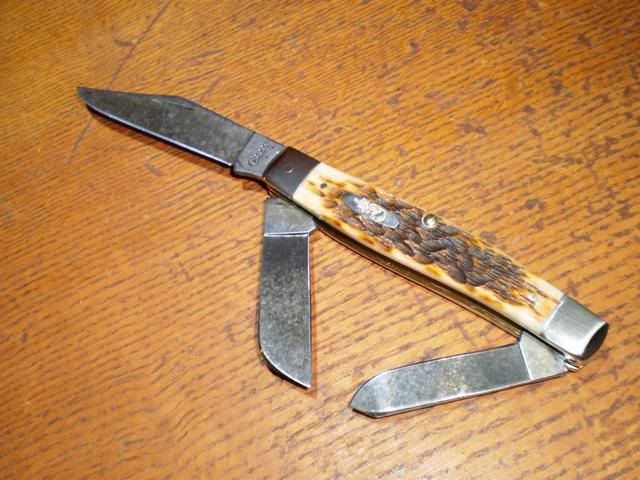

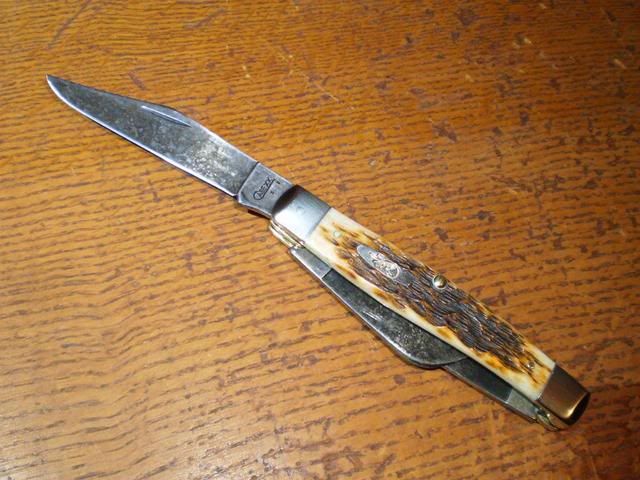

Just got this nice Texas Jack in CV, and spent the last 4 hours alternating between a gala apple and a naval orange to stick the blades in. ...
FORCED PATINA
EARNED PATINA
Let me know what you think!
I think that, if you were to carry the Texas jack and use it regularly, in time its patina would look the same at that on the scout knife.

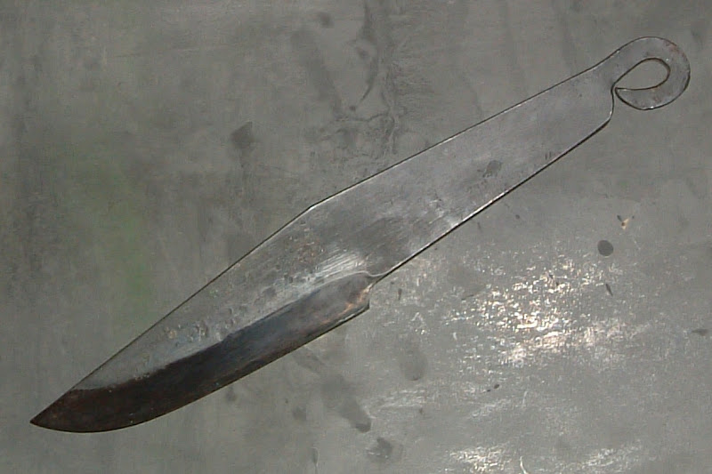

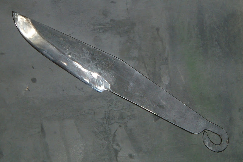

I've applied Brownell's cold bluing to a couple of carbon steel blades and the results have been pretty good. I'll try to post a pic or two.
My funnest forced patina was with ketchup, mayo, and BBQ sauce.
Wow! That looks almost like a color case hardening job. Sweet. I like the character of carbon steel cutlery even though my group of knives is stainless 8:1. It's getting harder all the time to get a good carbon steel blade.
EJ
Yes, please do. I'd be very interested in how that turned out.

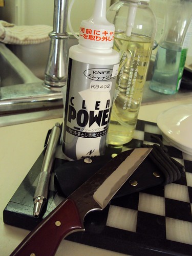

Here's a picture of my forced patina:
I had some rust on it so I used the Clean Power to clean off the blade (which removed the previous patina) and simply let the blade sit in a water/vinegar solution for maybe seven minutes. The results were nice and even, but it's not as dark as others here.

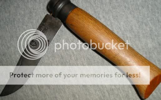

This knife has been used by me for over 20 years, a lowly Opinel knife....
But nothing has been forced and everything has been earned!! Even the handle has taken on a sort of patina if you will....
