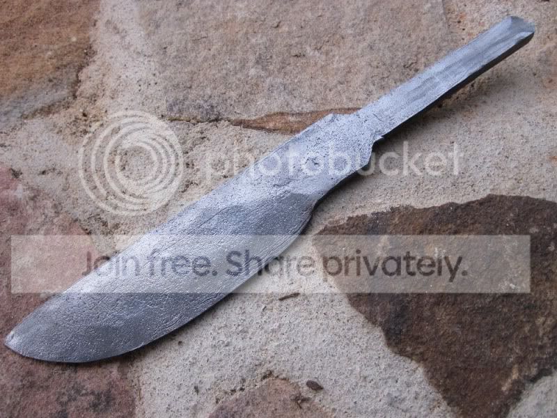

I just heard about the process of forging a knife complete enough that it does not need grinding except to sharpen. Is this a common practice or an exercise in careful hammering? Has anyone here tried it out? I am fascinated with the idea and would like to give it a try when the weather cools down and I feel more like running the forge.

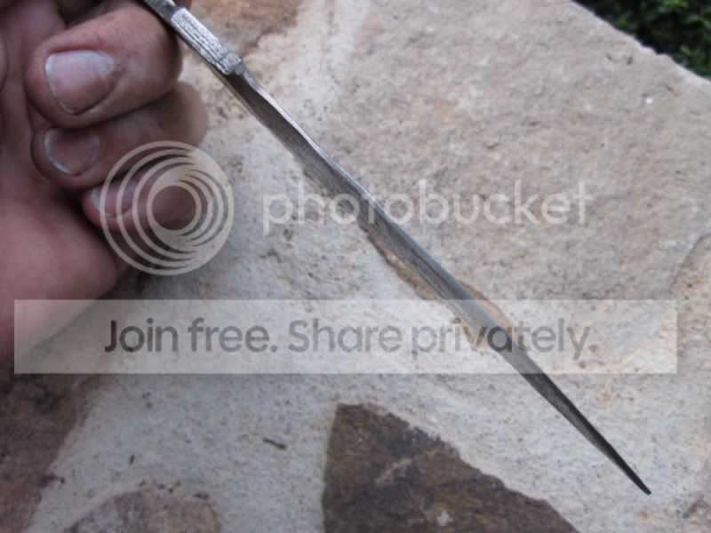

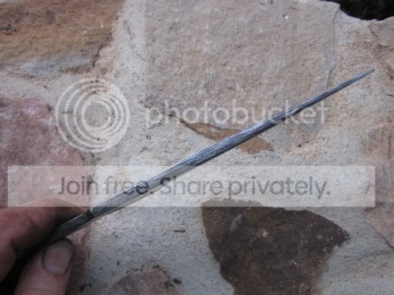

Here is a photo or two of one I'm doing with minimal power tools. Of course, you can see it was profiled on a grinder, but it's all hand forged, and will be primarily finished with files, stones, and paper.
It's soaking in brown rice vinegar as I type.

After a night in vinegar and a quick hit with a wire bush I am generally pleased with the outcome of my experiment but I have some concerns. The longitudinal lines in the blade make me wonder if I am forging too cold creating some slight overlaps or is this normal? I strive to create "waves"with the hammer as I am moving the steel toward the edge; is this what I am seeing here? And I can see that I need to sweep the scale off my anvil more often and dress the face of my hammer.
Looks good! unsure what the longitudinal lines are. My noob guess is since you have them on the spine and ricasso, to me makes it look like it was forged from wrought iron?
Jason
As Tai makes mention in his video, the steel will move in the direction of the heat, all you have to do is hit it. The only time I have ever gotten those ripples/lines was when I was "glancing" with my hammer in the direction I wanted the steel to go.
Edit to add:
Looking at it again... it seems like the steel is delaminating(not sure if that's the right word for separating) My second diagnosis would be thatyou are working it too cold.... but take that with a grain of salt. Let the more experienced guys chime in.
Rick

G L Drew, if that knife is forged from flat stock, etch part of the bar next to where you took the piece for the knife. The anomalies may be from the rolling process. If that is the case, try forging from round stock. I think round stock has less of this sort of thing.
Good Luck and Have Fun!
Alden
I think Alden might be right. They look like some kind of mill flaws. With hot rolled, you can grind the scale off (down to clean steel) prior to forging and check for those first.
