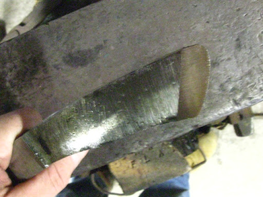

Hammer wise, I broke the stock down with an 8# double jack, did most of the shaping with my 6# straight peen, and wet-finish-forged the bevels with my 3-1/2# flat faced cross peen. Now I have a couple blisters...
There is a lot of steel in one of those drops, the overall length is 15-1/4" and the blade is 10" from tip to bolster. I plan for this blade to get green canvas micarta, SS corbys, and a hamon.

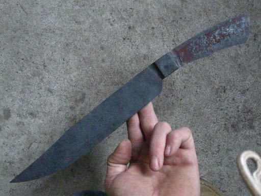

The blade is profiled. I threw a little bit of style into the grip area, and defined the clip more.

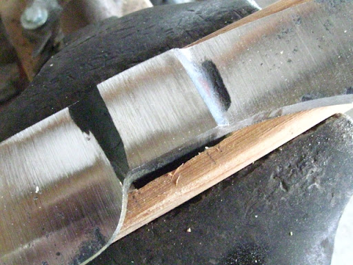

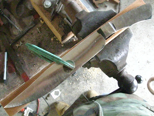

The blade with the scale roughed off of it. I did this and the preceding steps with a dull 36 grit Blaze. I keep roughly 20 of these hanging on the wall of the grinding room expressly for this purpose. Scale just kills a new belt. The blade is clamped on a board with a square hole sunk into it at the bolster. The board is clamped into my little post vise.
A closeup of my quickie knife board and the bolster area, still super rough.

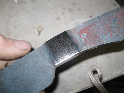

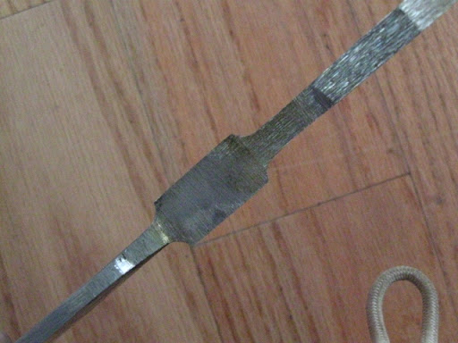

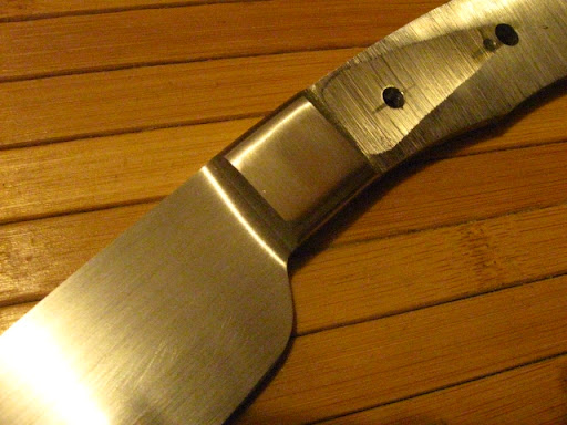

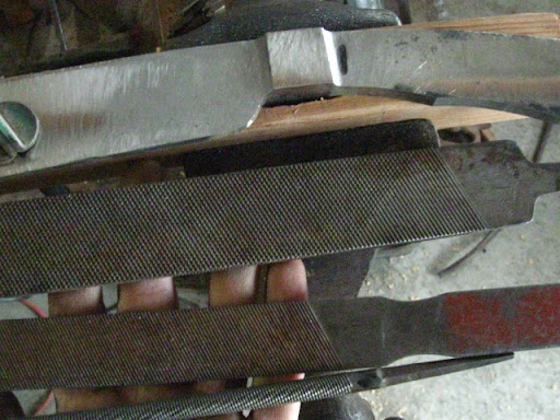

The bolsters defined more and the transitions roughly cleaned up and shaped with hand files. The files I used to do it. These radii are small, I can’t get my ½” wheel in there so I did it by hand. I prefer to do this slowly anyway.
The bolsters matched up better, still roughly.

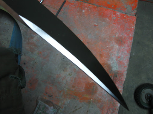

Grinding an edge onto the thick blank. This will serve as a guide when flat grinding, and doing this with a dull belt prevents stripping the abrasive prematurely from a new belt when grinding the flats.
Flat grinding, with a sharp 36 Blaze. The bevel has been nearly pushed up to full height.

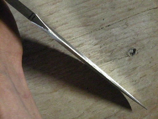

I first drew the false edge on, then roughed it in freehand with a 36 grit belt on my 8” wheel, using an up and down motion with the blade vertical, sighting down it with strong light.
They match ok now.
The blade rough ground with the swedge/false edge. Sorry, kind of a dark pic.

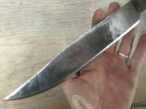

Cleaning up the swedge with 240 belt, slow speed, 8” wheel.

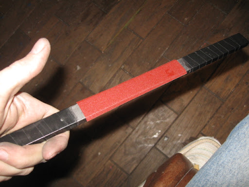

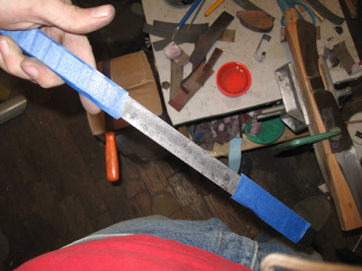

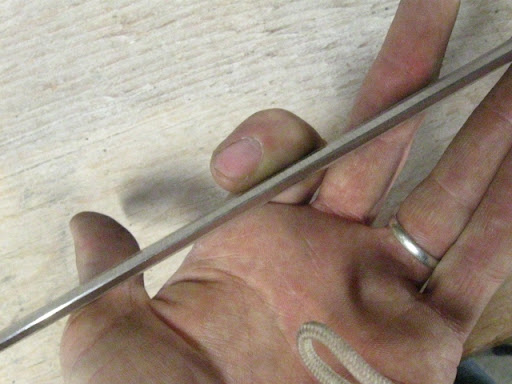

SO, I turn to my trusty Don Fogg style sanding bar. It’s just ¾”x 3/8” mid steel bar stock, ground flat, about a foot long with electrical tape grips. I mask the grip area off, spray lightly with adhesive, unmask, and I’m good to go. Usually I have to spray it only once for one knife. Just peel off old paper, stick new on.
Armed with 280 grit Rhynowet Redline paper. This stuff is great.

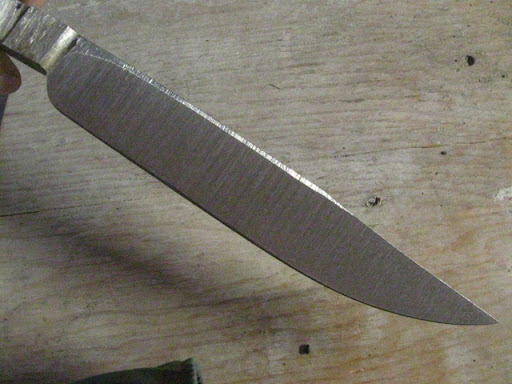

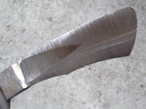

I took the 36 scratches out by hand with 280 grit. It wasn’t bad. Of course, this is normalized W1. It’s starting to look like a knife. Also, I rounded the edge of the bolsters and drilled the tang holes so I can hang it while the clay dries.
I cleaned up the bolster transitions with 280 grit. Found objects often work well for small sanding blocks, in this case I used a Bic pen tube. The perfect thing.

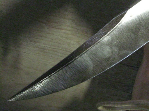

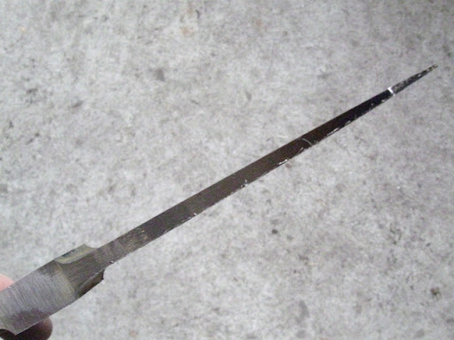

I cleaned the entire blade in front of the bolster to 280, including the edge, spine, clip, and heel. I made sure that all 280 scratches run lengthwise. I convexed the edge just a little with the sanding bar, it’s at about 0.040 the entire length.

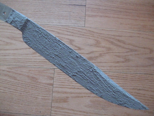

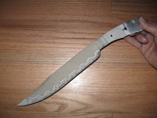

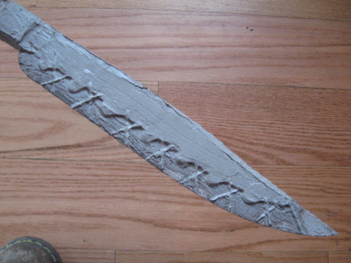

I applied the first layer of Satanite, as thin as possible.
I added dips in the edge of the Satanite along the bevels, and ashi on both sides. I used a popsicle stick for the main clay and a razor blade for the ashi.

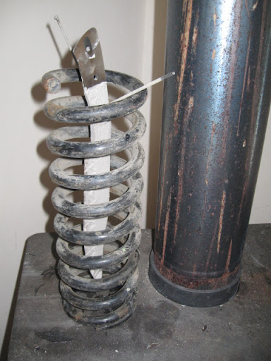

I put an old welding rod through one of the tang holes, and suspended the blade inside my super sophisticated drying support on the stove. This only works with a GT Mustang coil spring.

Carl, this sanding bar really helped me. Until recently I sanded all of my blades with a much smaller, wider micarta block. I held the paper around it.
The last big blade I did, I really got fed up. After sanding it to 1000, I could barely grip a pencil. So I built this. It took me about 10 min. or less. Smartest 10 min. I've put in for months. Now, instead of my forearms and thumb muscle tiring from gripping the dang paper, I can have a relaxed comfortable grip on both handles with no worry. Now when I get sore from sanding, it's in my shoulders. It takes a lot more work to do that, and I don't mind it nearly as much. Now I can get above my work and really lean down onto it to get the most out of my paper and calories burnt.
Also, the reduced width allows the paper to bite more aggressively, and since I don't have to hold onto the edges I can cut my paper more narrowly and thus get more mileage out of it.
Did I mention that I like this thing? It's great for smaller blades, too.

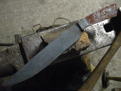

Just went through yaki-ire. I use this term because I water quenched. Actually, warm water for a three count, then preheated oil.
I did not hear or feel a "ping" so I'm cautiously optimistic. I'll really do a dance if when I take it out of the oven after the temper cycles and shine it back up to do a quick etch to check it's still not cracked.

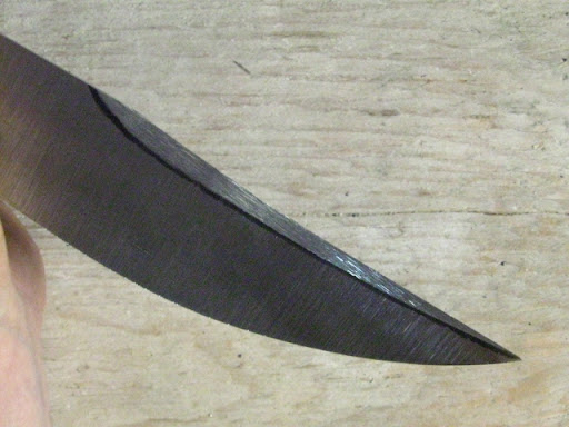

I got no sori to speak of, and it looks like the clay uniformly blew off the thin part that I wanted to harden. Appearance suggests that the hamon will approximate what I intended. I don't even think it warped significantly.
Of course, I may be whistling a different tune in four and a half hours. I'll keep you all posted.

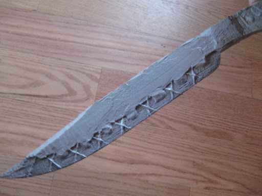

Here, by the way, is what the blade looked like when dried on the stove. After this and before HT I stuck it in the oven at 450 F for an hour to make sure the clay would not pop off in the forge. That way, the oven was also preheated to 450 so the blade went right in after quench.
