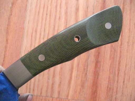

I shaped the handle and prepolished it. I blocked the profile out with an 8” and 3” wheel, then hollow ground the sides in with the same two wheels. I left the front of the rear hollow with a defined edge from the 3” wheel. The grip is designed to fit the hand well, with a flare at the end to keep you off of the front page.
I try to build a handle with some style and looks that’s still easy and comfortable to hold on to. It’s easy to make a “blob” handle that’s kind to the hand but has no individuality.
After shaping to 220 on the grinder, I moved to hand sanding with a block. Come to think of it, I meant to post a pic of that block, which works great for me. It’s basically a contoured piece of wood for a handle that fits into the palm, glued to an eraser for a pretty stiff blending type pad. I can sand with it over fasteners and wood/metal joints with out leaving the metal proud of the surrounding material.

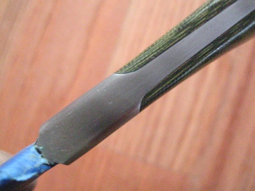

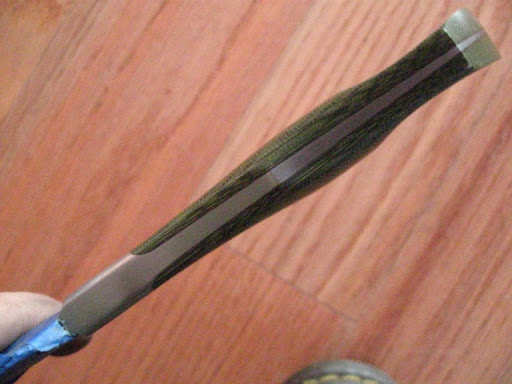

I hand sanded to 400, then gave it a quick buff with white rouge. This is good for now, I’ll go over it more later. Here’s some pics:

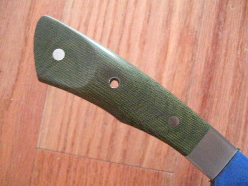

View from the top.
View from the bottom.
The sides. No appreciable glue gaps.

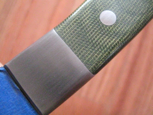

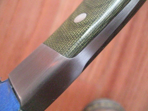

Cool, I didn't grind into the Corbys too far... here's a shot of one of the corners dead on, still no gaps.
The butt, closed up well.

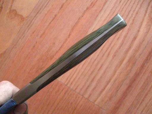

The taper and palm swell from the bottom.
From the top.
That's it for now. I buffed it already to check for any faceting or bigger scratches. There are a couple spots that I'll go over with 400 again, then it's up to 600, dragging the finish on the steel areas and final buffing the micarta and fasteners. But next, I'm going back to bringing the hamon out. See you all soon.

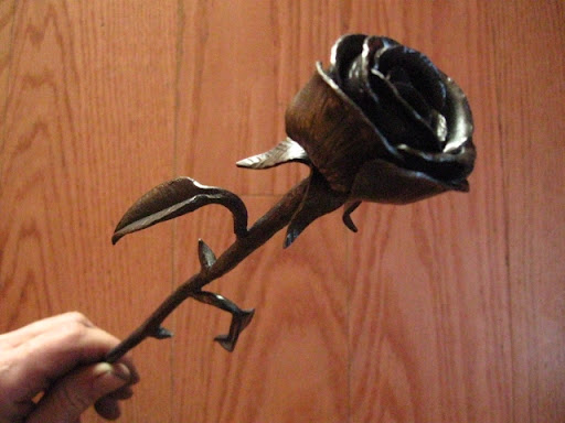

If anyone is wondering, I’m still going to finish this WIP- I’m waiting for some abrasives to come in right now so I can bring that hamon out farther. In the meantime, I celebrated my 5th anniversary of marriage, and forged this rose with thorns for my wife as a gift…

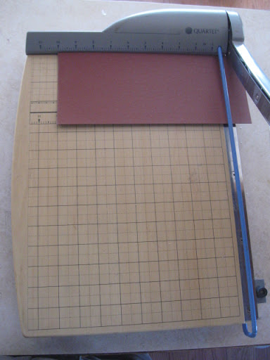

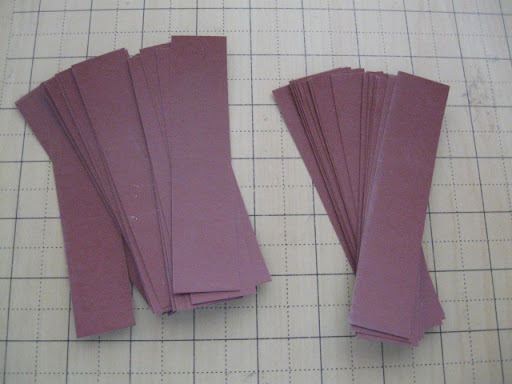

Some of you may remember a thread started fairly recently by Patrice Lemee- what’s the best way to cut batches of paper into sanding strips? A common answer was “shear-type paper cutter.” Well, I was rooting around in the “random junk” section of a Goodwill store, when I saw this beauty pictured below. $5 and it was mine. Of course the blades needed some help, but hey, I’m a knife maker, right? It now cuts really well, I cut up two sheets of paper at once into a total of 44 inch-wide strips evenly in about 15 sec. It’s awesome.

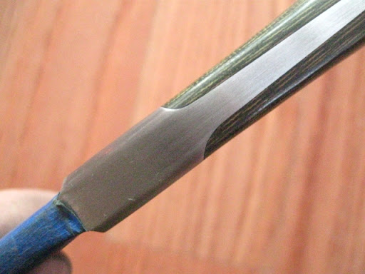

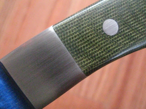

I had left off at 600 grit last. I now started in with 800. You all know what that looks like, just like the sanding pics earlier in this thread. A couple shots of keeping the clip and bolster transitions clean and caught up with the blade grit.
I switch my water out with each finer grit, switch paper towels too, (for blade wiping) so as not to scratch with larger grit by mistake. Every other grit I sand at about 30 degrees, then the next grit in line with the blade. I wipe the slurry of the blade at the same angle I sand, sometimes streaks can look like scratches and drive you nuts.
Would you believe it took me a couple of minutes to figure that one out?:(

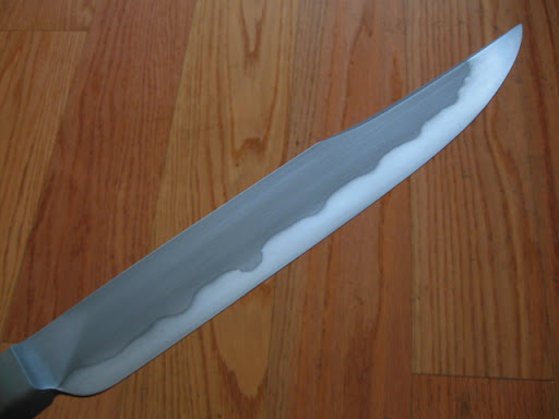

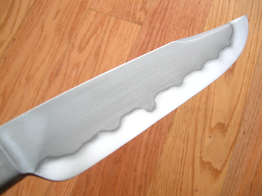

I mixed a fresh batch of ferric chloride yesterday, my old stuff was not acting right anymore and this blade has to come out well. I use anhydrous ferric chloride. I filled my etch tank to determine what the volume was. I came up with 3-½ pints, or 52 oz. At 52 oz water, 52 oz dry ferric chloride would give a 42 Baume mix, or the concentration you get liquid from Radio Shack. That’s too strong for my needs, so I added 9 oz. dry ferric for about a 1/5 ratio ferric/water mix. I let it sit overnight.

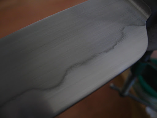

Today, I made sure the blade was clean to go, made sure water would sheet over the whole blade, and held it in the ferric tank for about 45 sec. The hamon became immediately obvious. I windexed it, water rinsed, and dried it. I went over the blade evenly with 2500 grit paper on the leather backed stick to get the oxides off and have a closer look at the hamon. Below is a pic after the first etch and 2500 passes.
Another etch, and some more 2500. Just trying to establish the hamon right now, detailing will be later.

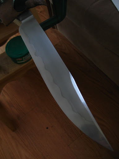

After three etch/sand sequences, I etched again, then took some little cotton squares (makeup type, thanks for the tip, Nick) dipped in water, then dipped in pumice powder and started lightly scrubbing the blade with it. It took oxides off the back and edge alike, but seemed to affect the edge differently due to the hardness. Following this effect, I rubbed the area above the line just enough to keep it looking an even gray satin color, but concentrated mostly on the hardened area below the line. The pumice had a whitening effect, I followed the line and rubbed everything below it to a frosty white look. I re-etched the blade lightly (15-20 sec.) several times, rubbing a bit more each time, trying to refine the dark back/white edge look further. I took the following pictures as I went.
I did not find that this hamon had a lot of activity beyond the very definite wavy line, but was able to bring it into hi-def pretty well with the pumice. I’ve heard to use rottenstone for this, when I’m able to get some I’ll try that. The pumice worked well, but seemed a little coarse for the soft area above the line. It worked well for the edge, maybe I’ll try rottenstone on the back and pumice along the line and edge next time.
It’s been a different experience than finishing oil-quenched hamon blades with a “user-type” finish. This is more delicate but rewarding, I lost track of time but it took all morning and I was having fun the whole time. I want to achieve a more translucent finish in the future.

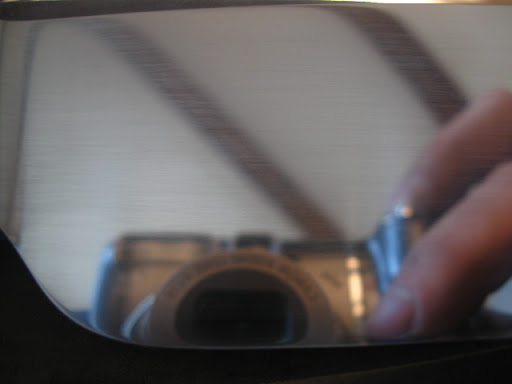

This is turning into a GREAT WIP Salem. That's the best photo exhibition of hamon polishing I've seen yet.
It also takes messing with the white balance, colors, and focus on your camera as well as having natural light and playing with the angles while looking at the camera screen to catch the blade right. Of course it's different to hold than it ever will be to look at a picture of.
