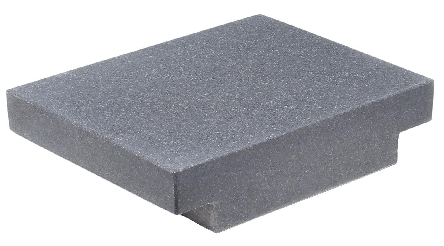

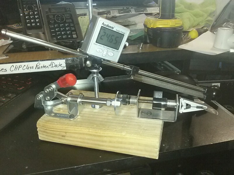

This is the working R&D prototype. Still some changes. It will be mounted on a hefty polished piece of granite.

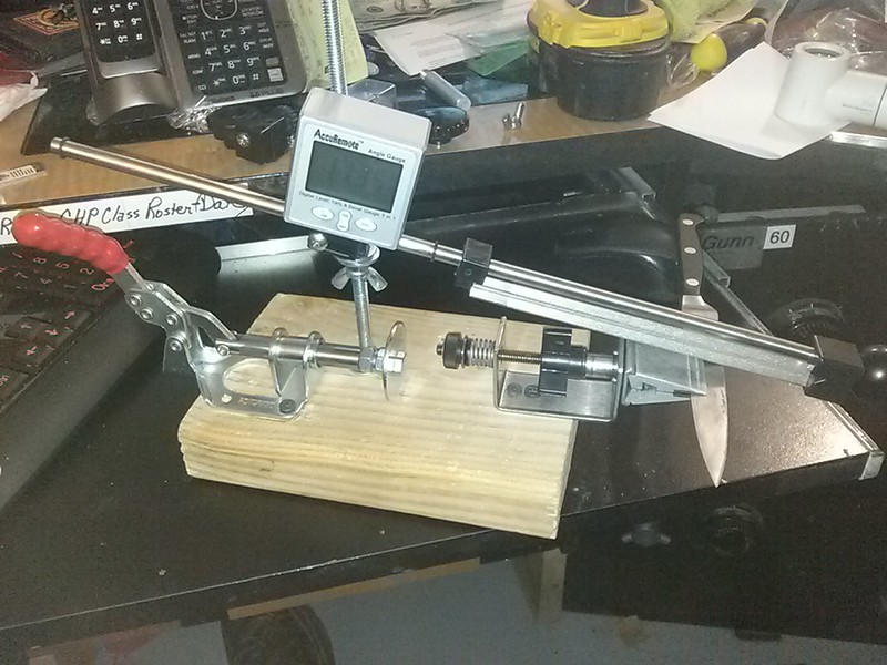

this sharpener does essentially what a KME does, only with more emphasis on home use, and less on portability.

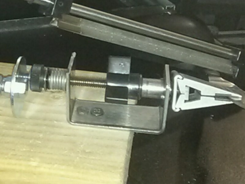

The jaws now have a release. red handle) The jaws now have two sets of bearings to make clapping and turning easier.
Pull the red lever while sharpening in, and the jaws spin with no resistance. Release red handle, and the jaws grab at level again.
If the pressure knob is loosened, when the red lever is pulled, the jaws open to allow easy insertion of the knife.
Before I start drilling in granite, anyone have suggestions for this project?

Bugger to load, till you get the gist of it. I am going to heat up a diamond rod, and let it heat a detent pattern into the plastic. That will help. In ten knives, no dropped rods yet, but an exact dedicated spot would be better.

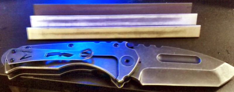

Not only does it work well, look at the wear pattern from this knife, is right down the center of this rods.

More parts came in today.
What to call this Sharpener? FrankenSharp? Parts used from all the leading sharpeners, to make something bigger.
Presenting FrankenSharp. Does 10 degrees, to 45 degrees for scissors, up to 50 degrees.
Lumber will be replaced with second piece of granite, once I am sure all R&D is out of the way. Total weight of granite is 40 pounds and 5" in the KME area. (overkill)

I do not remember if I tried putting the jaws directly on the EP or not. Sometimes I miss the obvious! Well Done! Only function I see not present is a jaw clutch. Having one now, I am not going back. It allows you to run the jaw pressure twice as high, and still turn the jaw 180 with no pressure.
Congratulations on having the courage to modify the height adjustment by REMOVING IT!
Add a set of roller bearings, and you will be happier with your KME.
