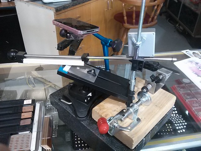

Wow, cbwx34 has been reading my mail. A marriage made in heaven. I'm getting my parts together as we speak so I can steal a page from the cbwx34 book. Got my KME last week with the new diamond stone set. My EP Pro clone should be here Monday. The plan is to attach the KME diamonds to the EP plates so I can use them with the EP arm. Not an ideal set up, but I should be able to use the smaller stones o.k. Then find the best way to use my Spiderco triangle stones. As NRA mentioned those are really good stones so being able to incorporate them is a big plus. Thanks for all the great idea's gentlemen.... Jeff

Still tweaking placement of components, so I have not retired the 2 x 6 lumber yet, in favor of another block of granite, but I will once it is nearer to completion.
The granite is on a lazy susan, so turning it is easy. The mass of the granite makes the sharpeners stable, and they stay put, unless you wish to rotate them.
I have yet to use the camera component, but that should be an interesting service to someone anal sending me their knife to sharpen. They can see the whole process, even before getting their knife back, if they mail me the knife.
The magnets in the EP base do a great job of holding knifes. Just about negates the reason to get a KME in the first place.
One edge of my granite base is left free of components, so you can lay two SharpMaker rods side by side, and place the guide rod on them. The granite base is guaranteed flat to .0001 so that should be close enough. lol
It is easier to put two SharpMaker rods on the guide rod, than one single SharpMaker rod, because you end up with two points (per end) to place the guide rod onto. Keeps everything all lined up.
Total weight of unit, is around 60 pounds. Measurements of base is 12" x 9' x 5" tall.

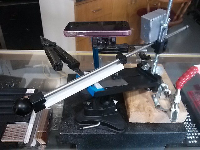

I am closer to finalizing my FrankenSharp project
5" thick of guaranteed flat granite surface plates.

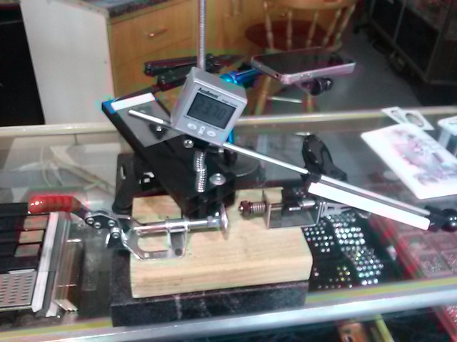

I made a jig in the base to place the SharpMaker rods on the EP guide rod. The granite base is flat to .0001 of an inch. Putting the triangle rods on the guide rod is just as easy as the original media.
I seriously doubt I will ever use any media in my FrankenSharp except SM triangle rods. They are perfect for the job, and you cannot wear out ceramic sharpening rods. They are much harder than the steel.

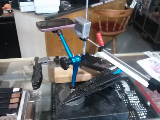

I love the vertical horizontal jig I placed under the KME jaws. This makes the system wonderful for checking progress without straining to get your eyes, back, and looking for light all in the proper placement.
When the KME was portable, you just lifted it off the tiny stand, and looked at your edge. Once I placed the KME jaws on granite, I lost that ability. Now I have that back, and I find the ability to see what is going on, paramount in the sharpening process.
Shows the KME jaws in a vertical position to check progress.
Weight is about 50 pounds, and rotates comfortably on a lazy susan. 2 sides of the 12" x 8" main base have hand holding groves, so picking it up, to move it, is not difficult.
I was able to tuck the KME and jaw release, under the EP, saving a bunch of space. Because each sharpener is 90degrees turned from one another, they do not interfere with one another. One vertical guide rod support is shared between the two sharpeners. Just turn the granite base, and use the other sharpener.
The KME is mounted on Oak, as I could not work out all the varying heights needed to make that work, using granite.
Because all the pressure on the guide rod knuckle is always pushing up, I placed a spring under the knuckle, and an adjustment nut above it. I will use a wing nut above the nut, to synch it tight. Because of the threaded vertical rod, exact angles are possible. Just check the angle cube, and dial your exact angle in. The angle cube can stay in place through the whole sharpening process so you can check your work.

How do you attach the angle cube to the rod? Sorry if i missed it. Also dont you have to take it off to zero to the table. My cube shuts off after a few min., does yours?
