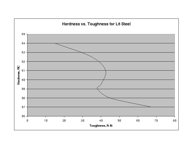

It all depends on your definition of "brittle". All steels, regardless of the alloy, will be stronger as they are harder. Stronger means that it will take more force to permanently deform them. At the same time, all steels will be less tough as they are harder. Less tough means that cracks will run through them more easily. In particular, when steels are too low in toughness, a small defect can cause failure at a load below the yield strength due to crack propagation.
The plot below shows hardness versus toughness for L6 steel. Toughness is measured by Charpy Impact Energy, which is the amount of energy necessary to fracture a 10 mm square specimen when hit by a pendulum.
I'm not proposing that L6 is a great knife steel, but it's a steel I have this data for. If I were making a knife out of L6, I certainly wouldn't want to go harder than HRC62, because the toughness gets too low. And if I were making a machete out of L6, then I might even keep the hardness down to 57, because the toughness is much higher.
So, in my opinion, you want to have the edge as hard as possible to allow you to make a very sharp geometry. But if the edge is too hard, it will have a tendency to chip. At the same time, once you get enough strength at the spine of the blade to avoid bending, there's no benefit to increase the hardness beyond that point, because you're increasing the probability of fracture under impact load.
I hope this helps explain our justification for leaving the spine at 45, and putting the edge at 67 or higher.
