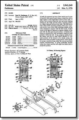

Can't find any info on this thing but it looks like a Paul Axial Lock. Are you familiar with those?
I'm note sure. The Hidden Edge can't be dissassembled as far as I can tell. I've tried for cleaning the purposes, but no. It's sealed not screwed together.
It does appear to be the Paul Axial Iock mechanism looking at the mechanism. It freely opens when the button on the side is pushed and locks up fully extended (button fully) comes back up. Push it again to close. The button is the detent.
Not so smooth anymore, cause it can't be opened. Or maybe it can with some super glue and pliers. It truly was an innovative design back in the days like twenty years ago. Slick. It's never really could be made sharp though. Just okay (mystery metal used but US company).
