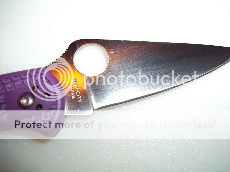

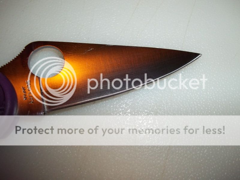

I worked on my knife some more tonight. A little background that I don't think I gave above. It's a Spyderco Delica that I bought used. The blade wasn't scratched up, but it had a noticeably shallower bevel than my other (new) Spyderco Delica with a factory edge.
Tonight I worked it for a good hour with the edge of the medium Spyderco Sharpmaker rod and then finished it up with the flat side, fine rod and finally a strop. It is better, and can cut paper now, although not as consistently as I'd like. It is not shaving sharp yet, but it is close to what I'd deem a "working edge."
The real kicker is just before sharpening the VG-10 Delica I sharpened a very seriously dull Leatherman blade all the way to shaving sharp. The softer Leatherman steel sharpened much faster and ultimately got MUCH sharper than the VG-10. I imagine I'll get advice that I need to rebevel the edge on the Delica with the diamond rods and now I believe it. However, tonight was a good learning experience for me. And I did make some good progress and learned a lot about how much harder the VG-10 steel is from softer steel.
The following pics are about the best I can get with my camera.

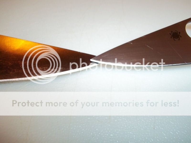

Here it is side by side with the factory edge of the other Delica. The factory edge is on the left.

Mud Shrimp Moe, thanks for the pictures. In the first two pictures the edge looks almost like someone tried to convex it before. To me it looks like you are only sharpening the bevel close to the tip. In the second picture it appears that you are hitting more of the shoulder than anything else. I could be wrong because it is hard to tell in pictures. I think that the edge needs more reprofiling before you can go all the way on the Sharpmaker.
Just my two cents. You are close man.
....Here it is side by side with the factory edge of the other Delica. The factory edge is on the left.
I have an Endura that came with an edge like that (rather thick/obtuse). That definitely made it harder to put a sharp edge on it. I finally used a DMT Aligner & Magna-Guide with C/F/EF/EEF Dia-Folds to put a more acute bevel on it. Still took some time to get the edge REALLY sharp (due to the wire edge issues I mentioned earlier), but the results were worth it. On your blade, if the bevel was close to, or even more than 40 degrees inclusive, that could've contributed greatly to the difficulties on the Sharpmaker. Thick edges like that will more frequently make contact at the shoulder of the bevel, instead of on the edge itself.
I think the steel in the Leatherman tool's blade is something along the lines of 420HC, hardened to mid-50s RC or so, and with a very thin edge grind. All of that makes those much easier to sharpen, as you found. I have a Wave and a SuperTool, both with blades like that. That's a good basis for comparison against your VG-10 blade; really brings out the differences between some steels.
