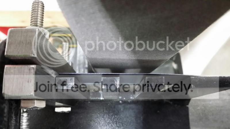

Use a Bubble Jig, there's no need to mark a center line to get the edge in the center of the blade. When the grind lines are at the same height, the edge is in the center of the blade, the bevels match and the plunge lines match. Its not rocket science, but it helps to use a technique that offers success. It is a matter of practice, but practice a technique that will produce good results.
You can hold a 1.3 degree approach angle per side; the grind will go faster as well. No multiply facets on the bevel to correct or blend. No mistakes to throw away.
I can grind free hand; but never do, why risk failure.

For me it is important to mark center lines, and I think it's more important for those who are *learning* to make knives to mark centerlines as well, so that they can develop an eye to tell if the edge is centered of not. Say there is a very slight curve in the blade stock etc., I think a granite surface and a height guage (which I 'FINALLY' just now got!) are two things a person would really want to have, especially grinding large kitchen knives. Of course that's just how I see it. Just like using a bubble jig to not risk failure, that's what I see using scribed lines doing for me.. well I actually don't trust my skills yet to do without the lines lol. BTW Fred, I love my bubble jig! :D Thanks man!

Hi Paul,
I can appreciate that. Scribed center lines help a new maker to be more assured that they are on the right track. A good visual check when grinding with BJ, the blade held in the grinding clamp; hold blade/clamp so that your looking through the end of the clamp down along the cutting edge of the blade with a back light shining on it. You can see immediately if the edge is centered, its similar to looking through an iron rifle site. When I used scribe lines I could see those along the edge as well. :)
Fred
Hi Paul,
Fred
I actually bought just the jig from you without the clamp because I couldn't afford both at the time, it was a few years ago and I orderd over the phone :) I use a crappy homemade clamp (file guide type thingy) that I have to make sure the screws are tightened the same amount on the spine side and edge side so that both sides are parallel to eachother (which takes forever), otherwise when I switch the jig to grind the other side of the blade it could be off by a couple degrees, it's deff a PITA :( I really need to get one of your clamps sometime so I can actually enjoy using the jig instead of dreading having to set up my "file guide". Also it would be nice to use that as an extra refference for a centered edge. Thanks for the tip! :)

I have heard people reference this before, what is the granite for exactly?
Google "surface plate"
I got mine fro enco for $40 when they were doing free shipping. I use one in conjunction with a height guage to scribe center lines. Its nice for rescribing the line after heat treat.
You can also use a cheap set of calipers to scribe center lines. Really, scribing a center line is so easy, there's really no reason not to.
Even if you do an even number of passes or measure the bevel height/plunge line on with side, the evenness of the grind can get away from you. Especially closer to the tip.
