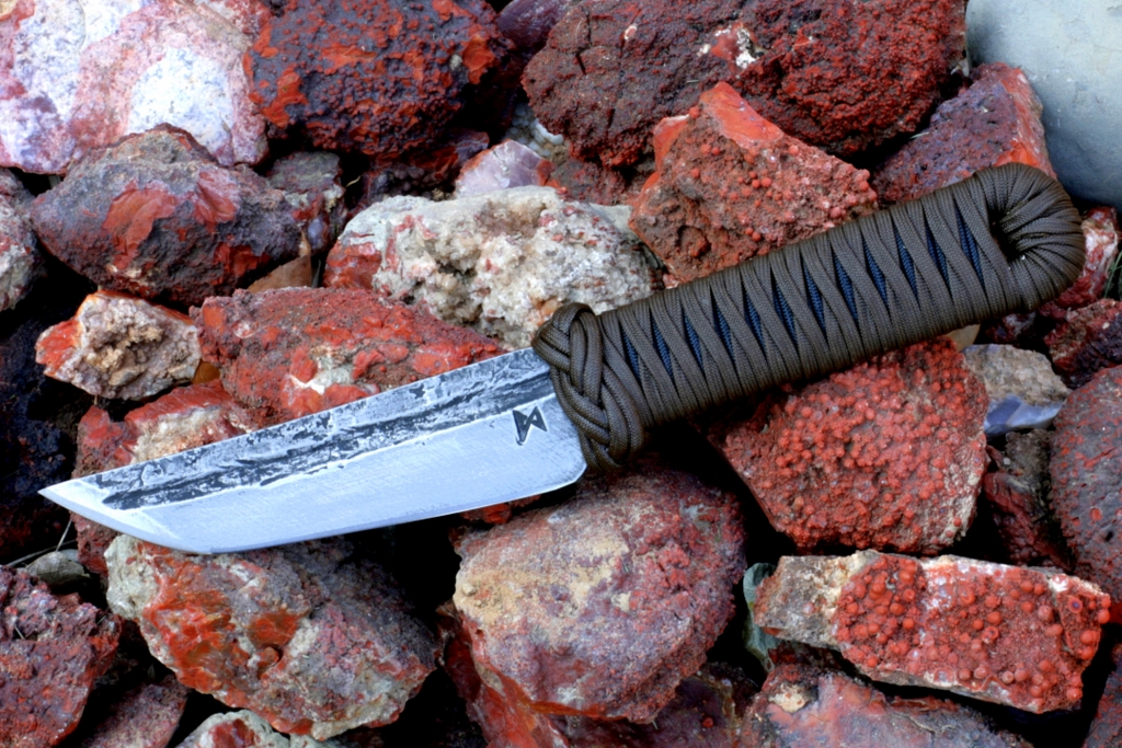

Love that hinderer, the fuller looks nice and apparently adds strengthI think these two are my only knives with fullers. A Camillus survival knife I picked up in DaNang in 1967, and a 3 1/2" Hinderer.
View attachment 2678389View attachment 2678390
No, wait. Here's another:
