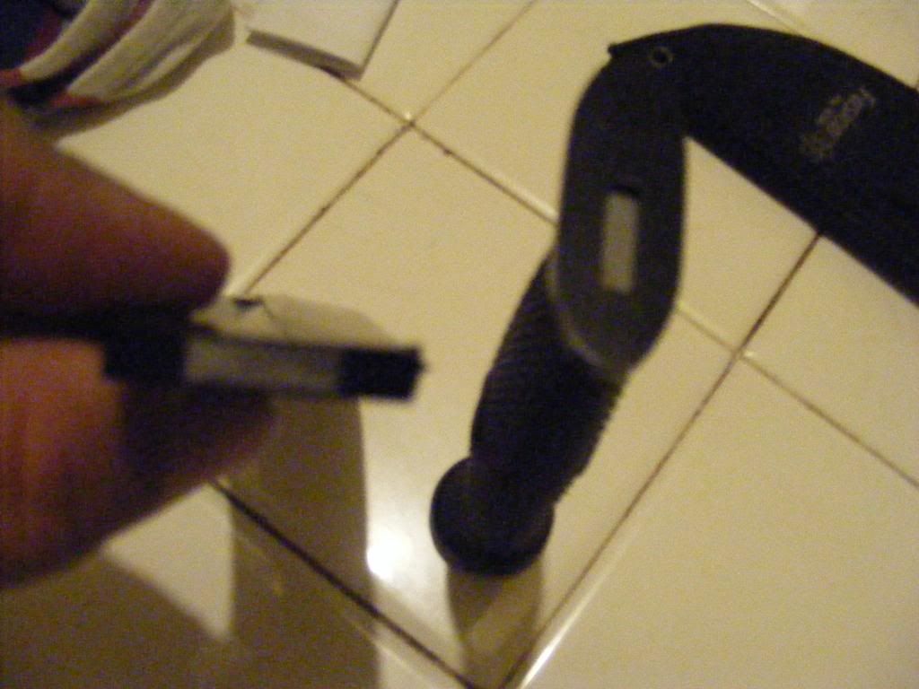

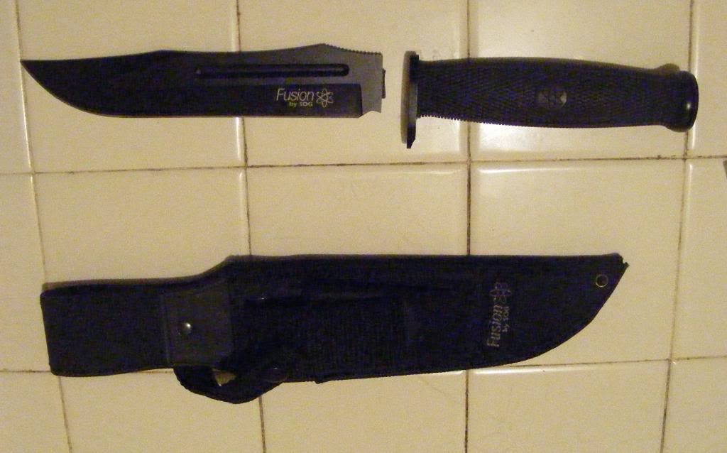

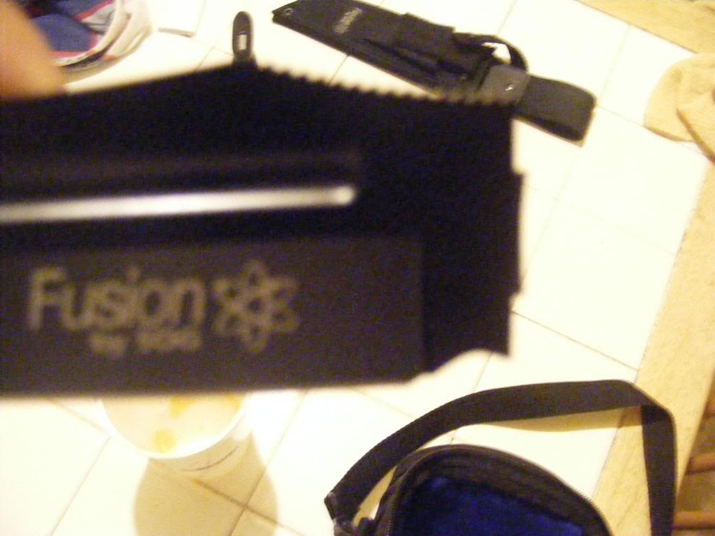

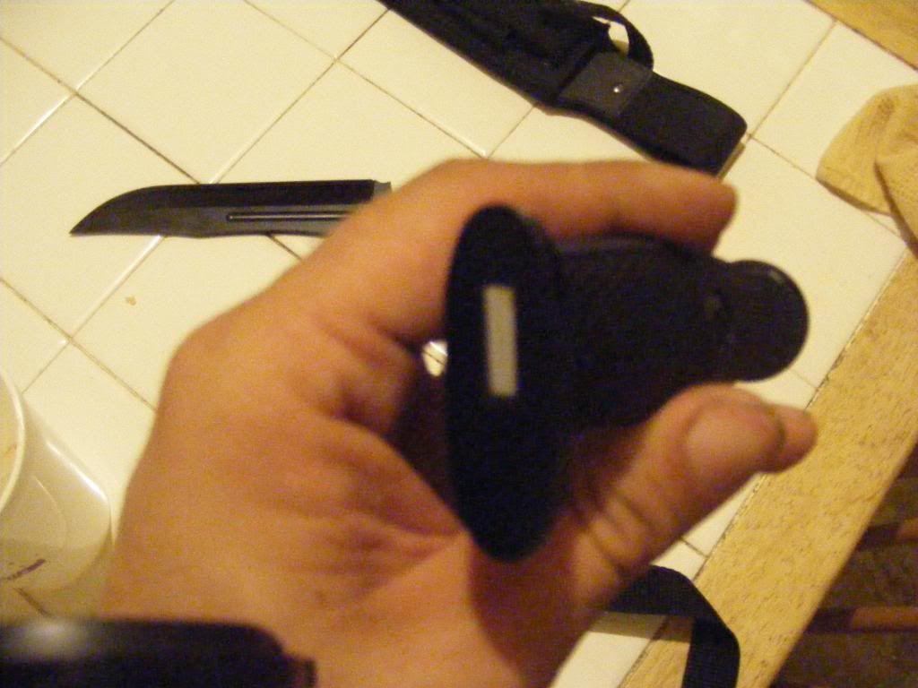

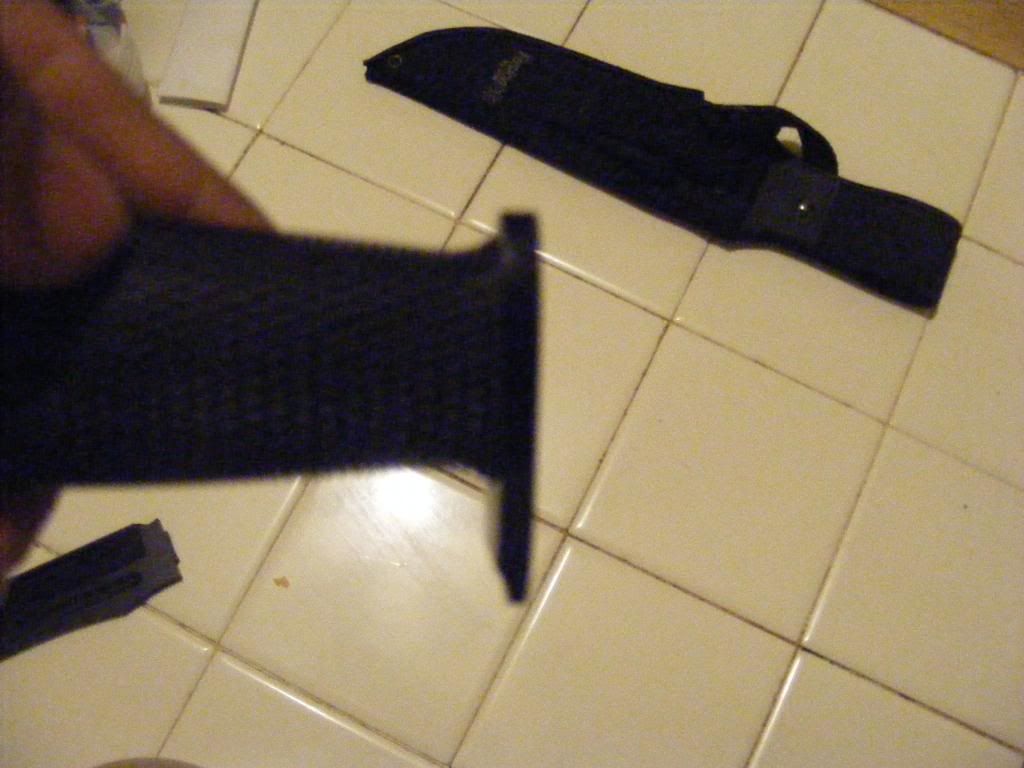

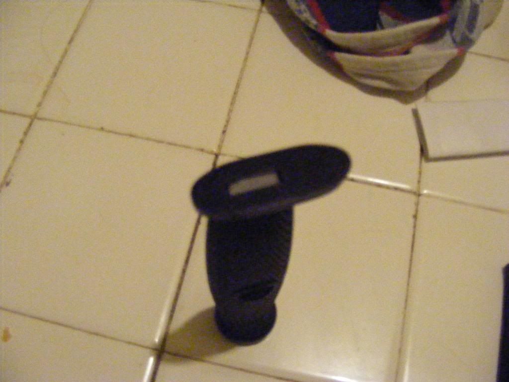

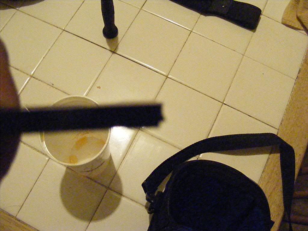

Here are the photos, with a brief description of each.
The knife as it is now...
The handle...
The blade and handle together, showing the break...
Close-up of the blade tang...
Looking at the spine...
The handle at the break...
Looking down the handle...
I'm returning the knife tomorrow morning to the store I got it from, who will then send it to SOG. I'll write up a review of the Fixation Bowie as time permits.
Blurry shots, but the tang doesn't look like it is one piece right?
Seems like the blade and another piece of metal were weld together and then stuffed into a handle. If you look at the link I provided in my earlier post the article shows how a breakage at the point similar to yours can occur.
Regarding the funny tang, it sure doesn't look like the Seal 2000's...
Like Robert said, don't exchange it for another Fusion Bowie! :rolleyes: Exchange it for another SOG like the 'Seal Pup Elite' or the 'Seal Team Elite'. Or get another knife like the 'Fallkniven S1'. Great knife and I have one too! :thumbup:
