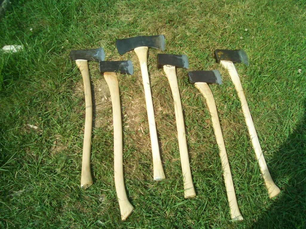

i snapped this pic a while ago for the old "1, 2, or 3 axes" thread. Things have changed a little since then but it still a nice pic.
L to R is a little Walters Black Diamond around 3 pound, a 3 pound Spiller (love this axe, use it all the time for hewing, falling etc), 3 pound Bellknap double bit, 3 pound Snow & Nealley (you guys starting to see the trend in weights?), 2 3/4 pound S&N, and a heavier Walters which is about 3 1/2 I think. All of these except the Spiller have G-pig Made Maple handles.

Seem like a 3 pound head on a 30-32" haft is unfortunately an extinct species of American axe (no longer made). This is my vote for Council Tool's next new axe.
Thanks. Its a great little axe, ill snap some more pictures of it, took a nice filing.

I would love to see a non velvicut 3 pounder, or even a 2 3/4 pounder with extra cheek material that is just tapered out into the edge (not unlike a wedge pattern :rolleyes:). If it provided enough material to shape how people want it would have a niche market for sure. It is a superb combo. A 2 1/2 pound on a full 28" handle is certainly underrated in terms of hitting power though. Snow & nealley used to call that size/weight combo a Men's axe some of their catalogs, not a boys axe (that was 2 pound on a 26" handle). Swing a nice full weight size one around and you understand they have some pep to em.
I actually just cut a 32" handle off a 3 1/4 pounder a couple weeks ago. Peter Vido talked about 32" as being fairly long I think, which I didn't "get" until using a 29"-30" handle for a while and switching back. 32" is a nice size for a lighter splitting axe though. My main splitter, a 3 1/2 ish MWH reversible double bit, has a 34" oak handle and its overkill sometimes.

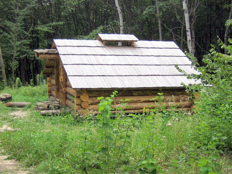

Some real craftsmanship in that cabin. But I don't like the beams hanging out like that. Here in the NW those all rot off and frequently are neglected to the point where the whole beam needs replacing. Better to keep everything under cover. Wanna shelter the door? Build a gable or wide roof overhang.
Yeah, not that I could build anything half that nice, but it seems that stretching the roof out to meat those rafters would be good for many different reasons.
I think that was a timber cutters cabin from what i read of the caption. Usually with those kind of remote cabins cutting corners is par for the course. I'd have to see the inside etc. before judging it. it is pretty though.
This isnt mine, but I wanted to post it anyway since its a great pic
A while ago you were talking about building something timber framed. Pictures like this show what is possible on a scaled down plan. That one looks about 7-8 feet tall from top to bottom, am I seeing it right?
Yes, been all over the place in terms of ideas. Glad I had the stint with timber framing, it helped me theorize a floor system for something built with logs. In the end, the complexity of the timber frame sort of turned me away from it. Log building has a slightly less sophisticated background I think.
I cant tell for sure, with this being the only picture of it ive seen. its short though, with low walls. That tends to require less material but a little more skill in cutting the logs to pitch the roof like that. its a series of tradeoffs like that ive found.

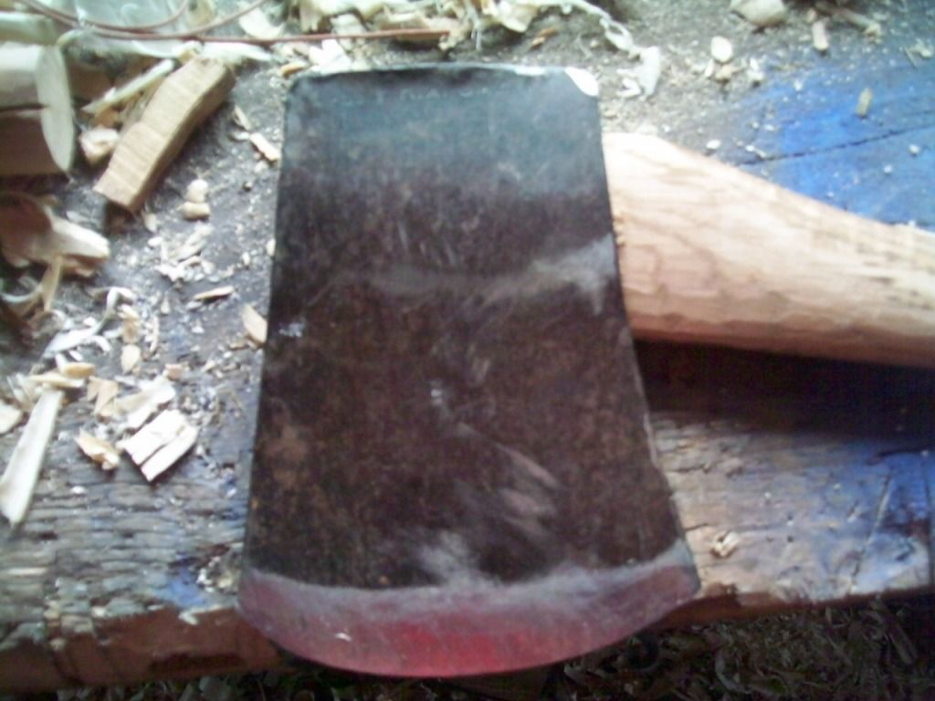

Vintage axe, here is a closer up pic of that rixford, showing the filing job. i want to thin it a little bit more but it still cuts great like this.

That rixford looks nice. As do the door hinges! I like your selection of the wood to use its natural curve to meet your needs. Well done, my friend.
