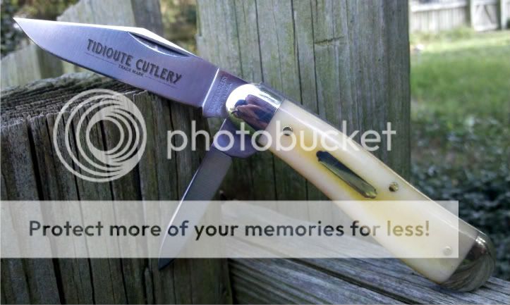

GEC 3 1/2" Dogleg Jack
If the run-up was large enough to be flush with the backsprings when open; think of how high and obtrusive it would be when closed....
Mike,
Are you saying the blade and spring are not flush when open by design?

Mike,
Yes. They don't make each one from scratch then start the next. They cut out every piece in its own time to pre-determined specs then assemble the knives.
Just look at the knife in your hand and think about it for a minute. If the run-up (back of tang) was left large enough to come flush when open; it would also be same height higher when closed. Then there would be moaning about this sharp edge riding too high.
Other solutions would be to trim the backspring or the tang radius; both of which would weaken the knife.
You have a knife design with a small end carrying a large blade. They didn't always make knives so that the collector could see all flush interconnects when opened/closed. Some used to (and still do) make knives as heavy duty functional tools; that just happen to be collected for that reason. Case didn't make collectors 100 years ago, they made users.

If the Chinese can manage it on a $5 knife I would expect that GEC could do it on a knife that costs far more. Its no more than properly designing the pivot geometry. It doesn't matter if the blades are made one at a time or stamped out by the millions. If the geometry is right the blade will be right. 70 years ago Remngton was banging out more knives in one day than GEC made all last year, and if any one of them looked as bad as this it would have been considered a serious flaw. Surely with todays technology its possible to do the same with knives made a handfull at a time.
I have a drawer full of other GEC patterns that have smooth interconnects; because that is the way the pattern was designed.
Exactlly the point. If it was designed right from the start it would be right in production.

I noticed that Jason's knife was under-bladed right away. I've seen this trait in many new as well as vintage knives and even some custom knives. For example, a Case XX era copperhead that I posted a couple of years back in BRL's forum as well as some custom and production knives in my own collection.
While I can't say I'm a fan of an under-bladed knife, when all factors are taken into consideration it may not be a deal breaker unless it rises beyond a certain threshold.

After looking at the old Case, Remington and NYKC, etc. knives in my collection, I've noticed a basic trend: the square-bolstered knives all tend to be more or less flush, while those with a round bolster are often slightly under-bladed (though none as extreme as the new Dogleg), so I think we can cut GEC a bit of slack here, since the bolster on the knife is question is as round as they come. On the other hand, my square-bolstered GECs aren't exactly flush either. :rolleyes:
That said, IMO, the Dogleg takes a fairly solid hit in the aesthetics department due to the under-blade transition, though whether that will preclude the pattern for me remains to be seen. I think the transition step could have been minimized by half with a little more time on the drawing board, but I have no doubt that the knife will be a solid performer.
