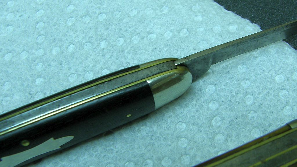

Charlie, the 5-blade cattle knife is now in the Nat. Knife Museum so I won't be able to get any more pix of that...BUT...I have others that I just shot. Clearly the knives with overbite ;) are going to work just fine. They're just not finished in the way the majority of knives were finished back in the day and just look odd to me.

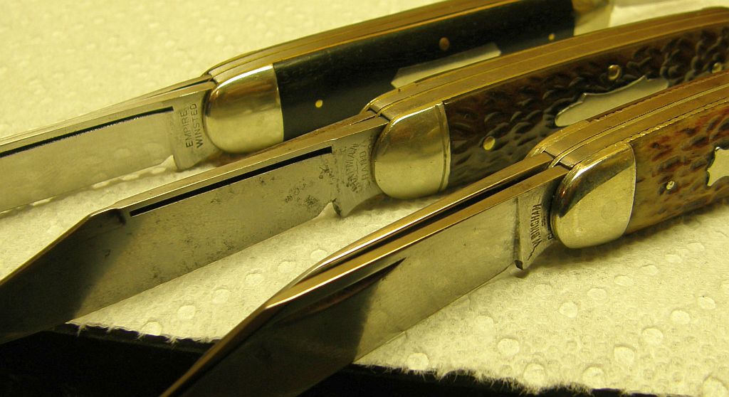

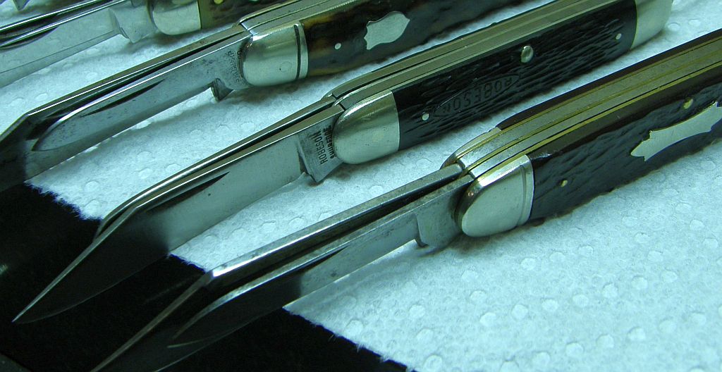

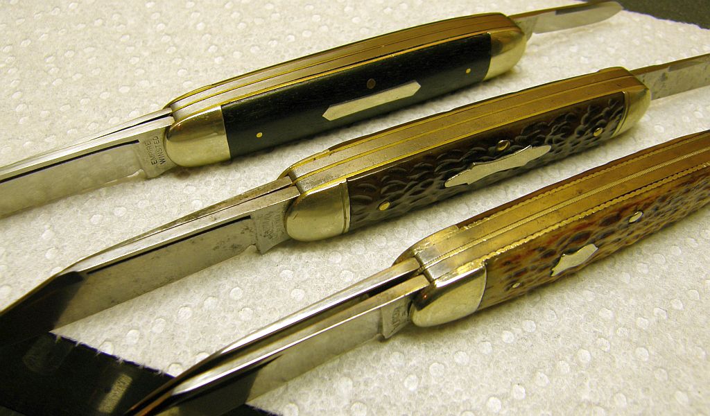

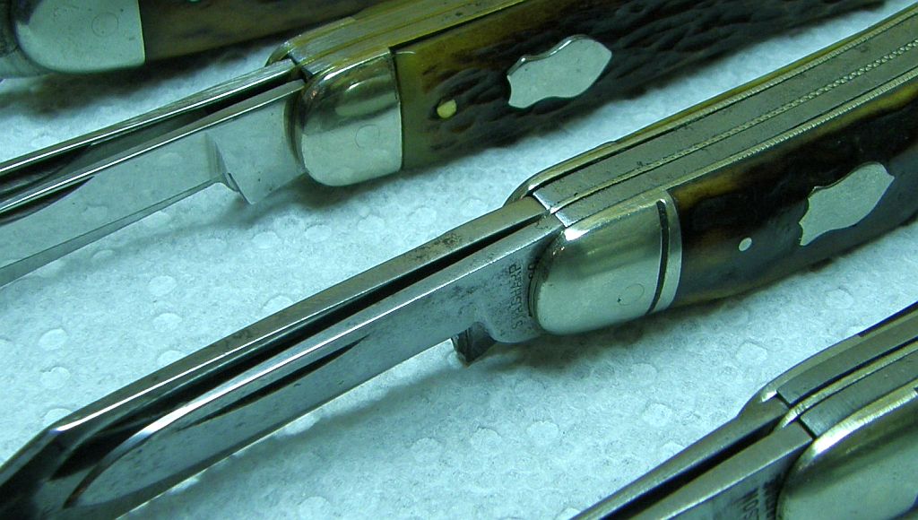

Sorry my other images were too lame to show what I was talking about. Here is a few that I "cherry-picked" from Tony's boxes of goodies. You can see some of the makers marks and figure out that these are old ones. Some are cattle knives and some jacks. Generally speaking, the springs aren't exactly meeting the run up but are usually just a skoshe above the blade.
The dogleg jack has a pen blade that sits lower on the spring. Not all the old knives were perfect, OBVIOUSLY. I saw a few others that were similar but I looked at a lot and this is definitely not the norm.

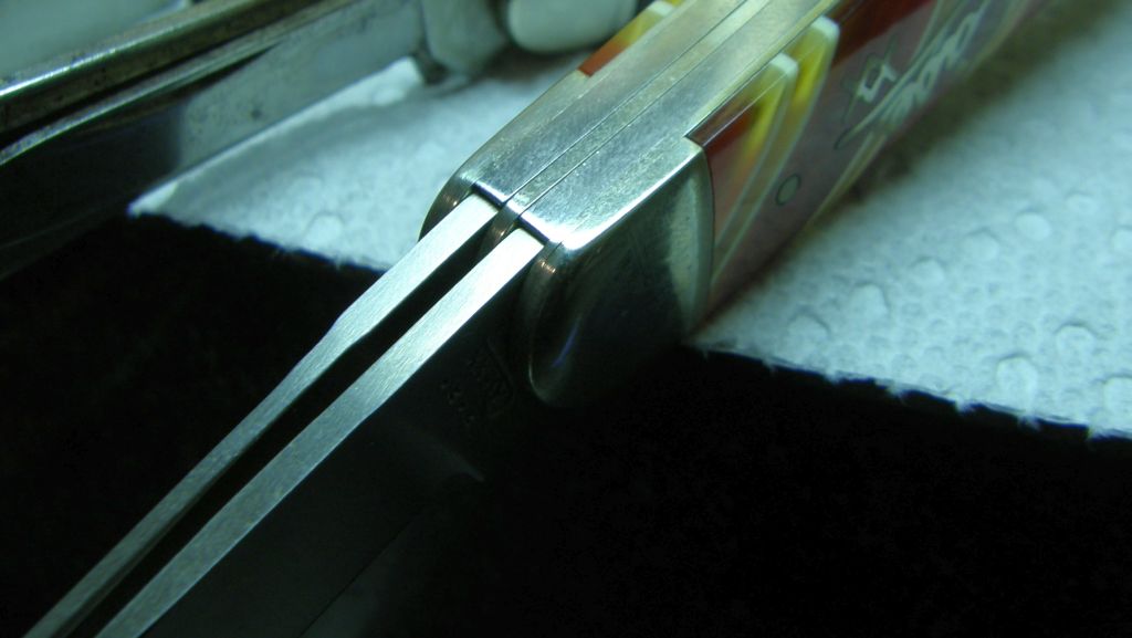

I threw in the 2001 Case Sowbelly for giggles. :D Tony said that when Case was making this knife, they paid special attention to how much space of the spring was showing above the blade. All three blades/spring levels are the same.
I guess the point is that these show that it is possible to get them closer. I think these show they way a knife should be finished.
So Kerry, if the spring ends were "rolled/trimmed" or "rounded" down to meet the blade, it seems a more acceptable appearance could be met. Do you agree? Like that last knife with the Candystripe handles.

Now let's pick on that Robeson in the third picture; look at that backspring sitting proud.... ;)

Yes, I can see now how the knife on the right is just as acceptable as the Robeson on the left. :confused:
I know which one I'd keep and which one I wouldn't look twice at.

Heres a 3 1/2" Henry Sears dogleg, same pattern as the GEC. Looking at the knife in profile, the master blade is centered vertically on the bolster, which flows nicely into the blade on top and bottom. If the spring were set back a bit and cut off straight as in the GEC example, and not contoured into the shape of the bolster, in order to be flush with the spring the run-up would have to be higher and longer, extending above the line of the bolster and losing the aesthetics of the knife. So, the spring is made a bit longer and contoured to meet the blade. You can see how its done pretty clearly in the side by side in the above post.
